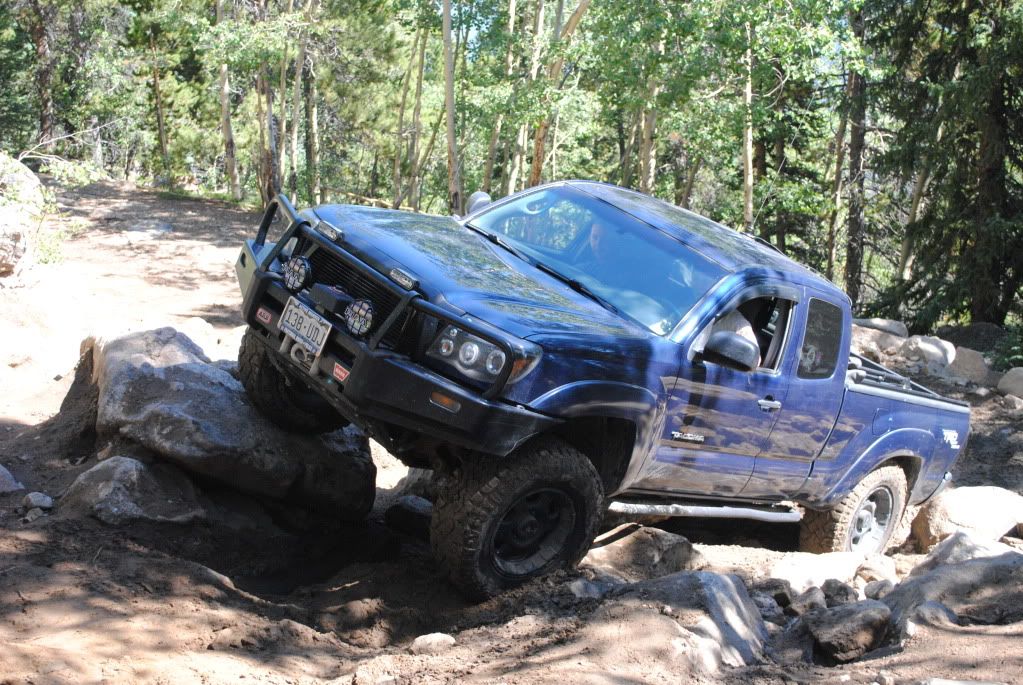

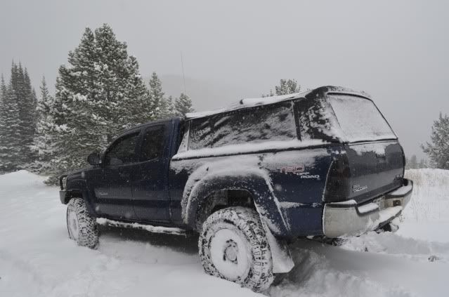

WHEELIN' PICS
having fun in the mud
Area BFE
Snow bashing @ Bill Moore Lake
cliffhanger, utah
wheeler lake, colorado
holy cross, colorado
spring creek, colorado
old chinaman gulch
Mt. Princeton
gulches
sevenmile rim trail
gemini bridges
non-trail specific
