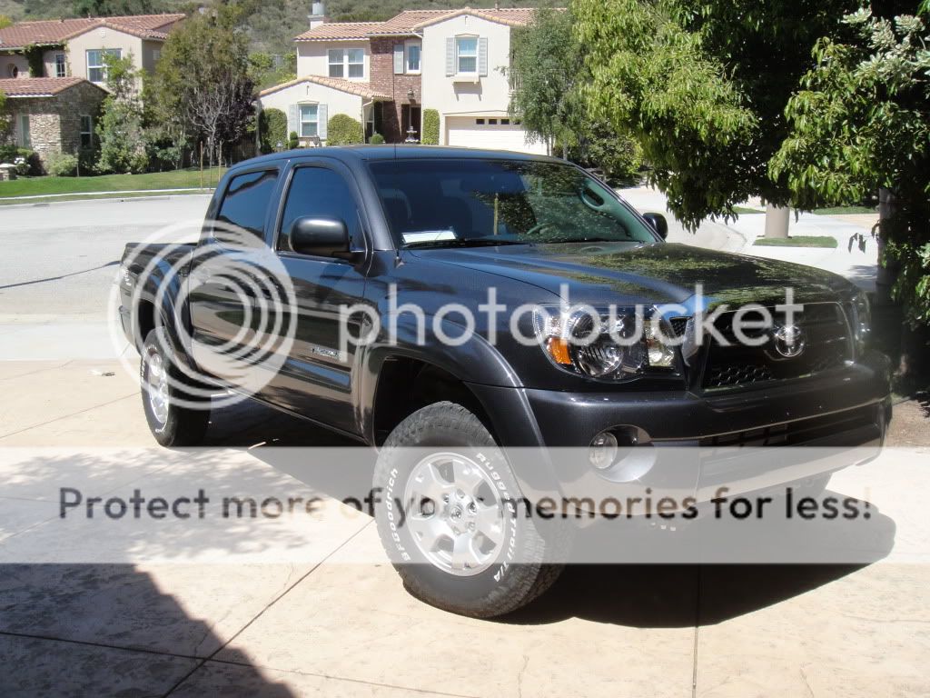

**Bfoster133's Build**
2011 4.0 Auto Toyota Tacoma TRD OR
spring perches
ride height
waiting on bedcage custom bumps and shocks
AND the LT build begins
Fox 16" RR smoothies
engage 50t pack
as she sits now

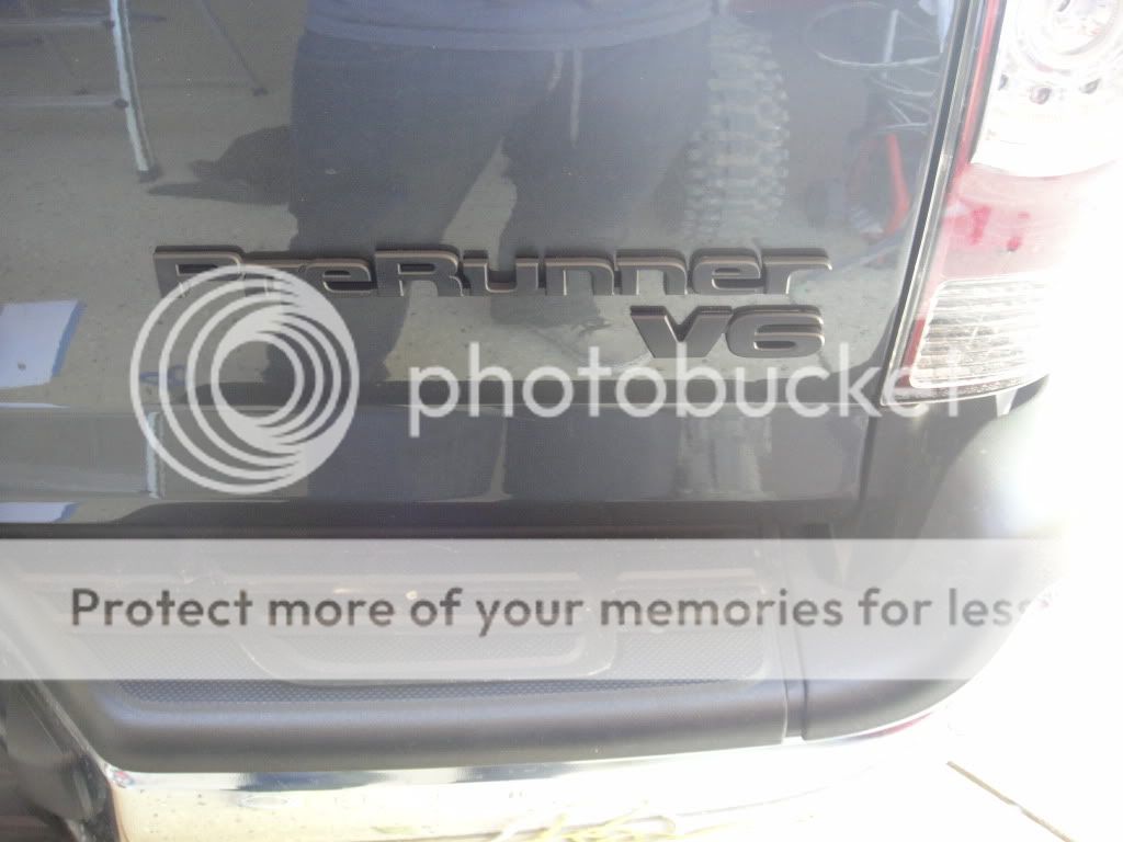

Took off my logos to paint flat black, pretty quick and easy mod- no plasti-derp here

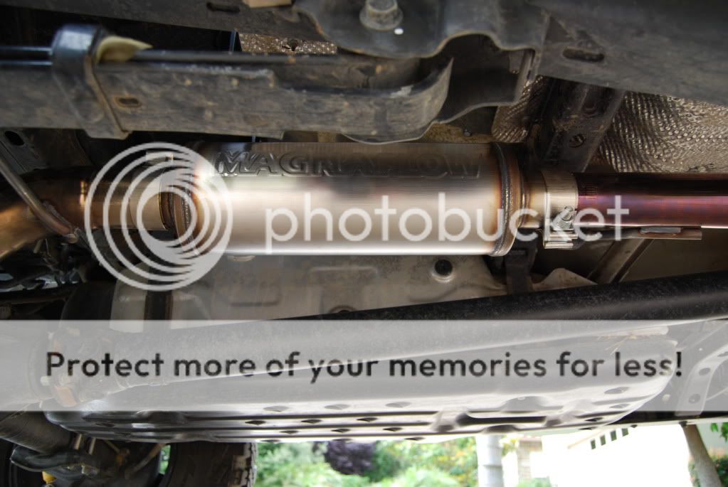

Cat-back exhaust magnaflow offroad pro

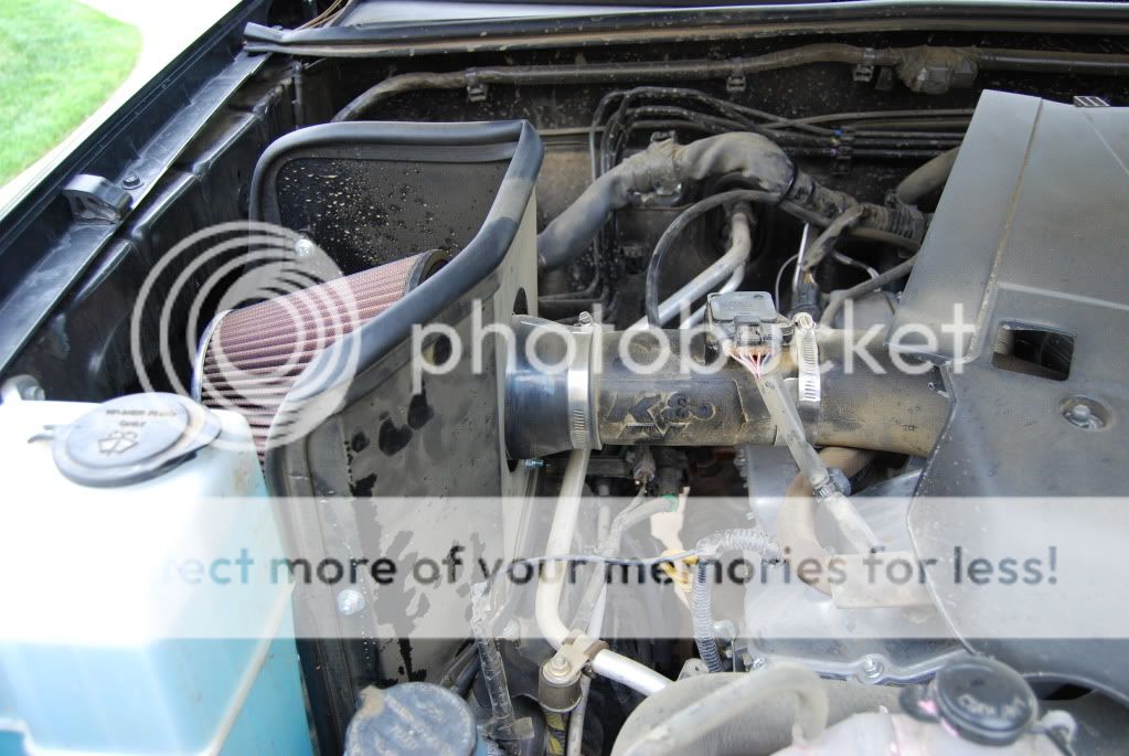

K&N

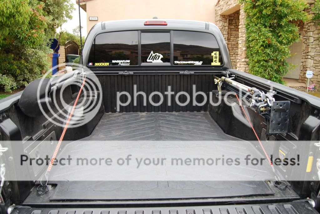

mounted hi-lift and shovel

Any tips on the black badges? What kind of paint did you use? That's gonna be one of my next mods I think...

thanks i used fishing line to saw off the emblems and i used krylon flat black to paint them and hairdryer to put them back on

okay so i debadged mine and i cant get the glue off the door.. howd you manage to remove yours?

i didnt, i left it on and used a hairdryer to re stick the badge on it, but if you still want it gone use brake cleaner and for the small residue use an eraser
Alright thanks! Did you have to rough up the chrome or anything to get the paint to stick? And no problems with reusing the same adhesive?

no problems and nope probably shouldve though i was in a rush, no chiping yet!

I used "goo-gone" to take the residue off after i took my badges off, it works great.
