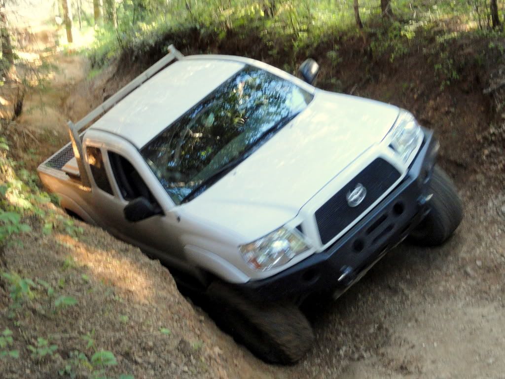

Cool RelentlessTaco's build up
Last update: 3/12/11
Most current pics:
http://youtu.be/Z4s1U6DuogQ?hd=1
Update 3/12/2011:
3/10/11: Working on adding HC rear bumper:
Siped KM2's
Current mods list:
Lift:
Front: OME front struts and 885 coil springs with a custom top spacer. 3.25" lift total. Light Racing UCAs. Sway bar removed.
Rear: TSB leaf pack with Wheelers offroad Tundra AAL(1.75" lift), 1.5" block and All-Pro U-bolt flip, Bilstein 5100 shocks with Toytec extenders.
Exterior:
Wheels 'n' tires: Siped 35x12.50x17 BFG KM2 mud terrains on 17x9 Moto Metal 951B's (-12mm offset and 4.5" BS)
Bed: Toyota factory diamond plate tool box, Toyota rubber bed mat, 4ft Hi-lift jack, Custom built(me): Bedlinered Diamond plate aluminum headache rack and tailgate reinforcement cover
Body: Custom built(me) Relentless Fab plate style winch bumper w/ center tube, recessed 4" driving lights, and 100W upgraded Hella 700ff's on top, Relentless Fab High Clearance rear plate bumper w/ hitch(and hidden winch soon), Relentless Fab 2" round tube/2x3square tube-hybrid rock sliders, Blacked out billet aluminum grille with billet aluminum devil horns Toyota emblem from Andres, duplicolor color-matched grille surround, Professionally color matched T-rex 1 eyelids, Sockmonkey's custom designed TRD 'All Terrain' mountain bedside decals, tinted-to-match front windows(25%), clearanced and painted factory flares for 2" extra tire clearance all around, blacked out headlights with TL projector retro w/ BMW shrouds and DDM Tuning 55W 5000K D2S HIDs.
Interior:
Miscellaneous: WeatherTech digi-fit floor liners in front and Toyota All Weather mats in rear, PRS modded gauge cluster w/ blue background and red needles, Blue LED dome light, 2- 3D cell LED maglights mounted to front seats
Stereo:
Alpine CDA 9886 head unit with iPod and USB hookups, Alpine SPS-609 front speakers with Tacotunes adapters, Alpine SPS-600 rear speakers, Alpine R-type 10" sub in custom sub box I built.
Performance mods and drivetrain:
Modified JBA cat back exhaust(no tube past muffler), polished cold air intake w/ 6" AEM DryFlo synthetic air filter, URD short throw shifter kit.
Off road recovery stuff:
8000lb winch and synthetic rope for rear on its way(3/8/11) still need to buy 2nd winch for the front, 2 tow/recovery straps, 48" hi-lift jack, 4- 3/4" D-shackles, 9 ton snatch block.
Other stuff:
Front body mount chop mod, Fog Lights anytime mod, Hella 700FF upgraded w/ Vision-X 100W offroad bulbs, rear diff breather extension mod, Scangauge II, painted engine cover mod, misc. stickers.
MUCH MORE TO COME!!!!
Mods in progress:
-4.10 gears (need to save for an ARB locker for the front to fit them)
-Relentless Fab'ed cut-bedside HC wrap around rear bumper
-Skids
Future mod list:
-Wet Okole seat covers
-Redline hood lift struts
-Front and rear winches
-On board air system
-Underbody Rock lights
-Long travel?
-URD Supercharger?!!

what is the story behind your bumper... only one i've seen like it, looks homemade
definately makes your truck look very angry

Yep, built the bumper myself. I'll be able to do a few finishing touches to it in about a month or so in a fabrication class at my college, and then finally paint it up. It should look pretty sick when its finally all done. Stay tuned.
Here's a Photoshop'ed preview to what it will look more like when painted:

By ripping that stock crap off!
Well, really, just strip it to the frame, have an idea of what you want it to look like and how it needs to function, then start cutting and welding. Really thats about it. It just takes a bit of welding and fabrication skill, the tools to do it, and the ability to visualize things like this.
