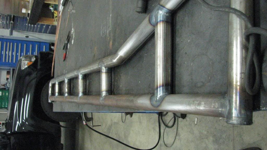

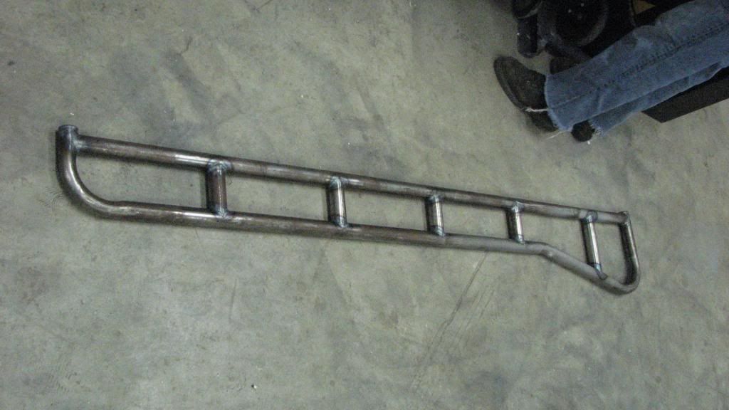

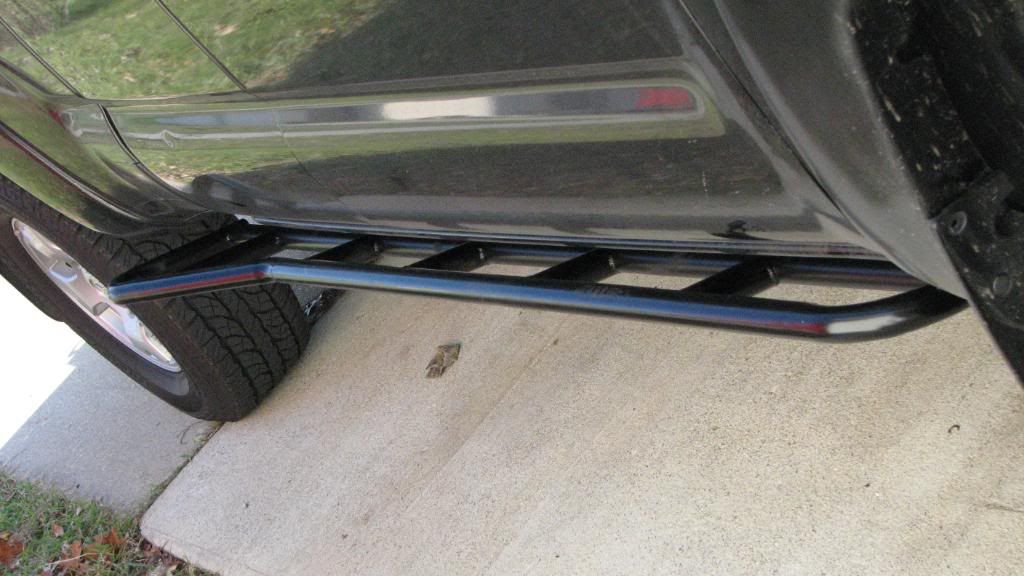

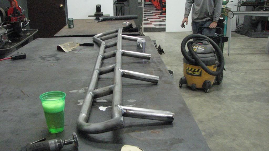

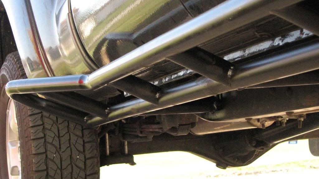

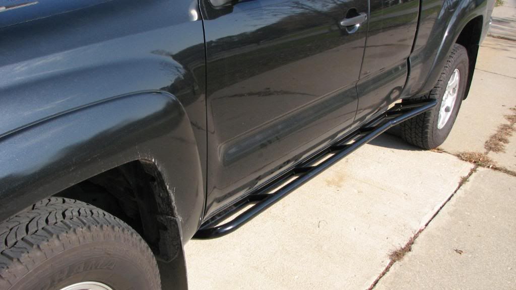

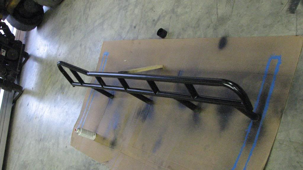

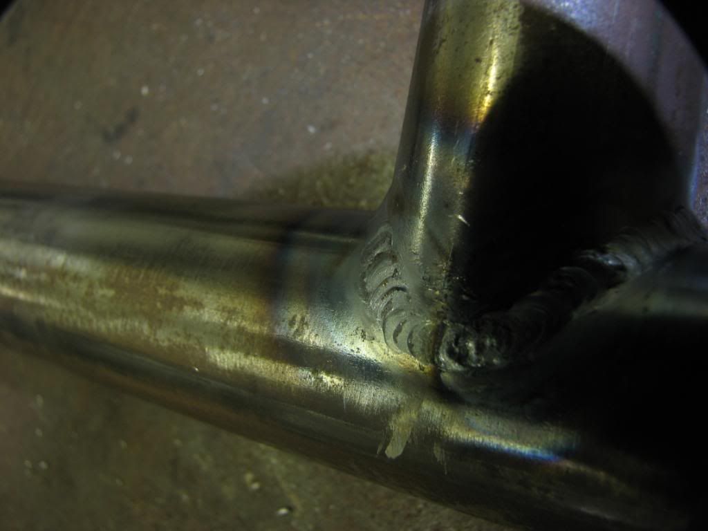

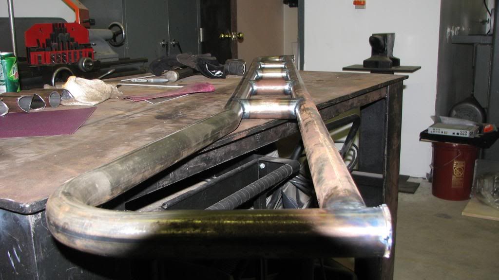

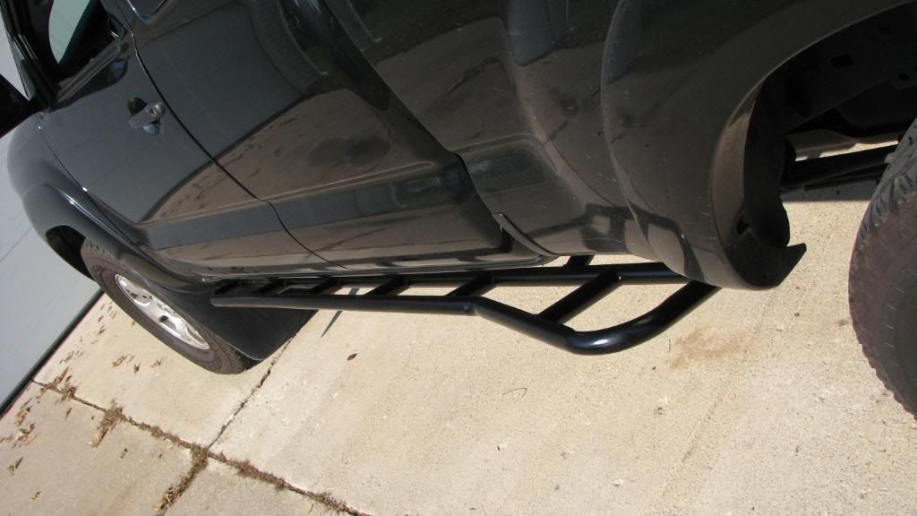

MAde these this weekend i used 1.5" (.104) wall Hrew tube
Totasl cost was $92.55( raw material and paint) I did a majority of the labor(bending, coping saw etc.) with the help of a VERY skilled friend (welding), Rustolem paint, and raw material purchase. let me know what you guys think.These are welded on

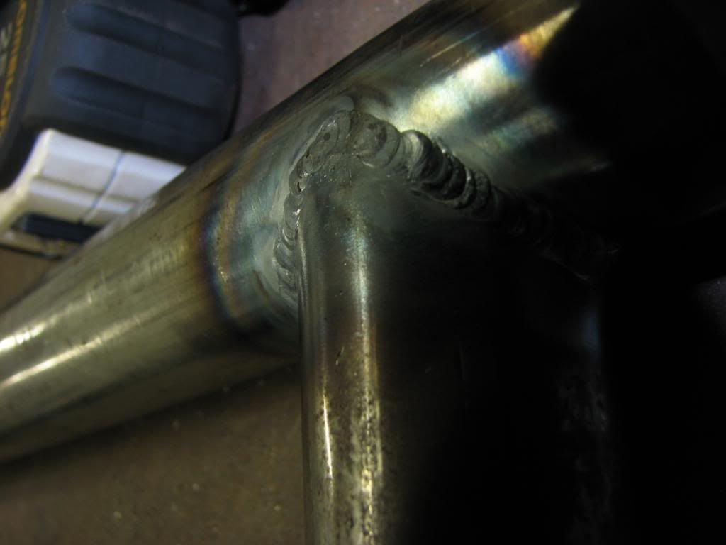

Nice welds!!!! I like the cup of beer!!!!!! YOU CAN MAKE ME A SET FOR CRISTMAS!!!!!

i would suggest creating a jig if you are going to make many more. even if it is a set of nails in plywood to hold all the pieces

ooo hell yeah definitely have to make a jig! Thanks!

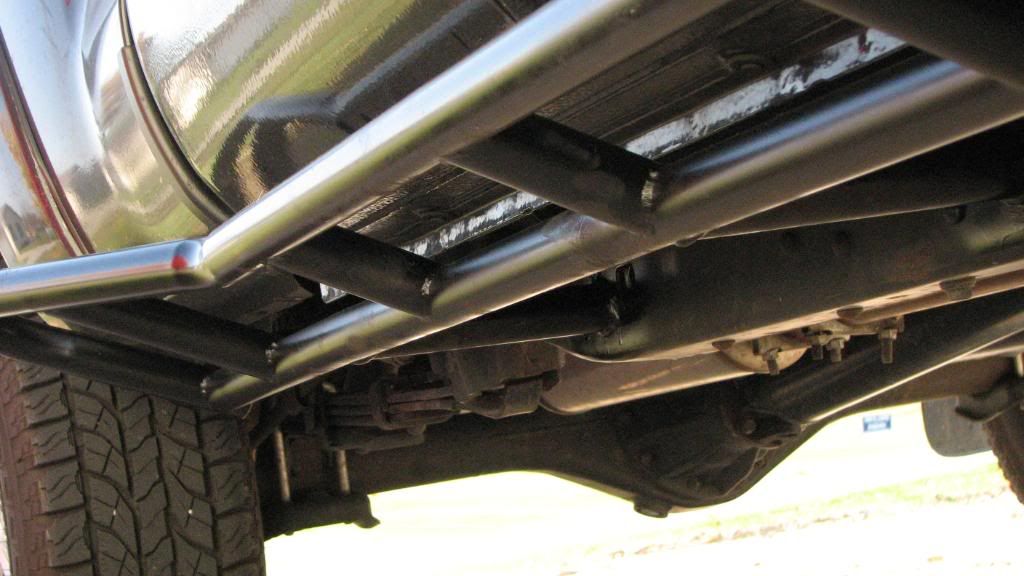

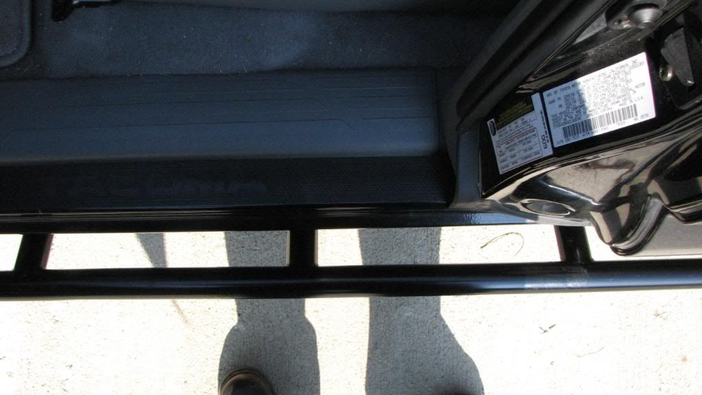

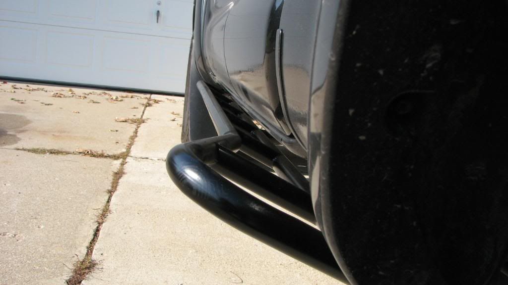

looking good. It looks like the extend out beyond the truck doors, or is that the angle? I like the door ding prevention of my side steps.
