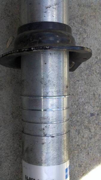

Sunday 4/1/12: Threw on the OME 885x's. Lifted her up and took off the wheels
Then took off the struts and took off the stock coils and moved it to sit at 0"
Threw the coils on and compressed them down. Then threw the hole assembly back on
Got 2.5" out of the 885x's with the bils set at 0". No problems with alignment with the stock UCA's.

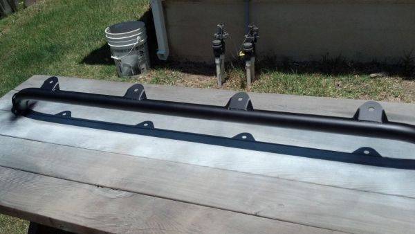

7/20/12 - Picked up my Pelfreybilt IFS skid plate this morning and got busy priming and painting
I put another coat on and did a couple coats of rubberized Rustoleum on top and then installed it.
