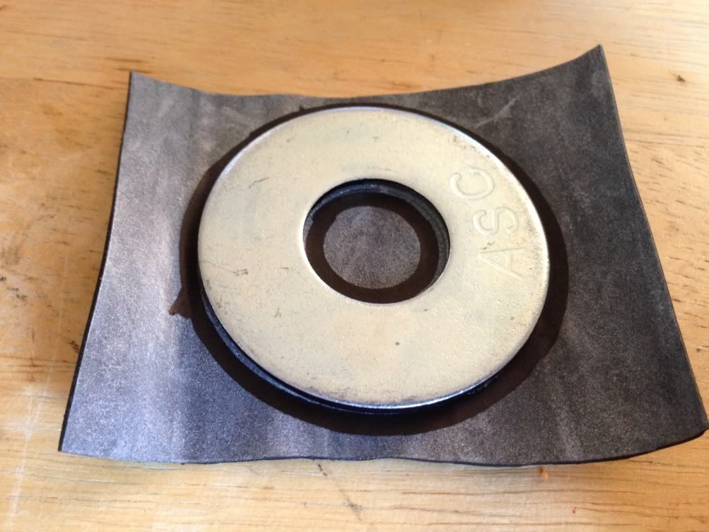

home made butcher of kings remote resi mounts
i still have use of the hand held remote for using outside the truck

so i installed my oba system today or at least part of it
viair 450c 100% duty cycle and tank....
had to relocated my winch solenoid as it was in the spot i wanted the compressor
i tacked a nut to side of fender this way i had 3 mounting locations for compressor and also has a bracket under it......
i also mounted and wired the pressure switch / relay......
here are some pics
i still have to mount the tank.....
got it almost done but ran out of washers / energy and light......
still waiting or air lines and fittings to arrive next week.....so no rush....
update tank is mounted.....
was a bitch to try and use the mounts on tank so i used some 5/16 threaded rod and used some poly tubing over the rod as not to scrtach tank
so much easier this way..and i was able to keep the nuts and washers on the low ridge of truck bed this way...
still waiting on freaking tubing i ordered about 10 days ago...errrrrrr
