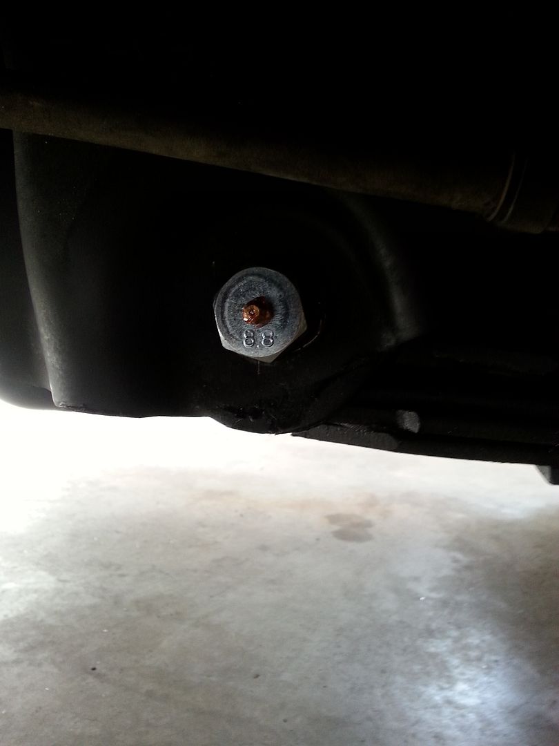

In the beginning when I installed the Freelance Fabrication Shackle Flip kit on my truck the design was taking quite a bit flak from some members on here and I was told that I would be tearing up my factory rubber bushing in my factory shackle hangers requiring replacement in the near future.
The below picture is of my factory shackle that was removed today in favor of a greasable extended shackle. This bushing has 50k miles on it with the factory hangers and another 20k on it installed with the flip kit. All 4 bushings looked just like this. They are ready for another 100k easily. So this proves, at least to me, that the design will not eat rubber bushings like some said.
