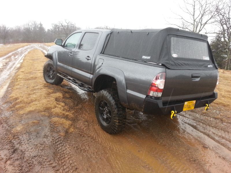

Here's my build... Specs below pictures
Recent:
Rotopax 4 gallon on the forward bed rail.
Tossed a ship in the bed. Fit well with RTT.
Cold beer whenever I want. I hardwired it to run off one of the SPOD switches not being used. Very stoked.
Pelfreybilt HiLift and Shovel/Axe mounts installed. Worked out great and all the cubbies open and the power outlet are accessible with the 60" jack.
Installed the 2 Plano Cases on the Prinsu.
Mmmmmmm Fridge...
Finally got a chance to flex her out...Need to work on the bumpstops...FML Timbrens are expensive!
Got the winch all back together and spooled up. Loving my new black fairlead thanks to Steve down at Southeast Overland for that and the new chaffing guard.
Added the side hoops to my Pelfreybilt bumper. I love how it looks now. The center only had been bothering me for a long while. Also added a set of 3x3 18w Pods. Fuckers are brighter than my headlights...good thing I did them in amber instead of white.
Installed the Pelfreybilt Gas Tank Skid after welding in some bolts for it. Looked so nice I thought I should put an extra sticker on it.
Overhauled the XRC8...I couldn't free spool it and the solenoid was totally corroded to the point of not working at all!
Backup Cam relocated...works great.
Ditch lights on. CB going somewhere else.
Finally installed the flyzeye...I'm lazy.
Tablet all mounted up and I dig this setup a lot.
Swingout is painted and installed ...jerry cans to come soon
Building the new swingout...bit more to do but coming along nicely!
Pelfreybilt Battery Tray and Group 31 Battery in.
SOS Bedrack installed and the RTT is back on.
Prinsu on with the 50" getting some buffeting so I'm working on what angle is best. The light bars should be illegal...ohh wait they are.
Driverside all done...
Front end mocked up...gonna be awesome!
12" King Smoothies on BAMF mounts are in...painted everything up nice and black too while I had it apart.
Shoulda done this before they bent! Ohhh well.
60" Hi Lift Extreme mounted. That is a big ass jack!
New HiLift Mounts courtesy of Brent. Just enough room for it to mount there. Glad I measured twice.
Nice shot...
35s are on!!!
All trimmed and ready for the 35s tomorrow. Fuck me running.
Tepui RTT installed.
OEM Roof Rack installed courtesy of my wife for Xmas!
Spidertrax on for the 315 install. Tomorrow fenders and cab mount. Fun...
Bed bars painted and on the truck. Just need an RTT now!
Airflow snorkel...
New FJ Trail Teams Rims...
BAMF LCA Skids installed...
She got a new ASS today!
700# King Springs are in and I love them. Except for the fact they're blue..
Ready for install! Just need to get some sheet metal out of the way!
Happy Birthday to myself!
New rear setup with Billys, RE shackles and longer bump stops...
Post alignment and coil over crank up...ended up with a tick over 3"s of front lift. Will let it settle a little then readjust from there.
ALL POO UCAs installed with new braided lines.
Shackles have been flipped! Fuck doing that twice!
Spotted while on my way home
Got the new camper shell back from painting...love it.
Installed an all pro rear bumper and full set of skids. Then took everything out and beat on it...
Painted sliders, debadged, pin stripes removed, no more TRD bed sides and tossed in a set of LED fogs.
Sliders welded on by Backwoods Fab!
Installed the cb and yellow shackles.
Finally got a good pic of the new bumper.
Pelfrey front bumper installed!!!
Got the 255's installed. Look nice and my gas mileage is better than the 265s.
After Softopper install and pulled the 1"spacers for the 255 install.
After AAL and coilover crank down.
Day after I bought her:
2013 Double Cab Short Bed Sport 4x4 4.0 6 speed manual
Suspension:
Front:
King 2.5 Remote Res Ext. Travel Coilovers
700# King Springs
Icon Tubular UCA
Allpro Prototype Stock Length Uniball LCA
Total Chaos Spindle Gussets
Rear:
Allpro Expo Leaf Pack
BAMF Shock relocation
King 2.0 12" Pro Race Smoothies
Allpro U bolt flip
ATO Shackle flip
Rubicon Express XJ shackles
Welded Alignment Tabs... do it before they get bent flat!
Wheels/Tires:
FJ Trail Teams Black
SpiderTrax 1.25" Spacers all around
315/75R16 Goodyear MTR/K
Performance:
4.56 Nitro Gears
ARB Air Lockers Front and Rear
Borla cat back chopped off at axle
Airflow snorkel
Diehard Platinum 31M
Protection:
4X Innovations Sliders
Pelfreybilt Front Bumper
Brute Force Fab High Clearance Rear Bumper
IFS/TRANSMISSION/TRANSFER Custom Flat Skids
Exterior:
Custom Ditch Light Mounts
Vent visors
SOS Bed Rack
Tepui Kukenam RTT
PRINSU Roof Rack
Pelfreybilt Axe/shovel mounts
Pelfreybilt HiLift mounts
Interior:
Clazzio Leather Seats
Panavise Mount
Proclip Tab with 6" Ram Arm
Galaxy Tab
Cobra 75 CB
Flyzeye Light
Misc:
SPOD Electical Managment
ARB 50 Fridge and Slider
Sidetracked Offroad 50" LED Light Bar
LED Pods all over the place
Smittybilt XRC8
Southeast Overland Black Fairlead
Masterpull Thimble
Onboard CO2 setup
Arb Tire Deflator
60" Hi lift Jack Extreme
Straps and shit
What Next?!?!?!...

Picked up a very lightly used black softopper last night. Will snap some daylight photos tomorrow if the weather complies. Very cool little top thats for sure.
