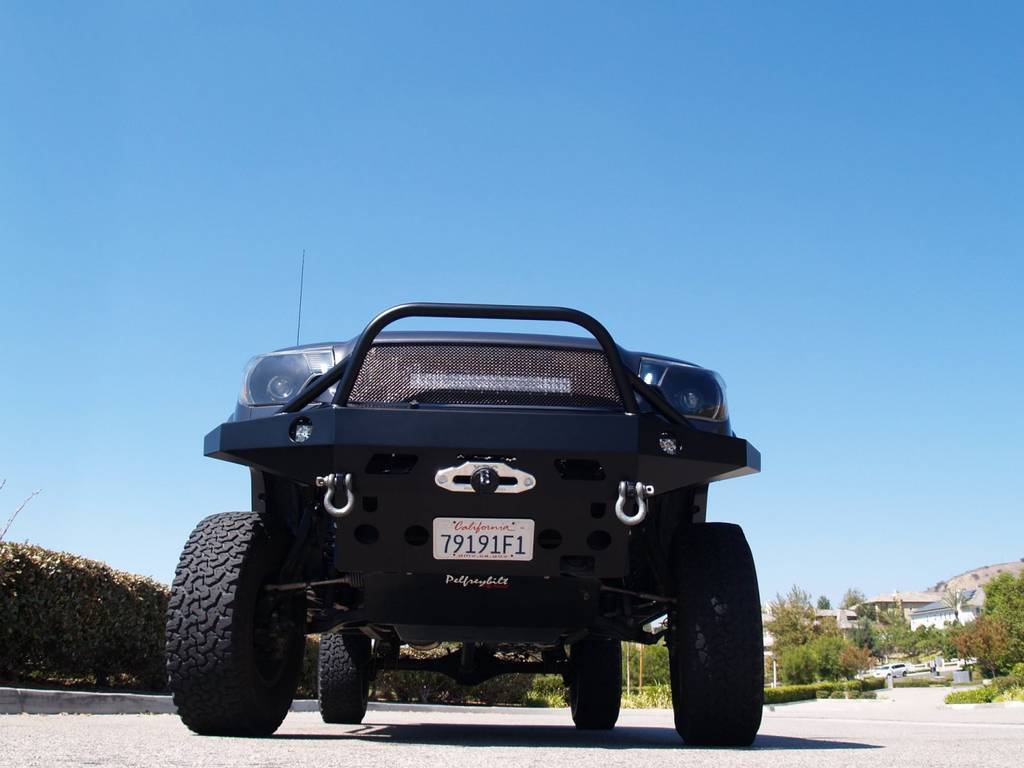

Airdog's 2012 Prerunner Access Cab (slow) Build
This is how she sits as of 04-28-14:
Mods as of 4-8-2014
Suspension
Icon 2.5 Extended Remote Resi Coilover's
King 2.5 2 Tube Remote Resi Bypasses
Icon Tubular Upper Control Arms
Total Chaos Stock Length Lower Control Arms
Total Chaos Dual Shock Hoops
Kartek 10 Inch Limit Straps
Maxtrac Spindles 4 inch lift
Icon 2.0 Rear Resi's
OME Dakar Leafs with D29XL leaf
AllPro U-Bolt Flip Kit
Extended Brakelines
Total Chaos Cam Tab Gussets
Total Chaos Coil Bucket Gussets
Exterior
E&G Grill
Trailer Products Fibergalss fenders 3 inch flair 2 inch rise
BHLM
TRS Bi-xenon Morimoto Mini Stage III Kit (D2S)with Halo's
CsJumper LED's- DRL switchbacks, parking lights, Tag Lights, Reverse Lights 55w, Dome and maplights
ProComp Wheel Series 7089
Hankook Dynapro's 315/75-16
Rigid Industries 20" LED lightbar
Rigid Industries Dually's 20* Spot Pattern
Trailer Harness Relocated to Rear Bumper (Standard with the Pelfreybilt HC Bumper)
BAMF Behind the Grill Lightbar bracket
Relentless Bed CrossBars
Garvin Wilderness Rack
Fog Light anytime Mod
Redline Tuning QuickLIFT ELITE Hood Gas Shocks
Rear Diff Breather Mod
Cab Mount Chop
Interior
Sony MEX-GS600BT Head Unit (Hidden)
In-Dash Apple iPad Mini (Controls Head Unit and Navigation)
Alpine MRX-F65 Amp
Alpine SWS-10D4 Sub
Image Dynamics CTX65cs component speakers
Dual Universal Bluetooth GPS Receiver
Yaesu FT-60R 2M/440 with MARS Cap mod
Armor
Pelfreybilt IFS Skid
Pelfreybilt Mid Skid
Pelfreybilt Front Plate Bumper
Pelfreybilt Rear Hi-Clearance bumper
AllPro Heavy Duty Rock Sliders
12-25-12

2-26-2013
Put on some bilstein 5100's@1.75 to level it out. Took about 2 hours by myself. I used the stock springs and swapped them to the new shocks using my floor jack on the LCA to unload the spring pressure. Super easy and felt safe the whole time. Purchased the shocks from Downsouth Motorsports. Ordered on Sunday night at my door Tuesday morning.
Pic of it all done:
3-22-13
Decided to do the Black Headlight Mod (BHLM) after I saw one up close the other day. Real happy with it. Next is going to be color matching the Grill surround.
3-30-13
Picked up a lift kit from Headstrong Offroad Highly recommend them for great prices and service!!
Painted the Maxtrac Spindles I picked up on Friday. Used 2 coats of Krylon primer...2 coats Krylon matte black then 2 coats of Krylon matte clear over where I polished up the MT logo. Hopefully this will mitigate any surface rust issues.
Installing the spindles, OME Dakar leaf packs, OME nitrocharger rear shocks and extended brake lines at all 4 corners on Monday. 33 inch tires shortly after that!

4-1-2013
Today I installed my Maxtrac Spindle and set the 5100's to .85. I also installed OME Dakar Leafs with nitrocharger shocks. I also put in extended brake lines at all 4 corners also. Install took about 8 hours working by myself except for bleeding the brakes. Gotta get some new rubber to fill in the wheel wells now.
4-2-13
Put on some BFG AT KO 285/75/16
4-16-2013
The money pit continues with a set of AllPro Sliders!
4-18-13
Getting my sliders welded on. Even though the sliders are bolt on I decided that I did not like that the front was mounted with self tapping screws and the single bolt for the rear. So off I went to Sick Nick Fab in Stanton CA and let him do his magic, he does excellent work and has great prices. I had him weld the front support and the rear support area. I also had a few stitch welds along the bottom of the plate that wraps around the bottom of the frame.
Nick at Work
5-11-13
Installed Relentless Fab crossbars with Hi-lift mounts and a Garvin Wilderness rack for my full size spare.
5-15-13
BAMF behind the grill Light bar
Fabricated up a Aux fuse panel plus support bracket. Will be adding relays to the panel when they show up and then wiring in the lights and room for future mods. I used a Blue Sea 6 circuit fuse panel and a 100 amp circuit breaker.
Red arrow below points to the support bracket
All wired up.
