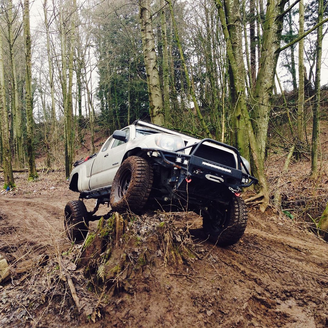

Vancity4x Prerunner to 4wd IFS to 1ton SAS Crawler Build
Rolling a 2005 Access cab TRD OR Prerunner converted to 4wd, built 14bolt rear and coming soon fromt solid axle swap
Here's how she currently sits,
Mods
Drivetrain:
1 Ton 14 bolt ff 6lug custom rear with arb and disk brakes
Prerunner to 4x4 swap
4.56 Yukon gears
ARB front/Rear locker
RST ADD engage harness
FJ Crusier Transfer case Front Range twin sticks
Spicer built driveshaft
Full breather Relocate
Intake Relocate
Kicks:
35 Goodyear MT/R
Procomp 98's
OR Snow Chains
Gorilla E/T lugs
1.25 Spidertracs Spacers
Cab mount chop
Trimmed fenders and flares
Armor:
Brute Force Fab Hybrid
Cruisin Offroad Rock Sliders
Allpro IFS/Mid Skid
Suspension:
Icon (LR) 2.5 Ext Travel Coilovers
Total Chaos UCA’s
TC Spindle Gussets
Super Bumps
Sway bar delete
Chevy 63's
14" Bilsteins custom mounts
Ruff stuff hanger, perches, ubolts
Balistic Frenched front hanger
1’’ 4crawler Body Lift
Offroad Recovery/Camping Gear
Engo 10k winch
Straps, Snatch, Shackles, misc recov gear
HiLift 60"
ARB CKMA12
Spare cv, hub, misc parts
Tepui RTT on custom rack
Trasharoo
Exterior:
HomerTaco Satoshi Grill
Custom rubber bed mat
Kobalt tool box –Line-x coated
Black badging
Flowmaster super 40 muffler
BC Pinstriping
Lighting
BHLM/DTRL
Tinted tail lights
Bed Light
Underhood LED Strip
9W Eagle eye Rock Lights x6
20" 5w Aurora LightBar
2" Flood Pods x4
Electrical
DieHard 31m in Pelfery cage
Blue sea fuse box w/ custom mount
Sunglass holder to switch panel
OTRATTW switches
Interior:
Wet Okole covers
Weather Techs
Suede arm rests/rear seats
Line X window plate, centre consel cover
Black painted centre console
Cluster/Int LED Swap
Mag light seat mount
Fat Mat Sound Deadnd
Scanguage
RAM IPAD mount
Audio/Coms:
Kenwood ddx370 Head
Alpine sps-600 series front/rear speakers
Alpine V60 5channel amp
JL 10'' sub w/custom box
Cobra 18 cb radio w/ 4' Firestick
2 Baofeng 5W VHF Radios
Gamin Glo w/ BC Backroad maps on Ipad
Todo
Tube Rear bumper
37 Mil MT/R on H1 beadlocks
  Reply With Quote
Old 07-06-2013, 10:33 PM   #2
VanCity4x [OP] VanCity4x is offline
Out fer a Rip eh Bud
VanCity4x is one of the sharper tools in the shedVanCity4x is one of the sharper tools in the shedVanCity4x is one of the sharper tools in the shedVanCity4x is one of the sharper tools in the shedVanCity4x is one of the sharper tools in the shedVanCity4x is one of the sharper tools in the shedVanCity4x is one of the sharper tools in the shedVanCity4x is one of the sharper tools in the shedVanCity4x is one of the sharper tools in the shedVanCity4x is one of the sharper tools in the shedVanCity4x is one of the sharper tools in the shed
VanCity4x's Avatar
Joined: Aug 2011, #60970
Location: BC
Gender: Male
Posts: 1,350
VanCity4x's Tacoma Gallery
Details of swap as outlined by the mastermind - http://www.rocksolidtoys.com/forum/showthread.php?t=396
So to make a conversion of a 2nd gen prerunner possible will need to find all the parts,
A750F 4x4 Transmission
VF2A FJ Crusier (Automatic) Transfer Case
Tacoma Front Diff w/ mounting hardware
CV axels
4x4 hubs/bearings
CV nut/seals
Front drive shaft
ADD Harness - replaces ecu
Custom tranny crossmember
Modified rear drive shaft
modified y-pipe exhaust
+large assortment of mounting bolts, seals and misc parts
The swap for me was around $3500 in parts not including the ARB or gears. If pieced together properly it can be done for cheaper. Most of my ability and knowledge came from a lot of research and the factory service manual which details all the parts on the truck.
Heres how I did the swap
New Tranny and TCase
First off I took out the tranny. The connectors, fluid lines, shifter leaver came off then took out the starter to access the TC to Flexplate bolts. Then unbolted the bellhousing from the engine to pull the tranny out.
Installed the new Transmission then cut the hole and sent my FJ Tcase home
Have Twinsticks used for selecting the drive, left of for high, neutral and low and right for 2wd and 4wd. This also lets me utilize 2low for certain situations.
The prerunner frame is different then the 4x4 so a custom crossmember is needed. The measurements were not the easiest to get. I used 1x3 steel tube, cut the ends off a 4x4 crossmember and welded them to the new. Then cut out the center section and added them mount.
The IFS stuff is pretty simple, front diff bolts to factory holes, no crawl box meant factory front drive shaft would fit. Gusseted the spindles, through in the cv's and hubs with seals. Wired up the ADD Harness, works great. Allows the front diff to function without the use of the ecu. Before switching into 4wd the switch gets turned on activating the front diff, then the tcase can be shifted into 4.
At the same time as the swap I had my front and rear diff regeared to 4.56 and front locker installed.
For the rear drive shaft instead of buying a 4x4 shaft I was able to get my prerunner shaft cut down and a yoke and slip joint added. Cut the cost down rather than buying a new shaft and having to change the carrier bearing position, they are different on 4x4 frames.
The last thing I got done was getting the exhaust relocated as It doesn't fit around the new tcase. You can see it in the bottom of the picture here, it is in the stock location now. I got it done by a shop. I will def be redoing it soon as it already has rock scars on it.
