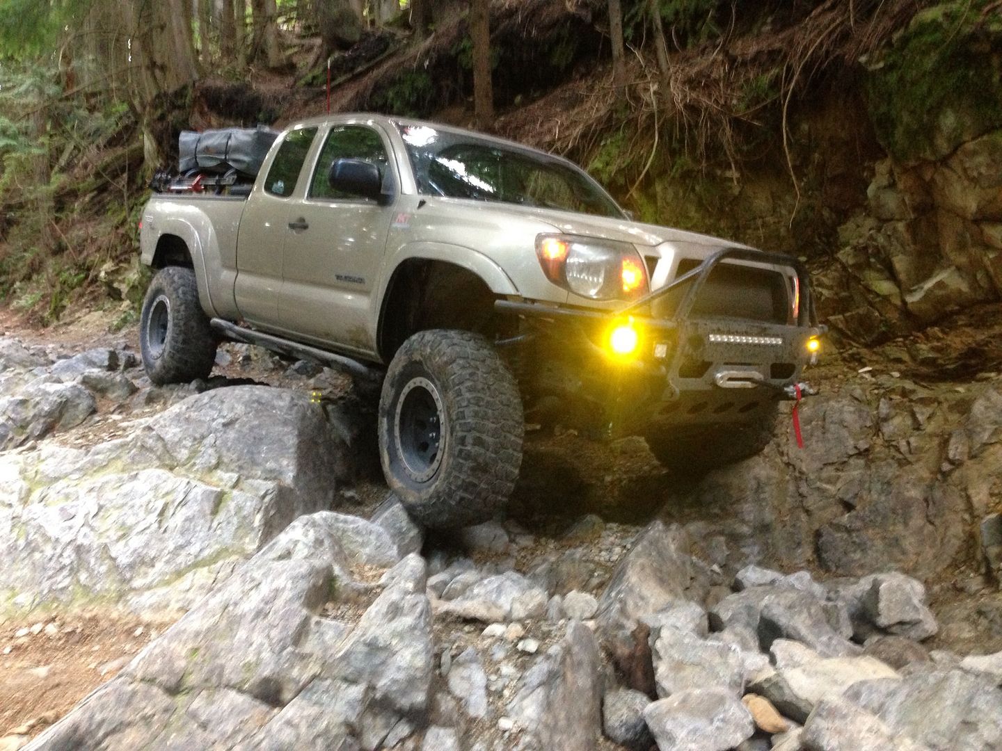

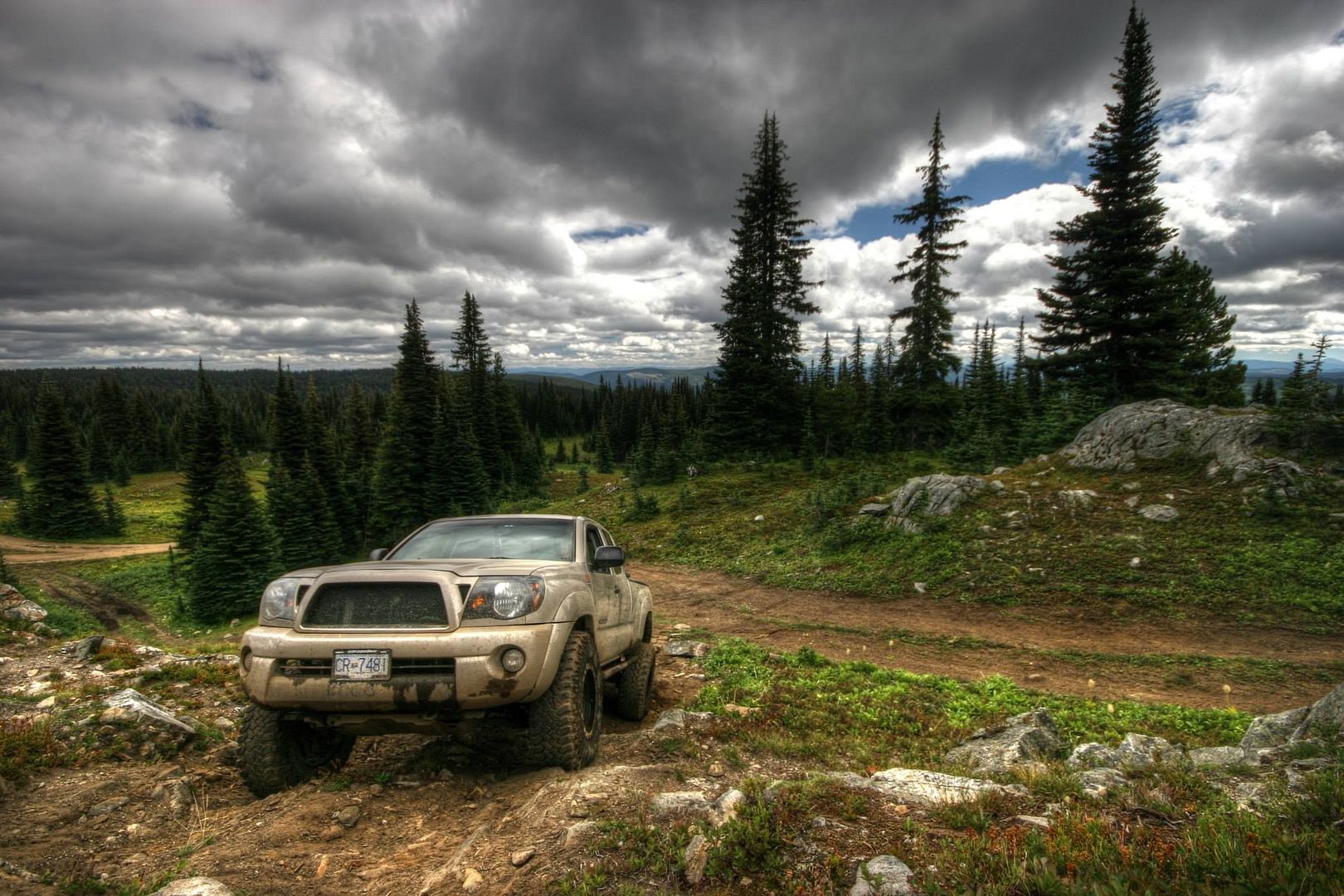

VanCity4x Prerunner Convert Build
Rolling a 2005 Access cab TRD OR Prerunner converted to 4wd
Here's how she currently sits,
Mods
Drivetrain:
Prerunner to 4x4 swap
4.56 Nitro gears
ARB front locker
8' Elocker rear
RST ADD engage harness
FJ Crusier Transfer case Front Range twin sticks
Spicer built driveshaft
Full breather Relocate
Triple drilled TC/R Diff flange
Intake Relocate
Kicks:
35 Goodyear MT/R
Procomp 98's
OR Snow Chains
Gorilla E/T lugs
1.25 Spidertracs Spacers
Cab mount chop
Trimmed fenders and flares
Armor:
Brute Force Fab Hybrid
Cruisin Offroad Rock Sliders
Allpro IFS/Mid Skid
Suspension:
Icon (LR) 2.5 Ext Travel Coilovers
Total Chaos UCA’s
TC Spindle Gussets
Super Bumps
Sway bar delete
ATO Shackle Flip
OMD Style leafs
U bolt Flip
Timbren bump stops
3* Axle Shims
1’’ 4crawler Body Lift
Offroad Recovery/Camping Gear
Engo 10k winch
Straps, Snatch, Shackles, misc recov gear
HiLift 60"
ARB CKMA12
Spare cv, hub, misc parts
Tepui RTT on custom rack
Trasharoo
Exterior:
HomerTaco Satoshi Grill
Custom rubber bed mat
Kobalt tool box –Line-x coated
Black badging
Flowmaster super 40 muffler
BC Pinstriping
Lighting
BHLM/DTRL
Tinted tail lights
Bed Light
Underhood LED Strip
9W Eagle eye Rock Lights x6
20" 5w Aurora LightBar
2" Flood Pods x4
Electrical
DieHard 31m in Pelfery cage
Blue sea fuse box w/ custom mount
Sunglass holder to switch panel
OTRATTW switches
Interior:
Wet Okole covers
Weather Techs
Suede arm rests/rear seats
Line X window plate, centre consel cover
Black painted centre console
Cluster/Int LED Swap
Mag light seat mount
Fat Mat Sound Deadnd
Scanguage
RAM IPAD mount
Audio/Coms:
Kenwood ddx370 Head
Alpine sps-600 series front/rear speakers
Alpine V60 5channel amp
JL 10'' sub w/custom box
Cobra 18 cb radio w/ 4' Firestick
2 Baofeng 5W VHF Radios
Gamin Glo w/ BC Backroad maps on Ipad
Todo
Tube Rear bumper
Rear shaved ff 14 bolt w/ disks
Chev 63's, Billstein 14's
37 Mil MT/R on H1 beadlocks

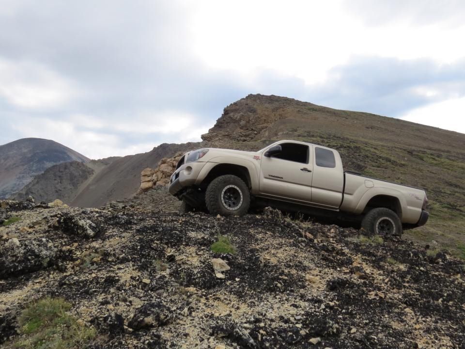

Molybdenite Peak - South of Lillooet BC. 9000 ft elevation, has snow 10 months a year.
