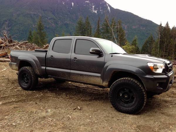

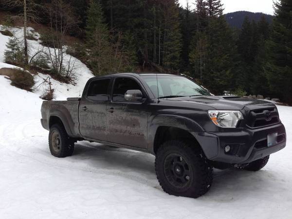

uncleART's Build
uncleART's 2013 MGM DCLB TRD Sport
As it sits today (1-27-2014)
The day I bought it on 5-13-2013
Bought with 6 miles on it and took this when I got home.

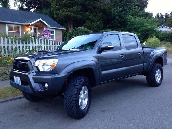

3" Lift. (Ultimate Lift Kit from Toytec Lifts)
Out with the old TRD Sport.
In with the new. Bilstein 5100/Toytec Coil, LR UCA, sway bar drop.
OME Dakar next to a stock spring. I didn't use the shims - no vibes.
Adjusting for Taco Lean.
Alignment went very well.
I set the LR ball joint at the -1.0 (E) setting for an overall UCA Caster adjustment of +1.0.
I rolled the lower cams to pitch the LCAs all the way forward.
Doing this along with the UCA adjustments gave me an additional 1" of clearance behind the tires.
Here's my final alignment results:
Camber.....left -0.1 right -0.1
Caster.......left 2.1 right 2.2
Toe...........left 0.07 right 0.03
I have no tire rub issues with my 285/70-17s, stock Sport wheels, with 1" spacers.

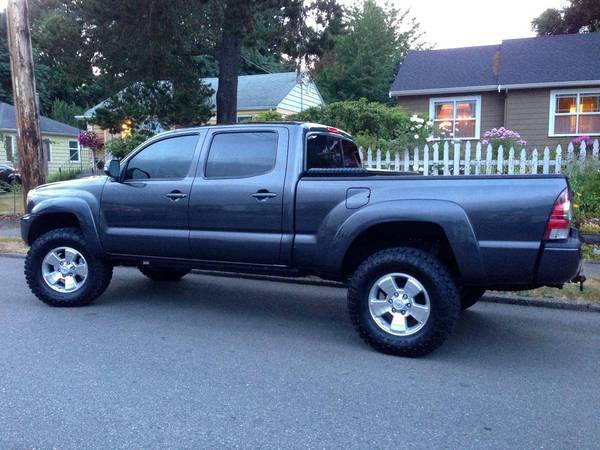

Bora 1" spacers installed. (Click Here for the Benson X review of these)
Before Bora.
After Bora.

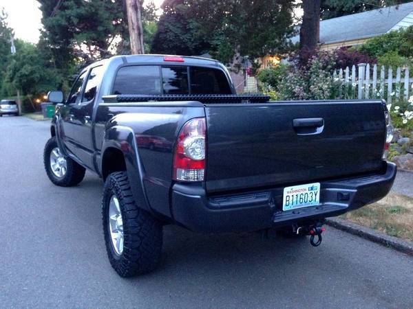

Installed a CBI Receiver Shackle, with a BOLT locking hitch pin.

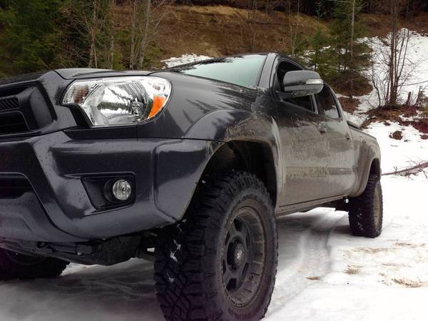

Finally got my Goodyear DuraTracs!
I drove around for about 3 weeks with the little shoes on.

No tire rub?
How were you able to avoid any rubbing issues with the 285s? New UCAs & proper allignment + spacers?

Hi Chase, Yes that all is correct. Going with the LR UCAs, allowed me to roll the upper ball joint forward; and shifting the LCAs forward all helped me gain clearance behind the wheel. The adjustable upper ball joint allowed for the crazy LCA adjustment - it helped get the camber back.
I went with around 2* of caster. It is still enough for the truck to comfortably track and is within factory spec. This was also about the limit due to the upper and lower ball joint positions. If I wanted more caster, I would have had to move my upper ball joint back - losing clearance behind the tire.
Keeping my stock wheels required the 1" spacer. This created the 4.5" backspacing that we need for wider tires. The fact that I stayed with the stockers & went with the 1" spacers kept the steering radius to a minimum. Had I gone with a 8" wide wheel with 4.5" of back spacing or less, I would be rubbing on the front of my wheel well just a little. This wouldn't be a big deal though. Plastic is easy to trim compared to cab mount chops and bending over pinch welds. The guys that go with 9" wide wheels quite often have more trimming to do because of the bigger steering radius.
