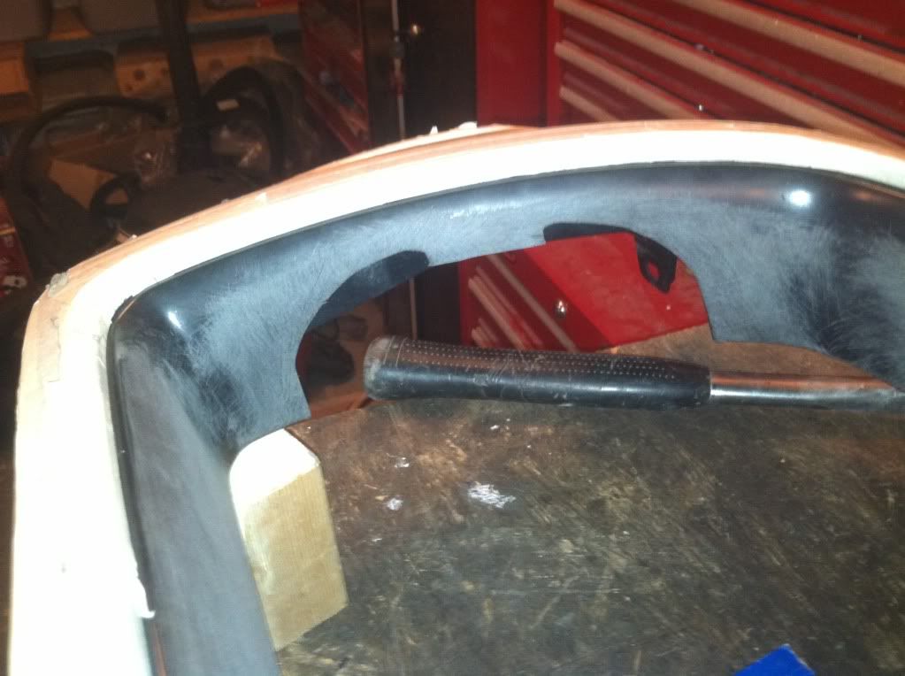

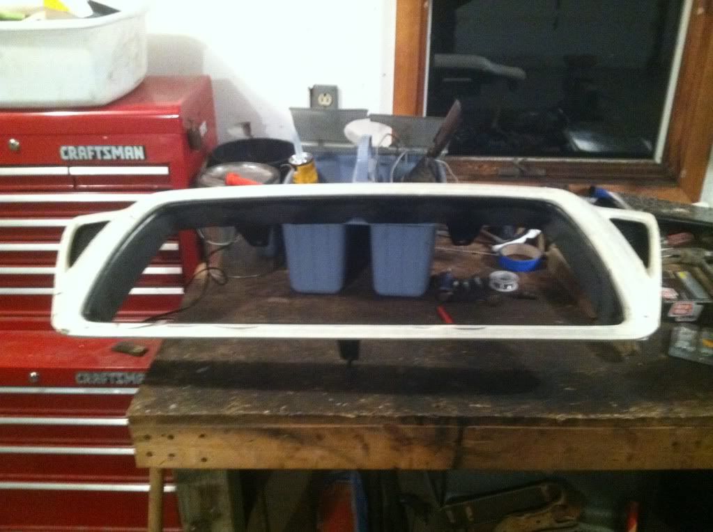

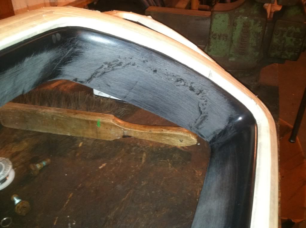

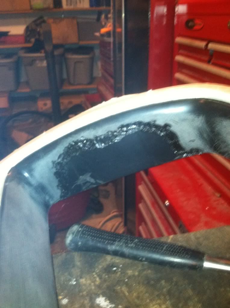

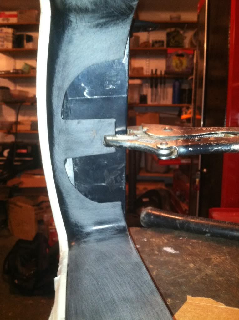

More updates for anyone watching -
After finishing knocking all the plastic down, I started on the filler pieces for the sides. I used pieces of the center grille section I cutout -

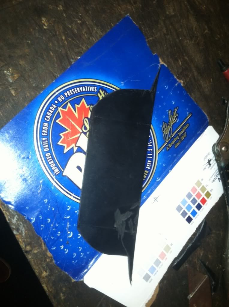

Mocked em up in place and traced them out -

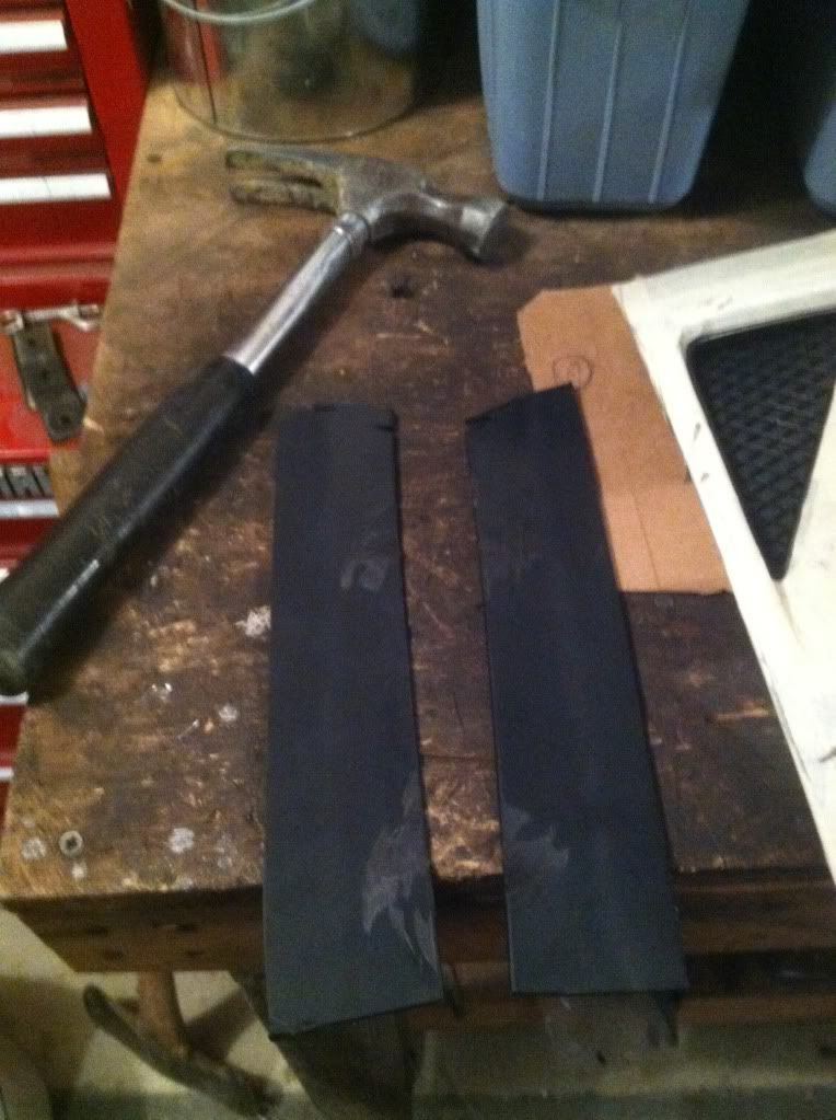

And cut the filler pieces out -
I did it a little different and cut the center piece out so it would fill better -

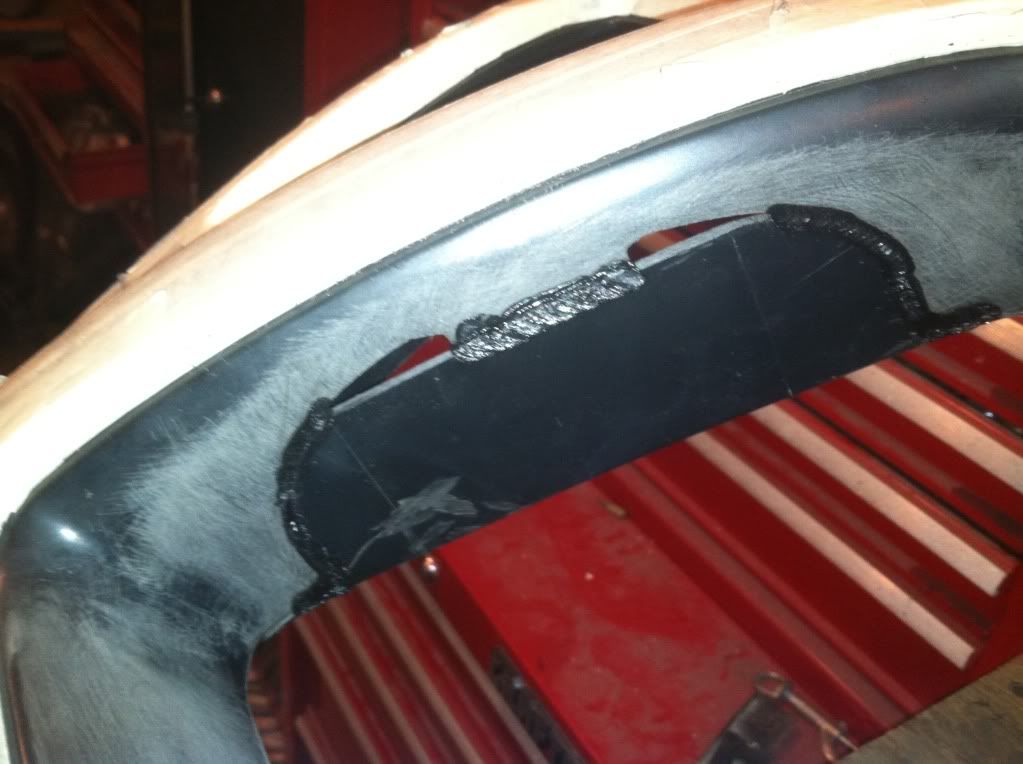

Then started plastic welding -
Finished all the plastic welding -

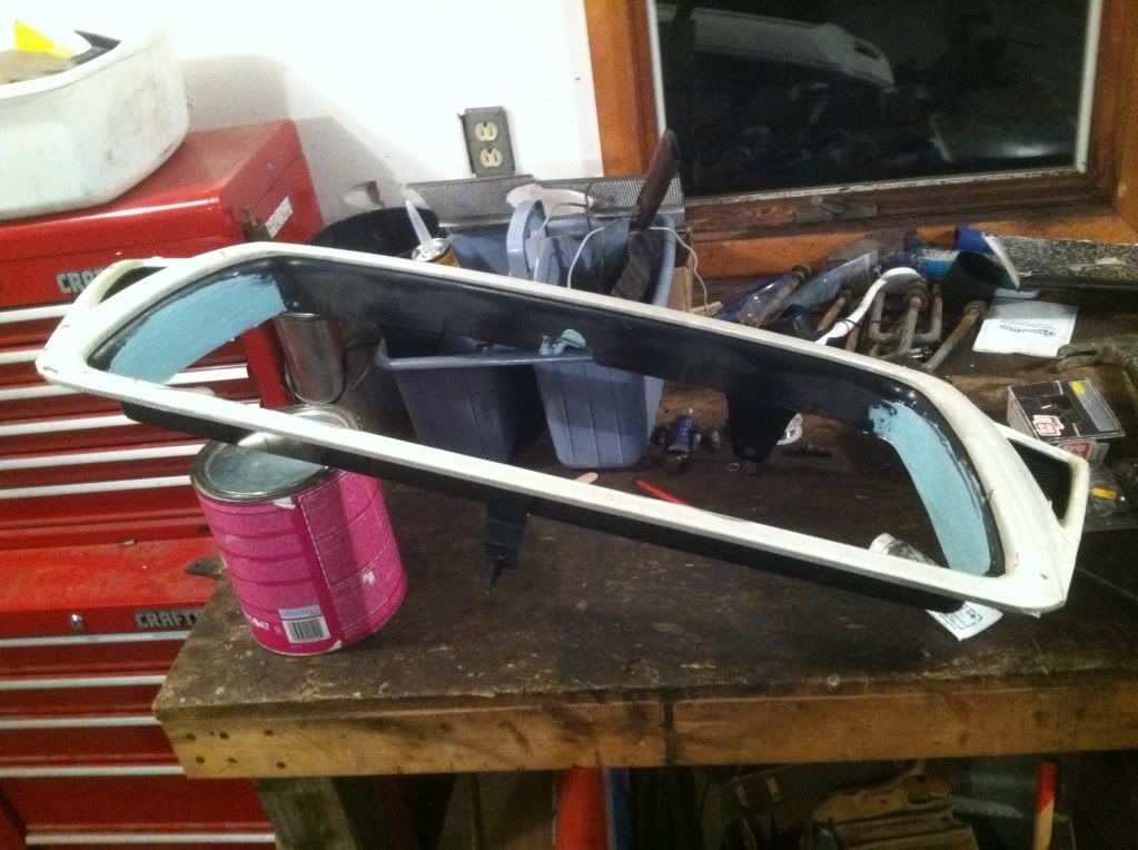

Sanded it all down -
Then repeated on the other side -
All done -
First coat of body filler -
Tomorrow, I'll knock down the filler and add another coat. If all goes well I'll be able to paint it this weekend.
