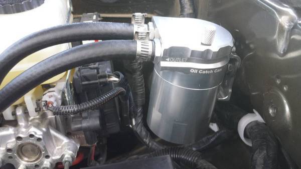

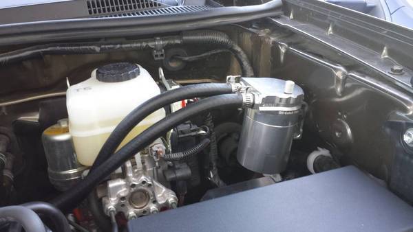

ADD W1 Oil Catch Can Installed. (After about 200 miles of driving had a decent amount of oil)
I used the bracket that came with the W1 can and drilled a bigger hole. I then used my spare skid plate bolt and bolted to an existing hole in the engine bay.

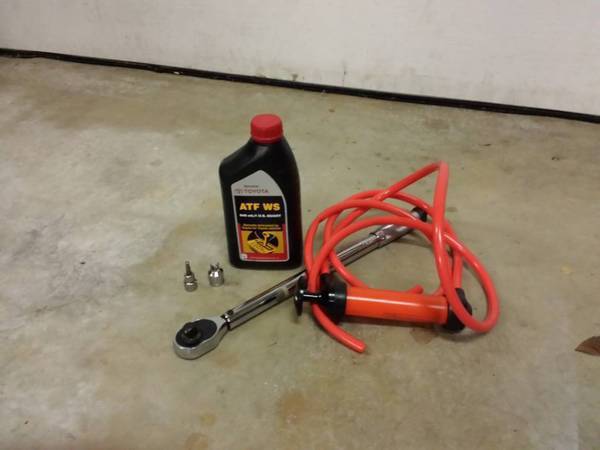

Decided to check transmission fluid because of this thread: Trans Fluid Low From Factory
It ended up being about 0.5 Quart low, shifts are smooth and doesn't seem to stick so bad changing gear from "Park" now.

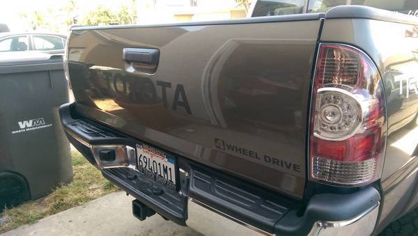

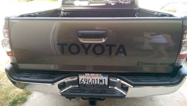

"TOYOTA" & "4 Wheel Drive" old school Tacoma decals in Flat Black (REMOVED March 28th, 2015)

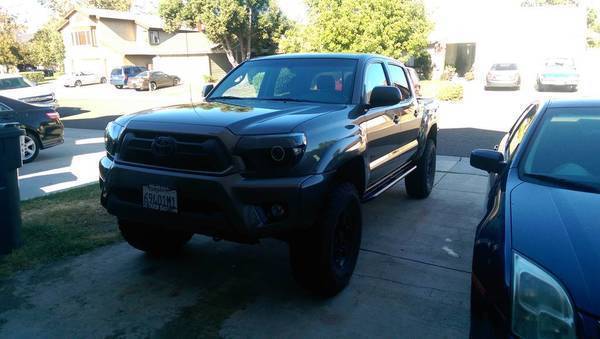

Pic is on the driveway but no angle! Oh yah black'd out the badges.
