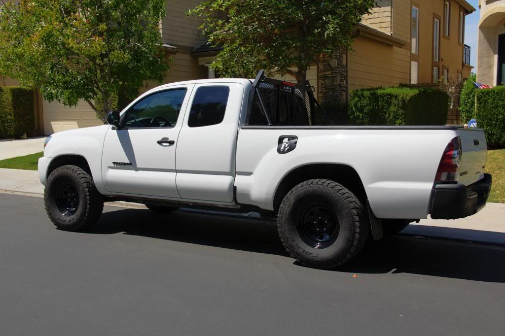

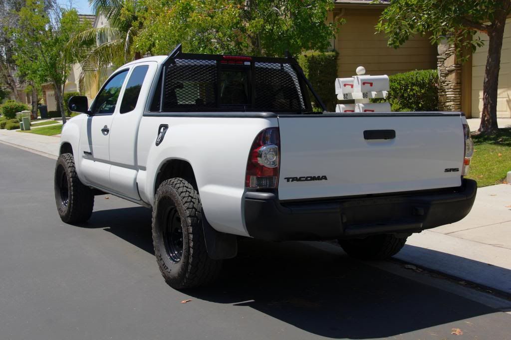

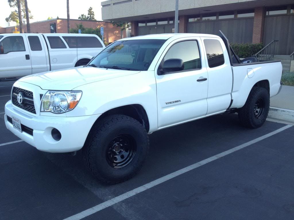

    As she sits today :(
    Completed mods:
    LED's under bed rails

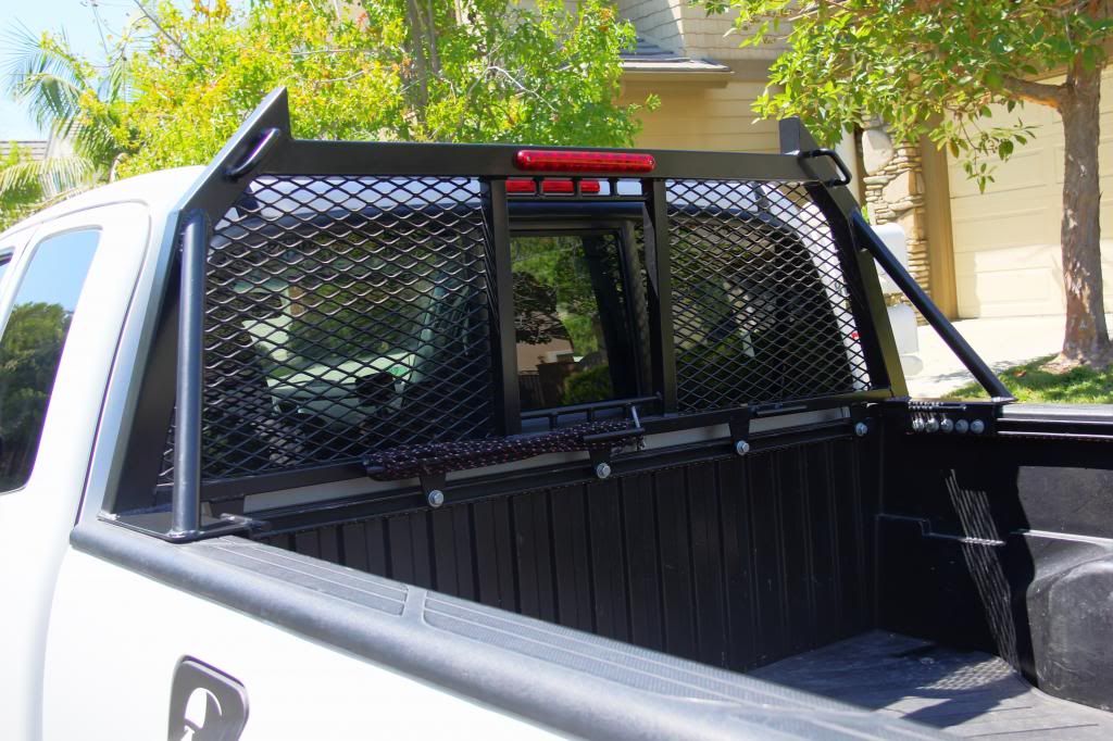

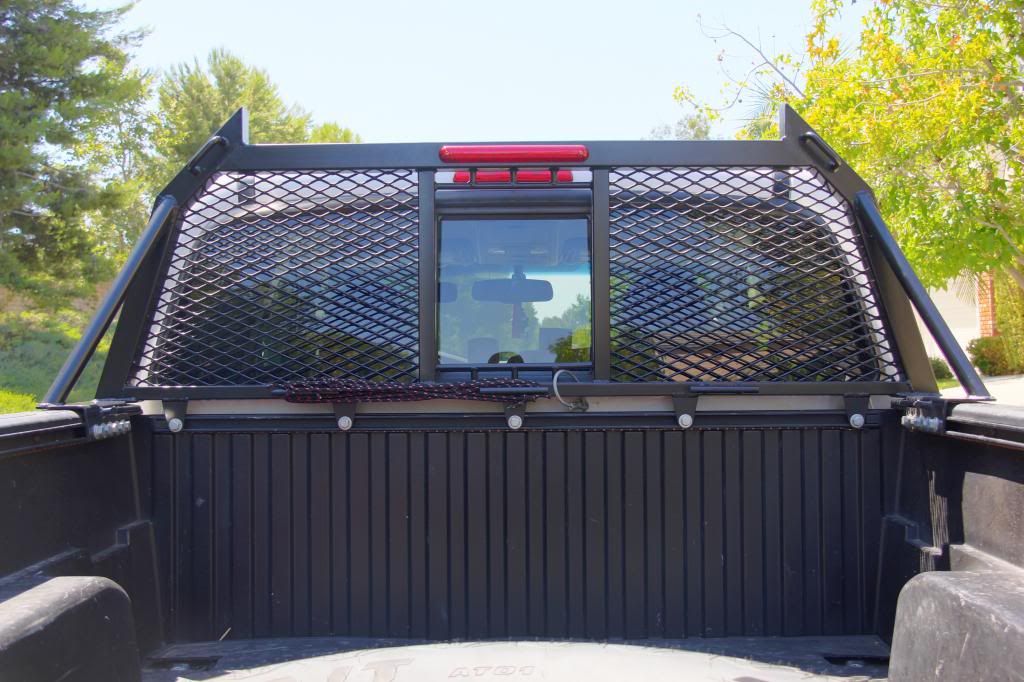

    custom headache rack
    air horn
    bed mat
    bed tent
    air mattress
    weathertech mats

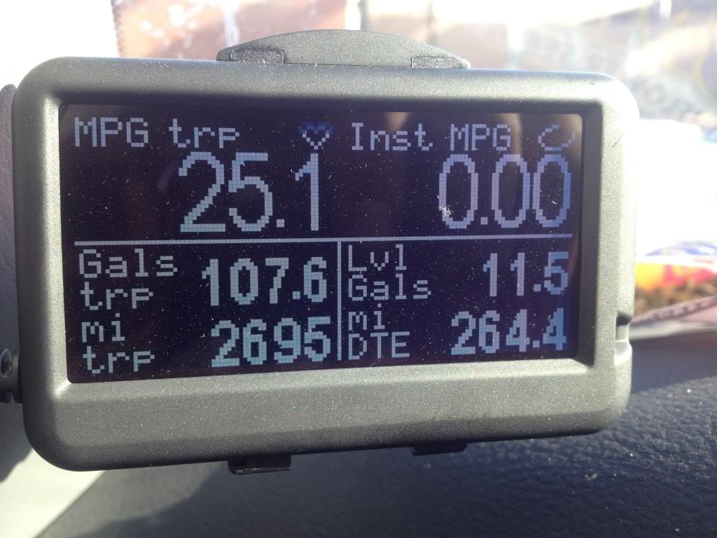

    ultragauge
    Fat Bob's lift kit
    Bilstein's in the rear
    15x7 procomp series 98 rims
    Falken a/t wildpeak 32 11.5 R15
    color matched grill surround and front emblem
    plastidipped badges
    bedlined rear bumper
    plastidipped front valance
    Beefed skid plate
    Magnaflow muffler
    regeared to 4.10
    black taillights

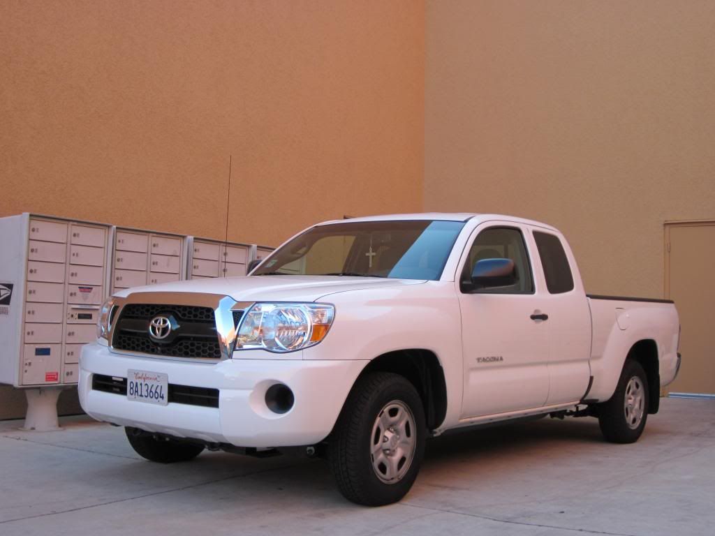

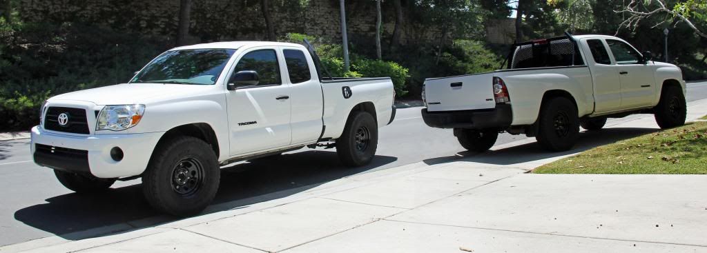

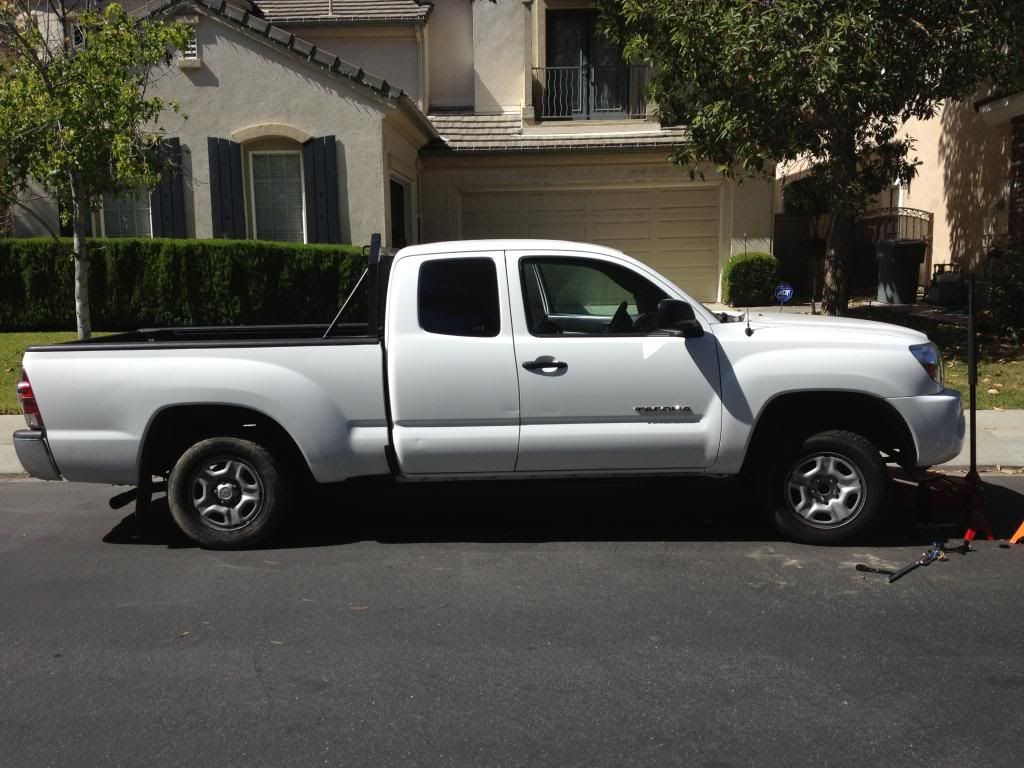

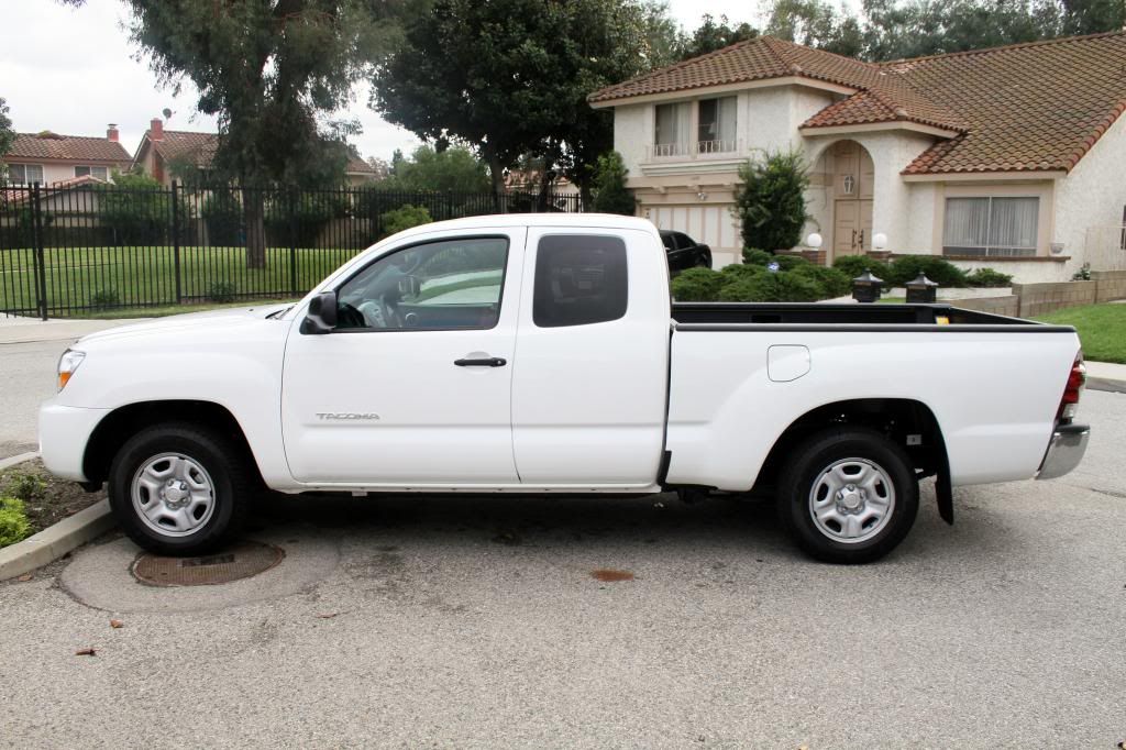

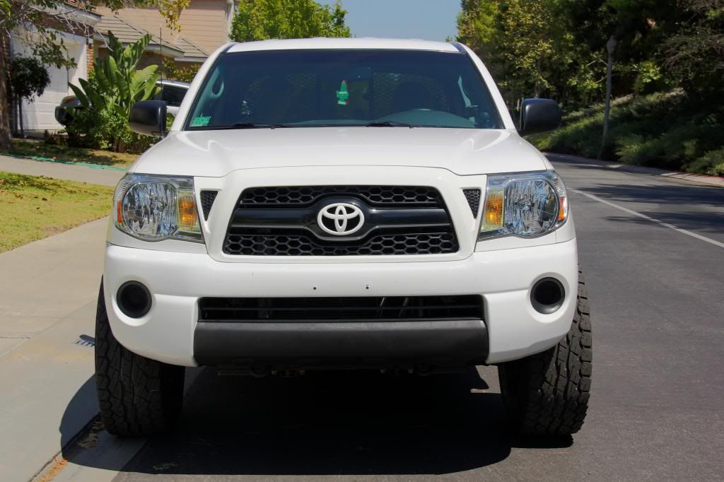

    Bone stock:

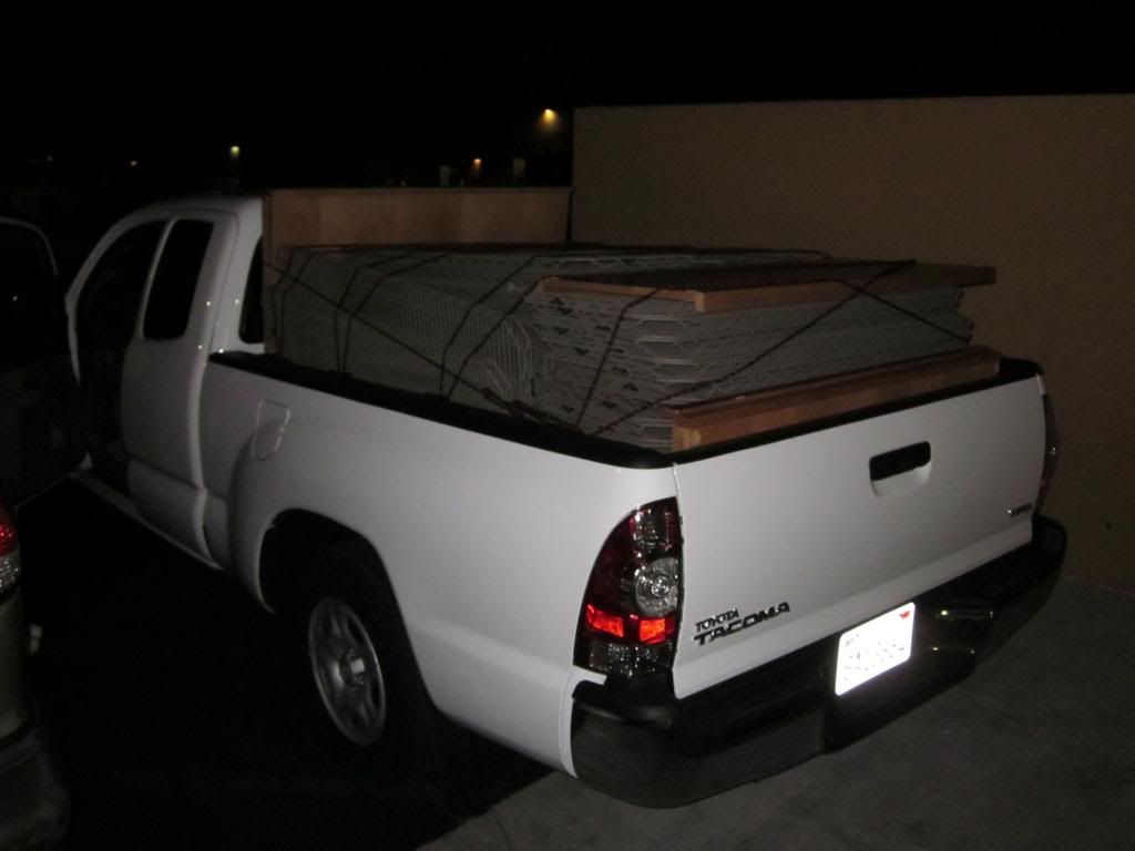

    First big load weighting about 1300 pounds:

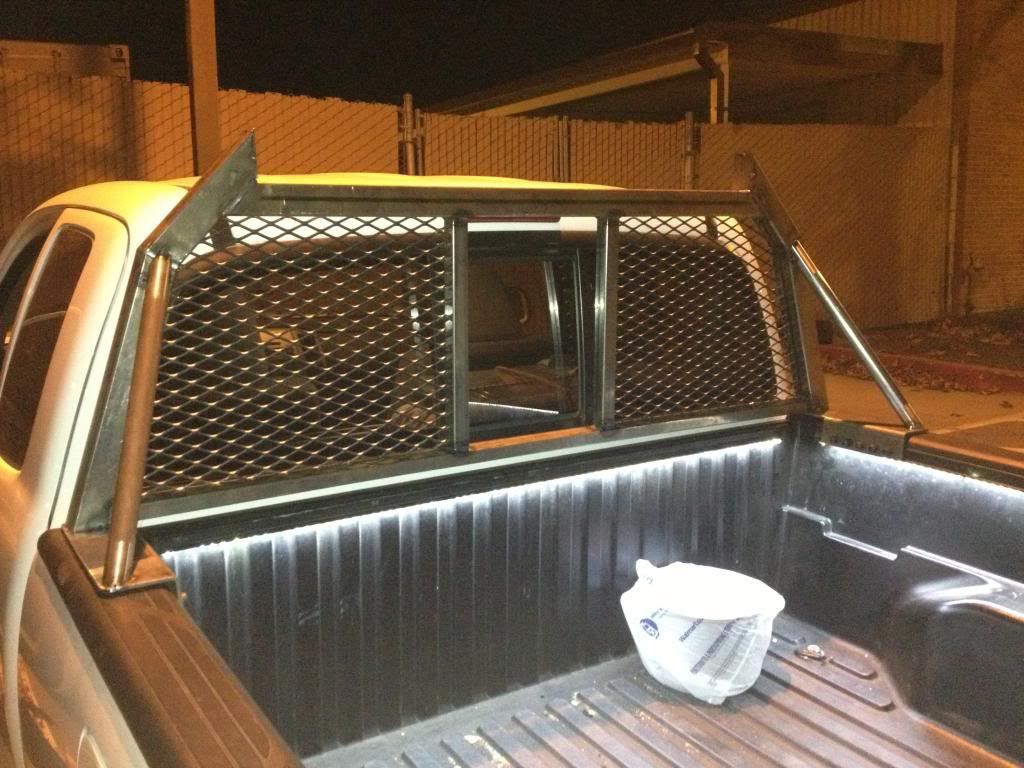

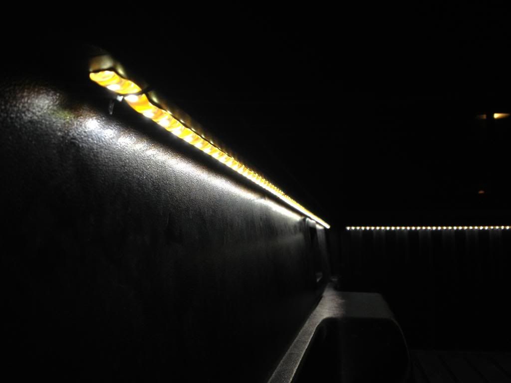

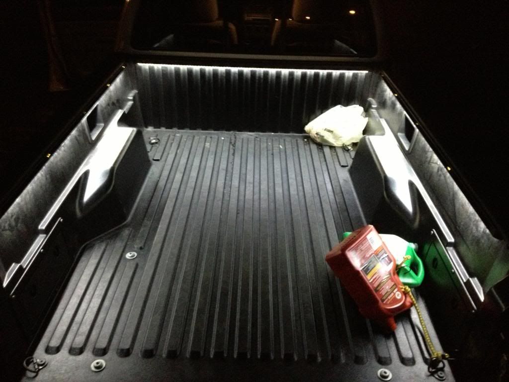

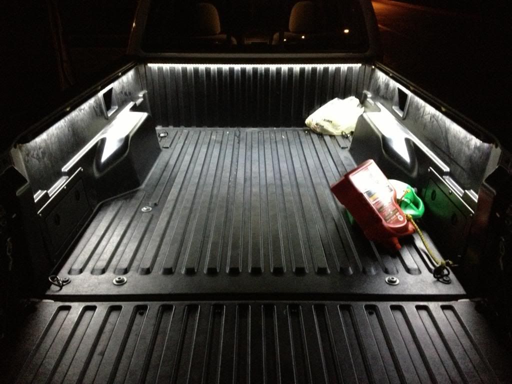

    LED's under rails:

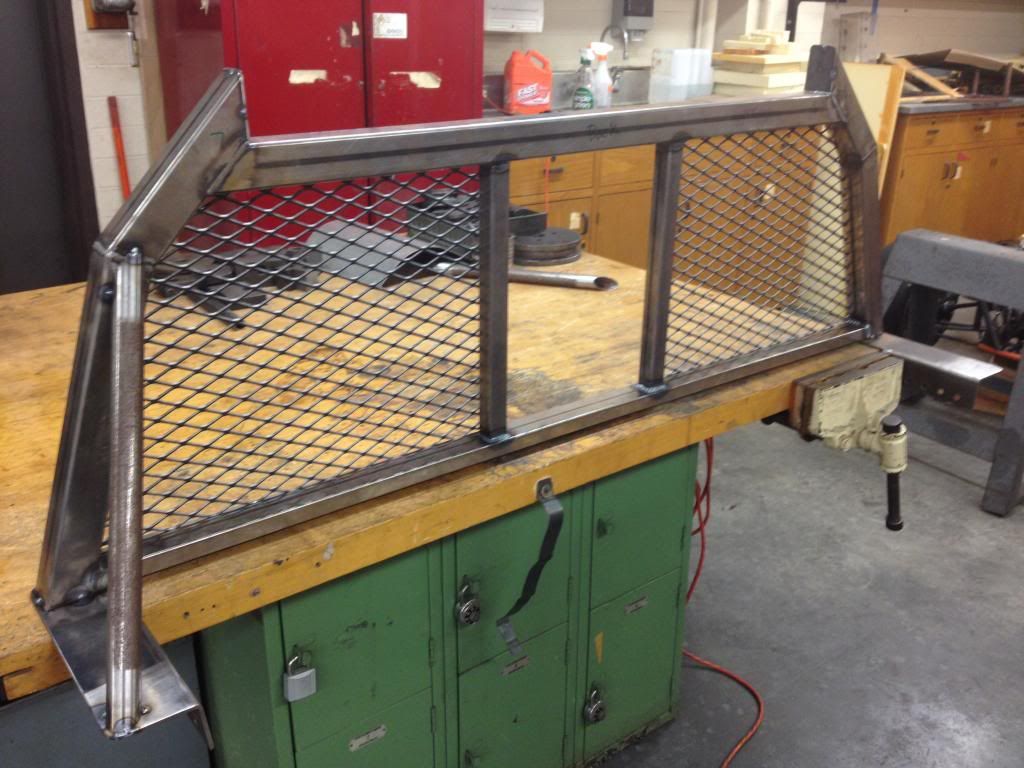

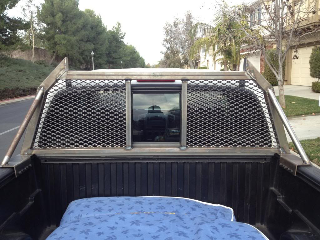

    Headache rack progress shots:

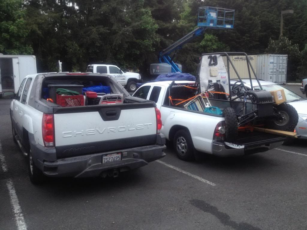

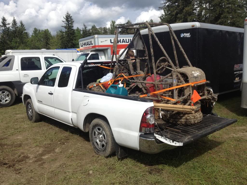

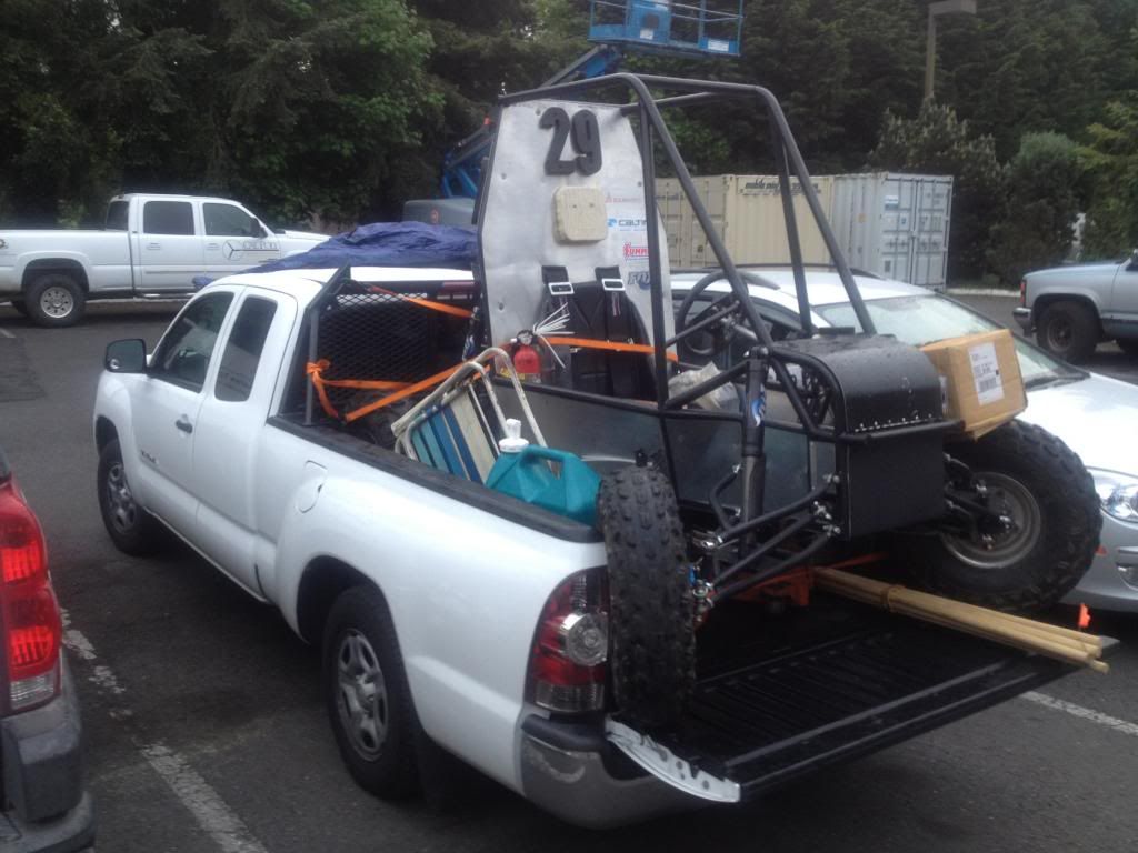

    Trip to Washington with CSULB baja SAE
    total miles

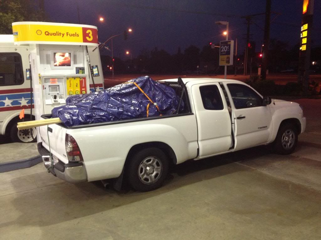

    gear hauler on the way up

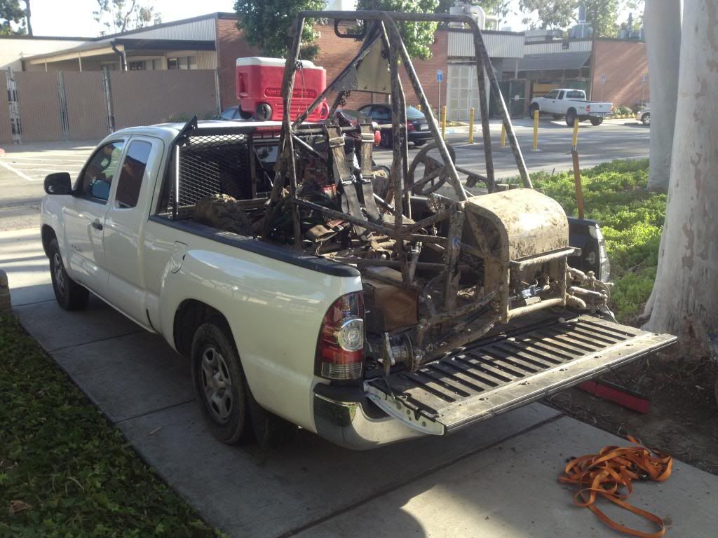

    car hauler on the way down :cool:

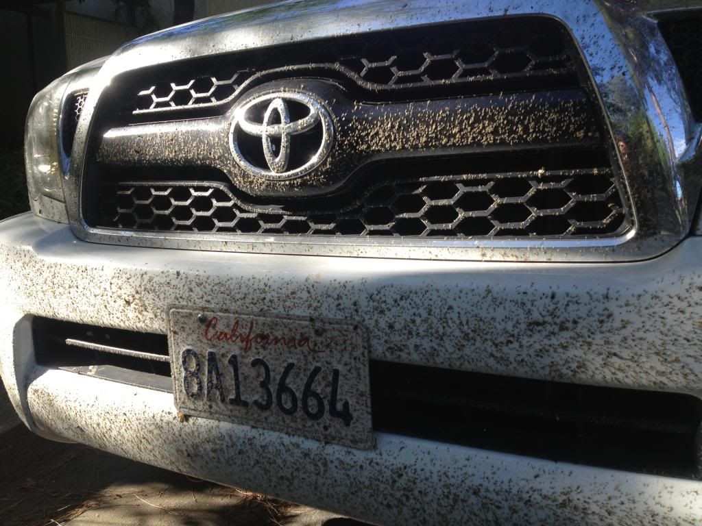

    bug storm

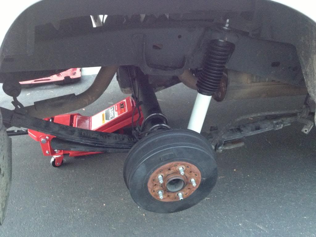

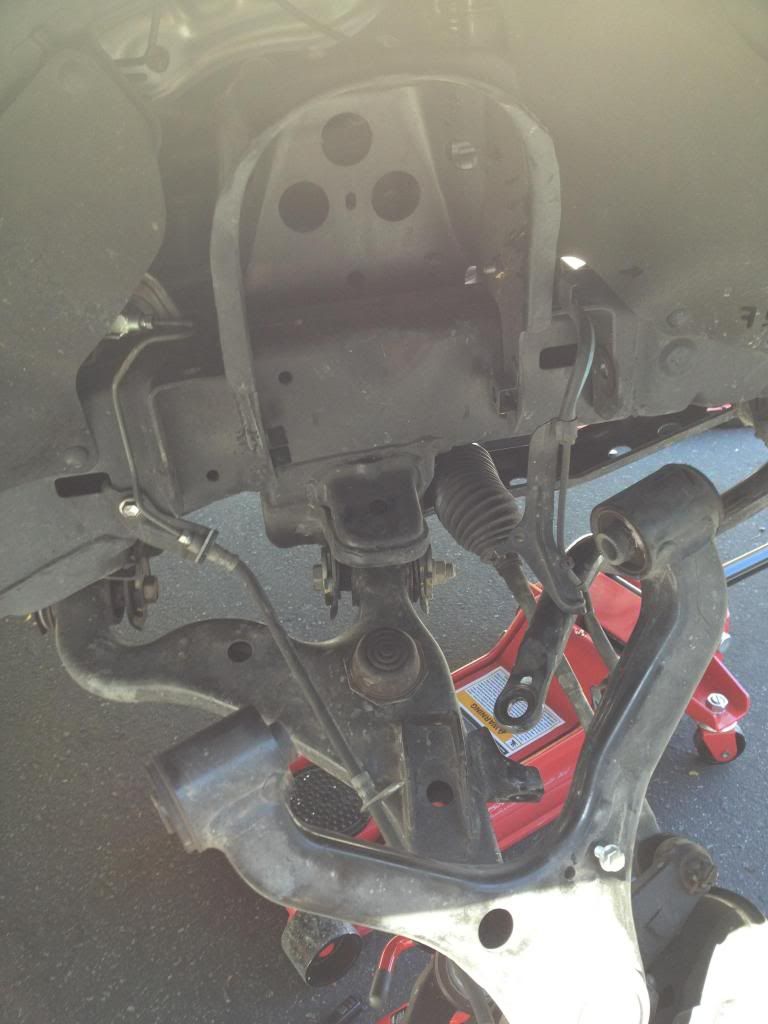

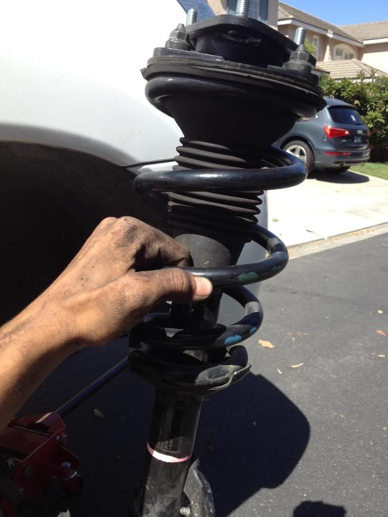

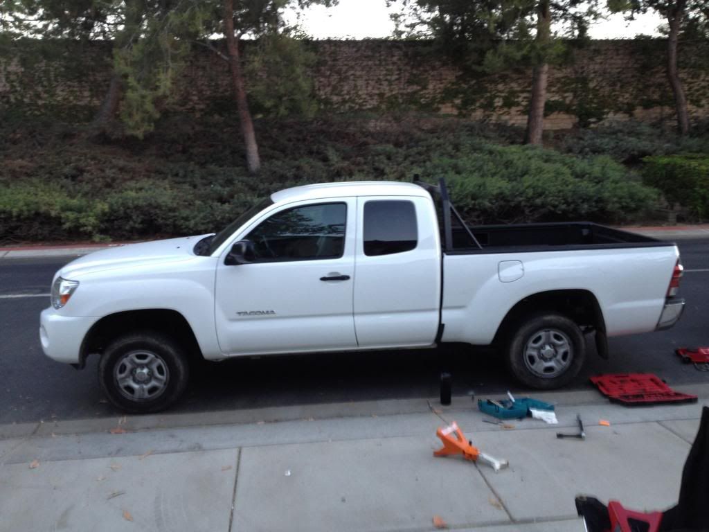

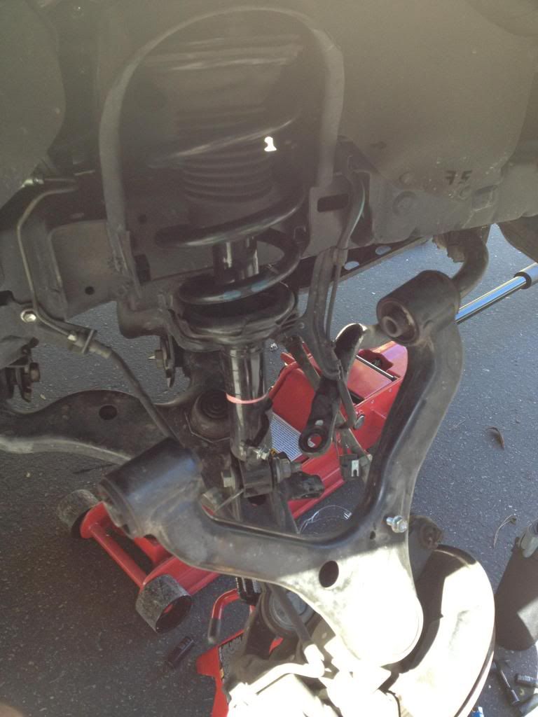

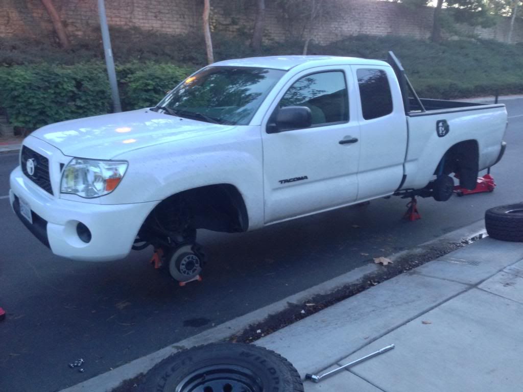

    Installing the lift:
    out with the old:

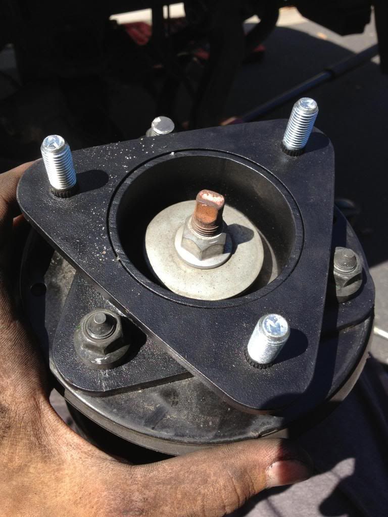

    back in with the old...plus spacer
    dat cali lean
    rear done (when I still had the shitty fat bob's shocks)
    all done!

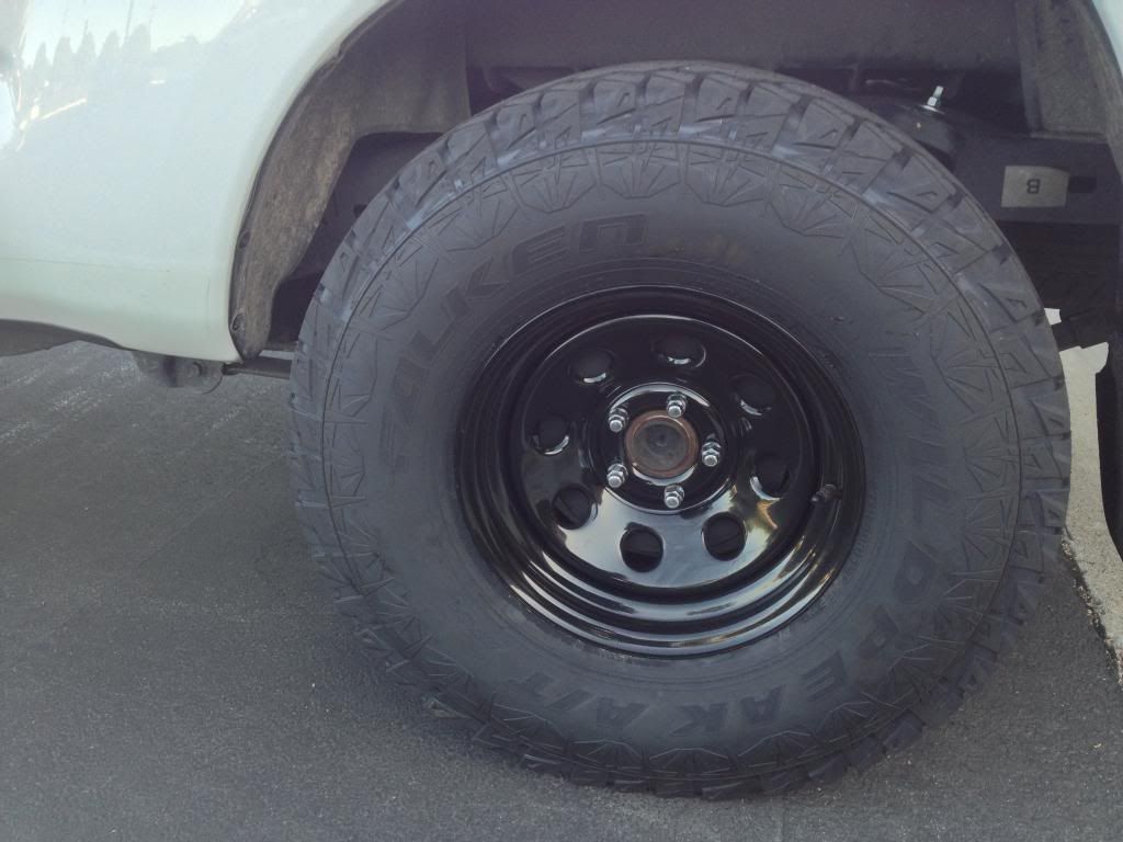

    new shoes on

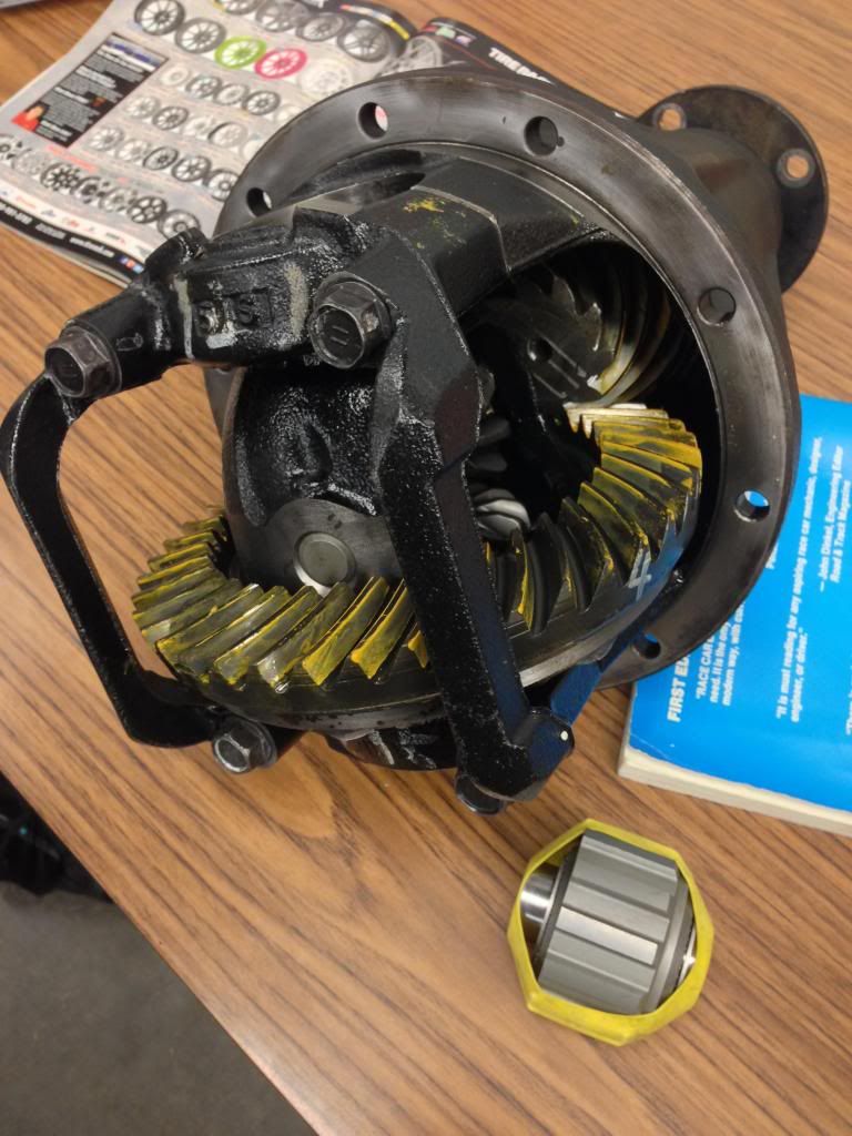

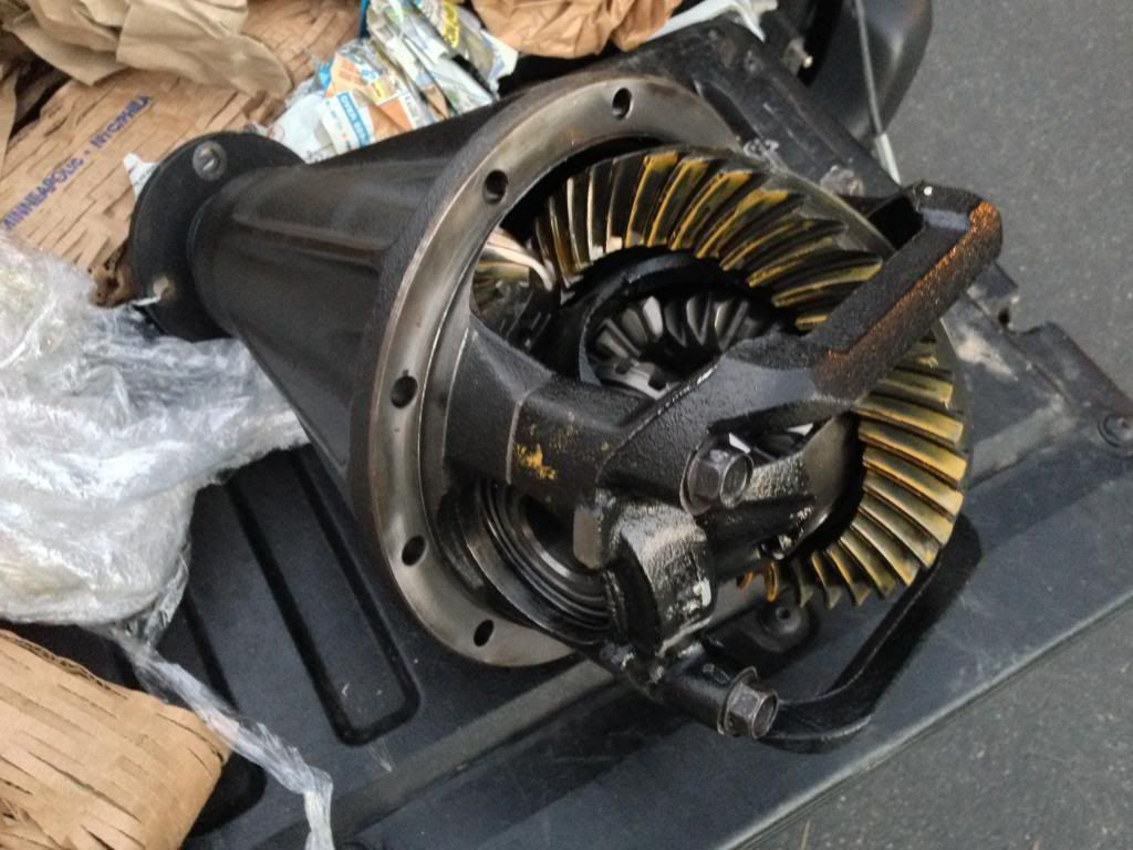

    Diff swap:
    next to our adorable baja car diff

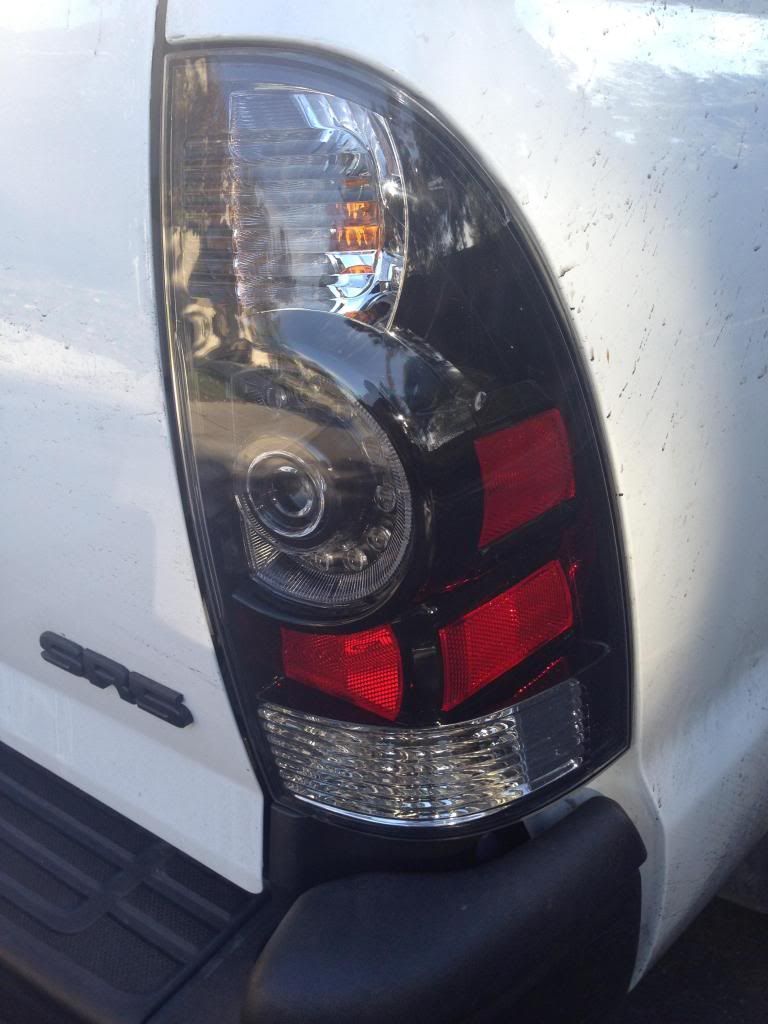

    Black tail lights:

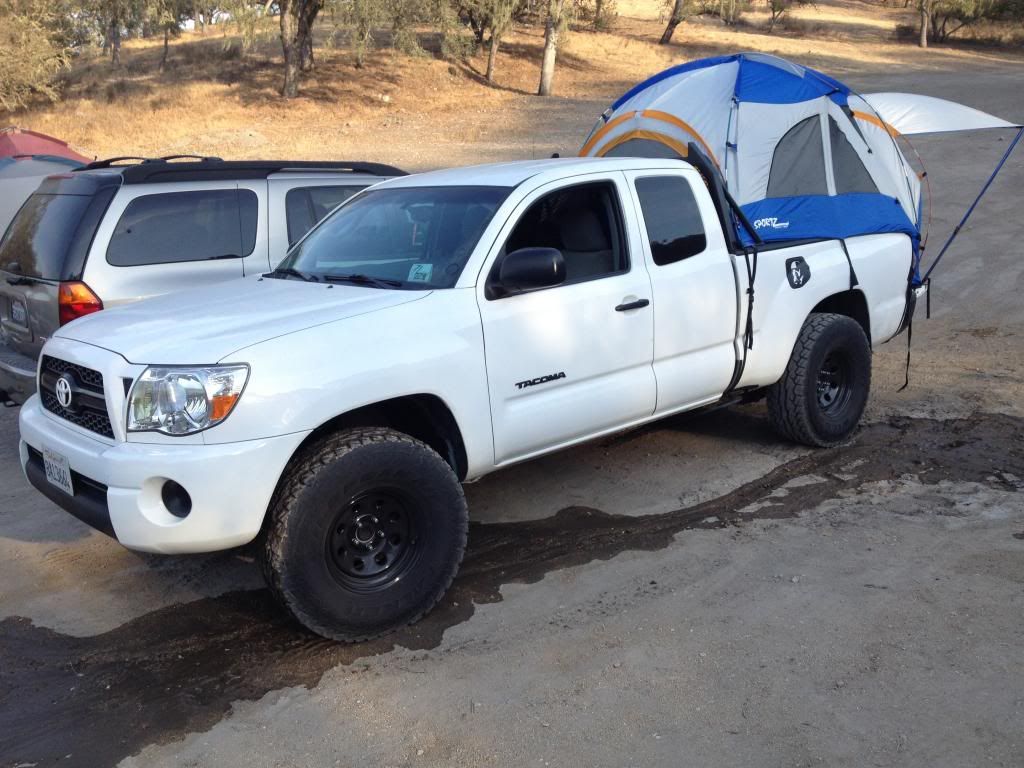

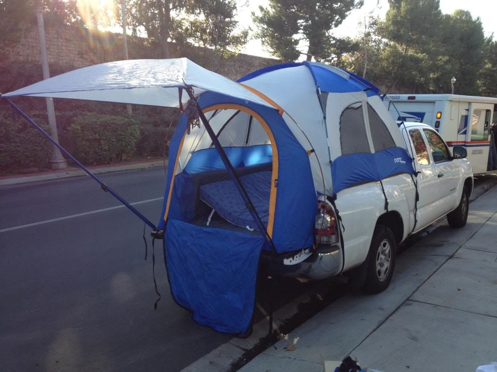

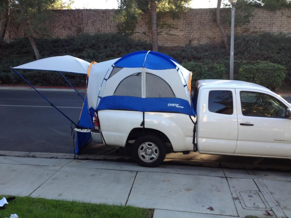

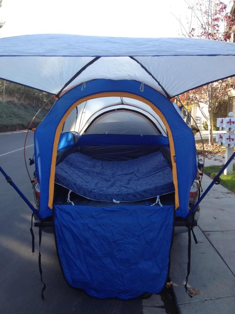

    With the tent:

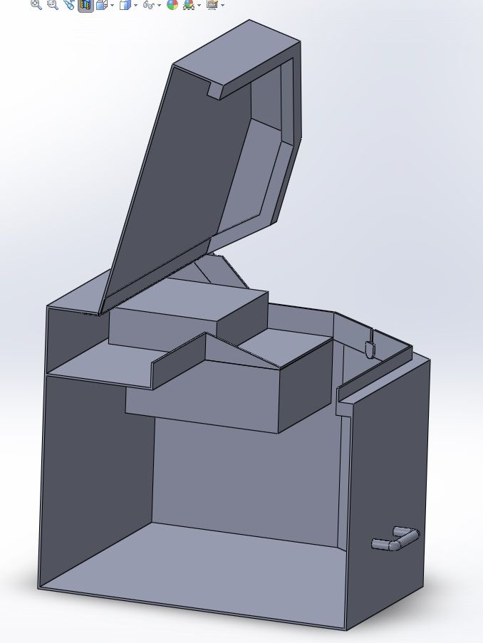

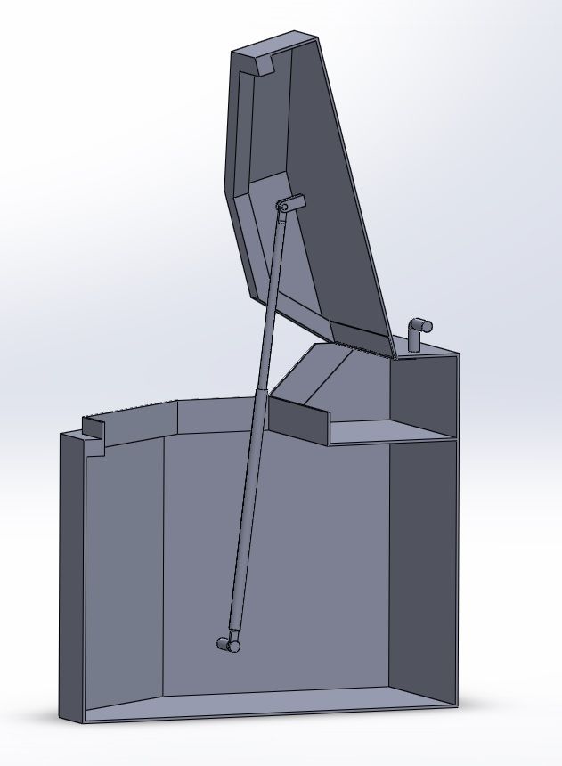

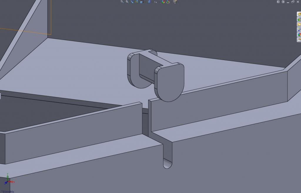

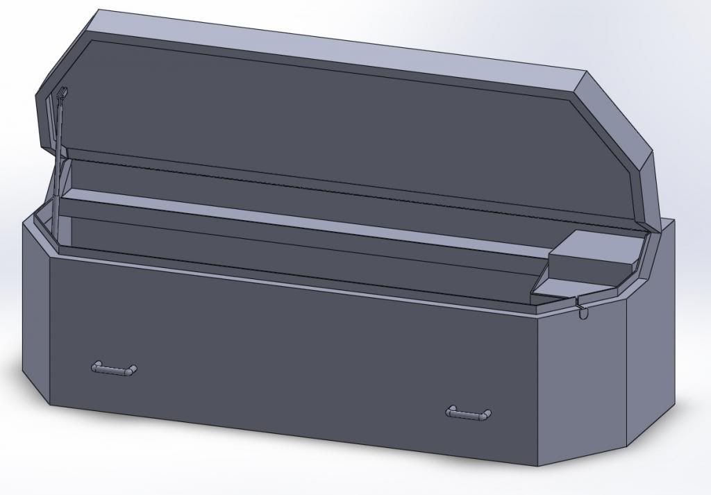

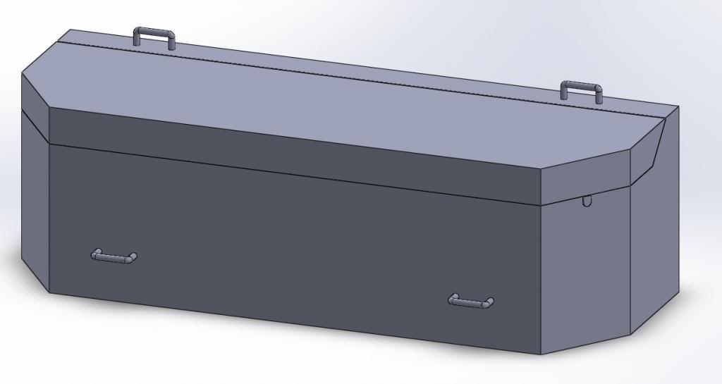

    Currently cooking up the design for the toolbox:
    100lb gas strut on one side
    "head unit" on top with "inverter" below it. Deep cycle battery will sit below inverter.
    chord slot with removable plug

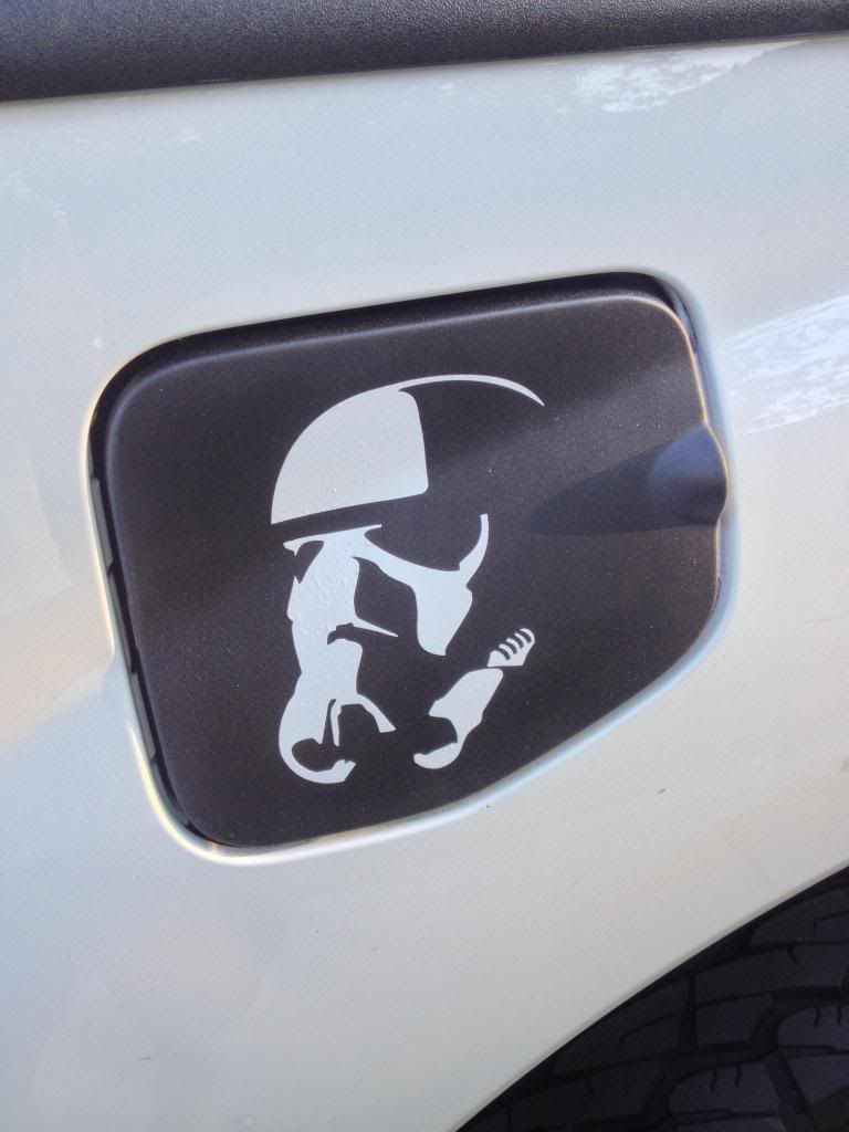

    and if there was any doubt that she was a stormtrooper?

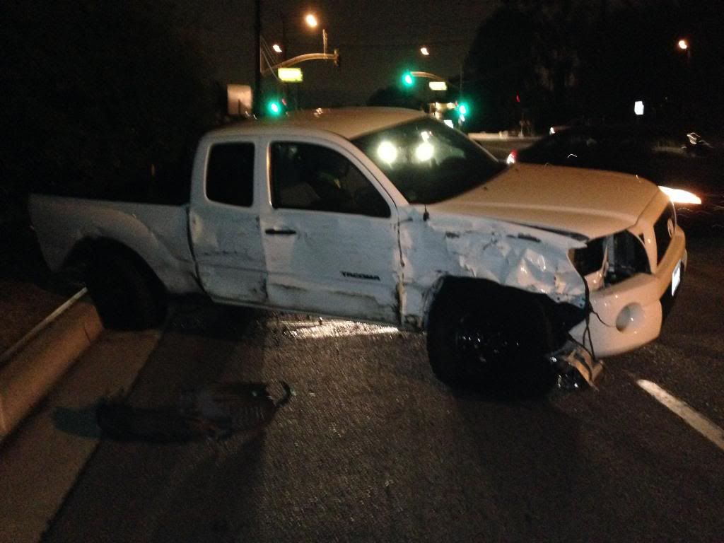

    So I guess I'll just turn this thread into a shrine for my ol' girl. She got totaled today when some dumbass in a sequoia decided to make a u-turn in the middle of the road. She came out of nowhere and i tried to swerve to avoid her, but there wasn't time and my whole passenger side slid against the front of her car.
    For anyone interested in the ensuing carnage (I know you sick folks are out there :p) My entire pass. side is smashed, pass. headlight gone, bumper's fucked up, pass. side panel of back window shattered, pass. tires popped and a little shredded, rims banged up too, pass. leaf springs ripped out, pass. front suspension is donezo, bed's ripped up like a sheet of paper, aaaand the frame's tweaked, soooo yah, I think it'll all buff out haha. But all in all everyone's okay thank God, but Leyna's totaled :( But my headache rack didn't get a scratch! haha And the guy who towed it was super cool and let me take it with me before insurance checks out the truck on Wednesday!
    So I probably won't get another 2nd gen Tacoma for a while until I can afford it, but I'm planning on getting a 90-99 toyota pickup or maybe even a 84-89 4runner depending on what I can find. So I'll still be in the family :)
    Here's the pics and a sad video of the tow truck pulling it into the garage.

    hey man i have a stock 09 access cab and i was looking to get the same exact build as far as the fat bob lift with the 32 inch wild peaks and the 15x7 pro comp rims. I was wondering if you had any rubbing issues and if you had to modify anything else for the tires and wheels to work like shaving down the wheel well or doing the black box mod. Thank you so much and awesome taco!!

    Sorry, just got your PM. I did do the black box mod and if you're planning on getting the exact same rims, you might need some quarter inch spacers up front to clear the calipers. At slow speeds i was able to get to full lock with no rubbing, but when i turned at higher speeds i rubbed on the sway bar which was a little sketchy. I'd say as long as you don't make any crazy turns you'll be fine. Hope that helps and good luck with your build!

    thanks man I'm so sorry to hear about the wreck but do you have a link to the wheel spacers you used by any chance? thanks

    Unfortunately I don't. The guy that helped me at the tire place was generous enough to just give me some he had laying around in the shop for free. But I'm sure any 1/4" spacer that's compatible with a 5x4.5" pattern should work. I think mine were universal ones that fit a variety of lug patterns.

    As far as trimming, I just did the black box mod. I got your email and to answer your question about calibration, you can get this to re calibrate both the built in speedo and odo.
    Personally, I had an Ultragauge and recalibrated the distance settings on it. (It's pretty easy and if you have any questions, feel free to ask) That way it could display the correct speed and MPG's and it also displays a ton of other stats. So my built in speedo and odo were still wrong, but i just looked at the Ultragauge anyway. The Ultragauge is about $70 whereas the in-line speedo calibrator is $190. Hope that helps! :)
