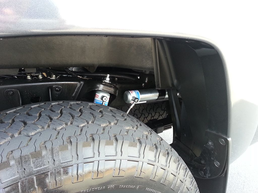

Finally, got my hands on a Baja Kit. I felt like a little kid when this showed up.
Freshly installed!!

My truck came from the factory with the 4 leaf pack in the rear (3 +1), so when I installed my Icon AAL I had to grind away one of the clamps on each spring pack to allow the AAL to fit properly. I got a head start a couple weeks ago by taking the Icon AAL kit apart and wire brushing away all the rust that was between the leafs since Icon, or their supplier, coats the leaf pack assembled. Then, after applying some fresh coats of paint, I let it cure and added a thin coating of red marine grease between each leaf where they touch.
Installation was pretty straight forward and with the help of a friend took about 3 hours. Grinding off the factory pack clamp wasn't that bad with the help of an angle grinder and cutting wheel. We managed to get it done without even removing the leaf packs from the truck. I had to enlarge the holes for the e-brake cable bracket, which I had heard I may have to do. I reinstalled my factory U-bolts and nuts, the Icon U-bolt package that was included had one nut that was the wrong size. After contacting Icon they were very helpful and have a replacement on the way. Overall lift in the rear seems to be just over an inch. Right now I have a full tank of gas so I'll measure again once it's empty. Before the install the rear wheel gap averaged about half an inch lower than the front. Now it's a little over an inch higher.
