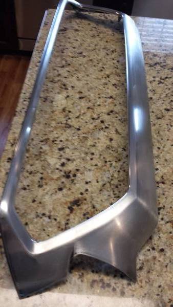

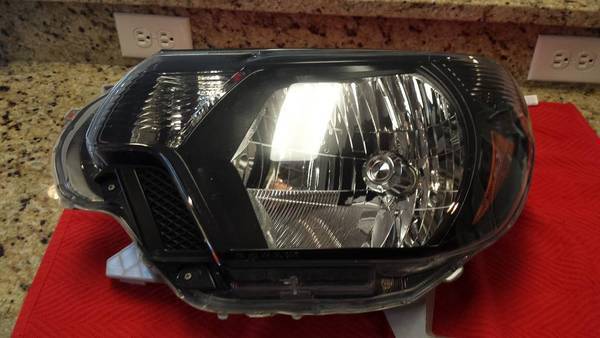

Thought I would tackle the BHLM and Color match grille at the same time.
Paint matched up really well. I wish I would have spent a little more time on the clear coat. I can tell a slight difference up close but anyone else I've asked say it looks factory.
After install

Two questions for you, the grey grill prior before being painted was that purchased or did you modify the chrome one in prepping it for paint?
And secondly, what color paint did you use? I have spent ages trying to color match my truck and yours is by far the closest I have found!

It is the original chrome grill off the truck. Followed standard painting procedure and used Duplicolor color match paint from local autoparts place. It matched perfectly. Clear coated with duplicolor clear coat. Haven't had any problems with it holding up.
