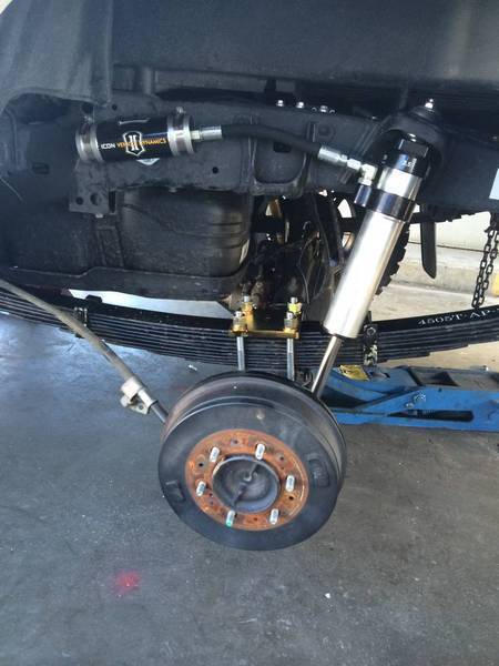

My first Tacoma Build
2014 Tacoma double cab short bed 4x4 TRD Offroad package with 6 spd manual
Current as of December 30th
Current
Engine:
Magnaflow Offroad catback exhaust
Suspension:
Front:
Icon 2.5 Extended travel coil overs with remote res and 700# Springs
Total Chaos UCAs
Wheelers extended brake lines
Wheelers Superbumps
Removed sway bar
Rear:
Icon 2.5's with remote res(Removing in February)
Allpro Expedition leaf springs
Allpro U bolt Flip kit
Wheels/ Tires
Fuel Hostage 17x9 with 4.5" BS
BF Goodrich KM2 285/70-17's
Lighting:
Rigid 20" LED Bar w/ Rigid LED Light cover
Rigid Dually Fogs
Rigid Reverse lights
Interior CSJumper White LED Map, Vanity, and Come lights
Flyzeye Black housing V2W w/ white and blue lights
Flyzeye 3VP X2 Blue(glovebox) and White(armrest)
Exterior
Pelfreybilt Front Bumper with hoops, and fog/ led bar cutouts
Pelfreybilt Rear High clearance bumper with hidden winch, gate, rotopax deluxe mount with 2 Rotopax 3-Gallon Fuel Tank, and reverse cutouts
Bestop Supertop
Cab mount chop(Need to weld on plates)
Black Plastidip badges
DIY Grill kit(satoshi-ish)
Toyota Tacoma Bed mat
Front fenders trimmed 2.5", pinch welds smashed
Pelfreybilt Tan Trasharoo
Armor/ Recovery
Pelfreybilt sliders
Pelfreybilt Gas, IFS, and Mid skid
Warn Zeon 10-S Winch w/ solenoid relocation kit
Factor 55 1.5" hawse fairlead
Factor 55 Flatlink
60" Hi-lift w/ Pelfreybilt bed mount
ARB High output CKMA12 Compressor
ARB Air Pump up kit
ARB Tire plug and repair kit
ARB Tire deflator
ARB Tire inflator
Interior
Black Weather Tech Floor mats
Ultragauge
Comms
FireStik II 4ft CB Ant. w/ FireStik Heavy Duty Stainless steel spring and FireStik Heavy Duty stud mount
Cobra 29 LX LCD CB Radio w/ 18ft cable
BAMF CB Passenger Tailgate/Bed Mount
Baofeng UV5R Dual Band Handheld
Awaiting Install:
ARB RD121 Front air locker(waiting on gears)
Energy Suspension 4.5" rear bumpstops
BAMF Raptor style Toyota Letters(Primed and Painted Gun Metal color)
Blue sea systems 12 fuse panel and breaker(Pelfreybilt is waiting on my truck to build prototype for manual)
Pelfreybilt Rear transfer skid(waiting on exhaust reroute)
Pelfreybilt Battery Cage(need battery)
2x SDHQ Offroad CV Boot kits(I'm being lazy)
Famous Fabrication hood light mounts(awaiting rigid dually d2's in February)
Future Plans
Exhaust reroute
Pelfreybilt bed rack over Bestop
Pelfreybilt Manual Tranny Fuse Panel
Ordered
Pro Comp Rock Crawler Series 97 17x9 spare wheel
5" XJ Shackles for ATO Flip kit
Ordering Soon:
RIGID Dually D2 White Driving lights
BAMF or Pelfreybilt Rear shock relocation kit
Bilstein B110 5100's
ATO Shackle Flip
G2 Nitro 4.56 Thick Gears from ECGS
Ordering sometime...
35's
Group 31M Deep Cycle Battery
King 12" smoothies

Yesterday I pulled out my Icon C/O and installed the new 700# springs as well as lifted the front another inch to level out with the back.
Finished installing my Pelfreybilt front end including my winch and lighting.

Cut my rear panels and installed the Pelfreybilt High clearance rear bumper.
Took my truck out to Welks Run and tested out the new springs and clearance. Now I need some bump stops. Thinking I will get get wheelers super bumps in front, not sure on the back though.
Any suggestions?

truck looks good bro. I'm digging that pelfreybilt setup you got. I got super bumps in front and love them. I'm running stock in rear

since you are running the expo leaf pack you could do the pelfreybilt rear shock relocation and stick some 12" kings in the rear with hydro bumps...super sick setup in rear
Definitely will happen down the road, probably in the fall.
I love the Allpro expos, worth the wait and crappy customer service at allpro during their transition to Montana.
Thanks!
