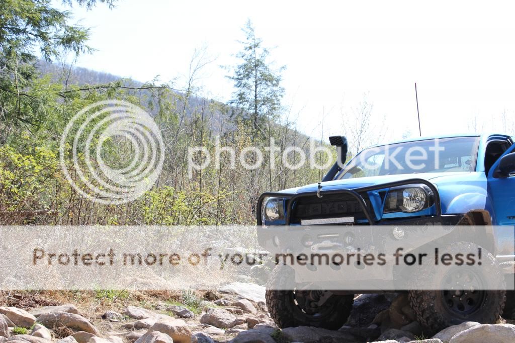

Anthony's 2010 banworthy access cab mostly BS not much of a build thread
Couple of pics of about current state

That is petty beef.
