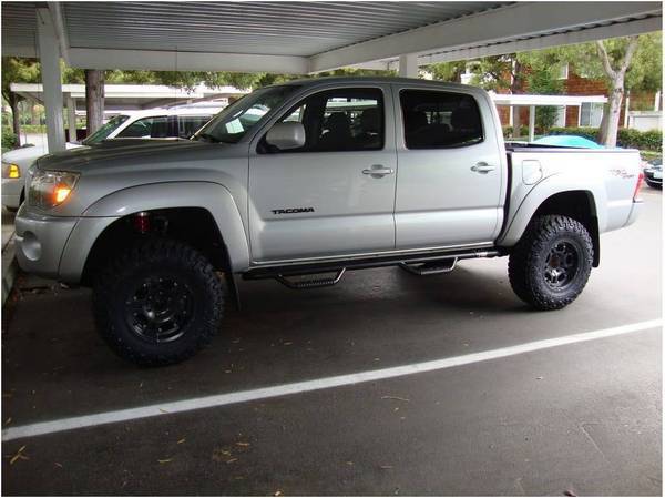

The side steps were a little pricey and have no purpose on the trails, but they look freakin sweet!
Lifted it with Toytec ULK and Dakar leafs-I had the money to buy the UCA's and didn't! Big mistake, the truck drives great on the suspension side but it wonders all over the road. if in doubt, buy the UCA's! I will now have to purchase, install and go back to the shop for an alignment...$$$.

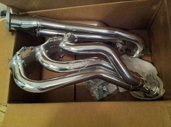

Update 5/25/2011 - Just recieved my Headers Y-pipe and TRD exhaust. This should sound pretty good.
I ended up breaking many more bolts than expected. I was expecting some damage removing my exhaust, but I really did on this job! There had been a lot of tack welds on the bolts to prevent modification, I tried as best I could to break the slag and other metal off but it was just applied too hot...it wouldn't break. The saws-all came out after some grinder troubles...didn't look back.

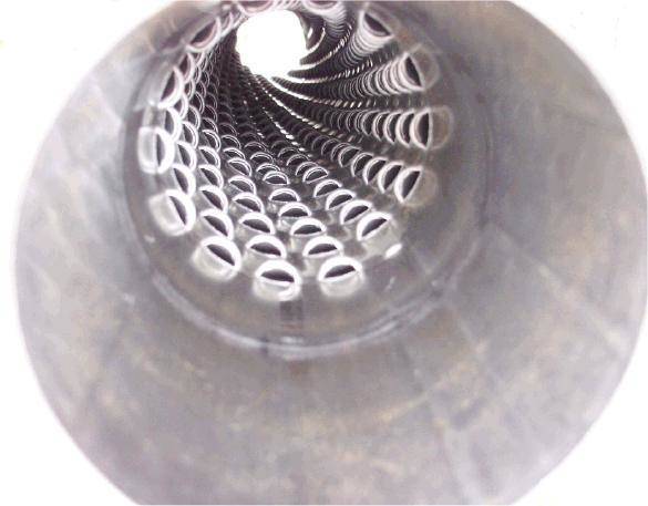

I forgot to take a picture of the Doug Thorley pipe bomb, here is the digital rendering of it. Above was the stock piece being replaced.
One of the classic problems you run into when putting on headers and straight pipe is the horrible rasp. The 6 cylinder does not help either! I usually go with a secondary muffler system, this time I decided to go with a new muffler I had found online in another forum. It has been around since the 60s for the big blocks and hot rods. The design is a simple flow through but being 31" long you get a long buffer zone and a solid throaty tone when the sound exits. You can see the fin type design, by installing it "against the grain" you get a great natural buffer. To say the least I was very impressed when I got it put in.

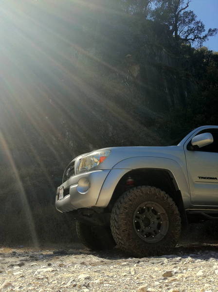

That photo was snapped in Death Valley this year going through Mengal Pass. My wife and I had taken a break right on trail after we encountered a really technical section. The meter had Gone way past 30deg a couple times that week.
