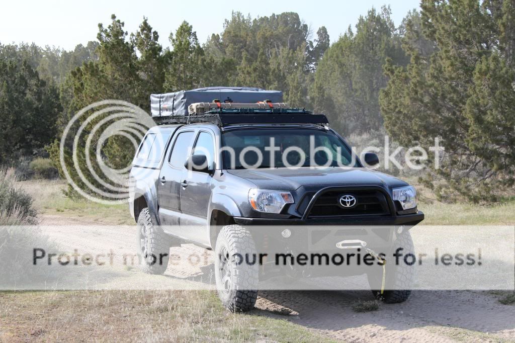

2005-2014 Double Cab Tacoma Cabrac
2005-2014 Access Cab Tacoma Accessrac
FJ Cruiser Roofrac

Scott, I'm very impressed at how fast you're moving with these prototypes. I do have a few concerns that I'd like to mention.
1. The long slot for the cross bars is going to be a weak point. The top of the washer is going to bear on an unsuported strip of 1/4 aluminum. I would suggest that you lay out holes along the side rail that would fit the pattern in the cross bars. You could make several groups of holes so that each cross bar could be moved forward or back several inches.
2. With the shallow cross bar your bearing surface is low meaning your side to side stability will be low. I was planning on using one of the square shapes and adding an angle to the underside of each bar to tie the side rail and the bar together.
3. On a personal note, I would like to see the feet land on the rubber molding without the use of a spacer, but that's just me.
Please keep up the great work. I'm glad to see someone working on this.

1. AGREED! There are few points where it ties in for reinforcement on the prototype model. It is pretty stable as is but I wasn't completely satisfied so I have modified the rail that will be used for production to have more points of reinforcement without loosing the ability to move the bars around a little bit. Instead of having individual holes the entire length of the rail there will be mini slots so that bars can be adjusted forward and backward.
2. I went back and forth on this option. I liked the fact that the square extrusions would have more mounting surface but many of the square options only had one tapped hole where the 1575 has 2. I also thought that the square would be overkill as it has 4 channels and I didn't want to overbuild the rack.
I am satisfied with how sturdy it is with the shallow bars but I have made an adjustment for the final production model that will allow a crossbar in the front, middle and back to swivel down and bolt in making the crossbar become a deep profile and adding rigidity and strength when it is desired. That way I think the rack stays clean and functional for light loads, but still can be adjusted for heavy loads.
3. This is the only point you have made that I don't have a solution for. The channels on the roof are curved in that the front mounting points are wider than the rear. For the rails to fit right down in the channels the crossbars would have to be different lengths which defeat the purpose of the moveable extrusion crossbars. I am working on making it so that the spacer is a abs plastic block rather than round aluminum spacers but testing it out, the difference in strength and stability is negligible.
I hope I don't come across as snobby and defensive. I really do appreciate the criticism and advice. I am sure new ideas will come along in the future just like they do with any product, but for now I think this model will serve the needs of quite a few people.

Perfect!
I like the idea of turning the bars vertical. That will also let you mount lights on the front and back to the slot in the extrusion. Great idea!
I agree that getting the feet down on the roof would be a trick considering the holes in the roof don't line up in a line.
Hey, I'm offering constructive criticism and you're coming back with well thought out responses. It's all good!
