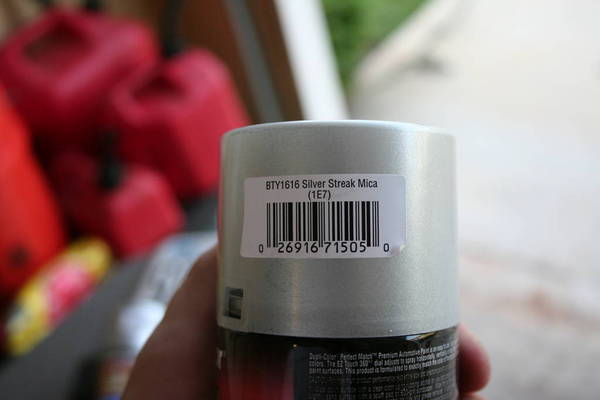

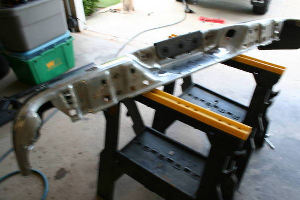

So I was browsing advance auto parts today and came across this duplicolor perfect match spray...and what do you know...they have my paint code! Sweet now I have something to do today. I bought two cans of it and some sandpaper, then headed to O'reilly auto parts to buy a quart of clear and some catalyst. I also picked up another can of the silver there since advance only had two.

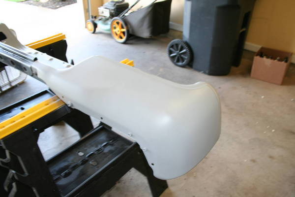

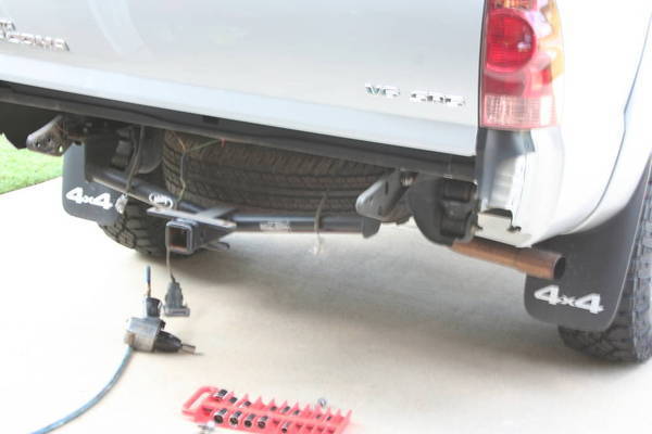

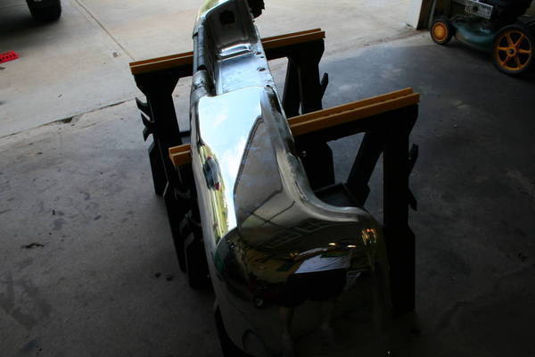

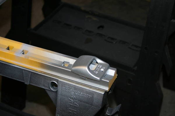

Here are some pics so far. I'm waiting on the last base coat to dry then i'm going to spray the clear. The clear will be sprayed with my HVLP gun.
Enjoy. I will post more pictures when its all done.

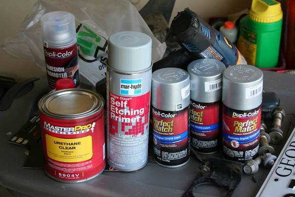

Looks great so far, can't wait to see the finished product. Also, I always wanted to try to spray with an hvlp gun. How difficult is this? Thanks!

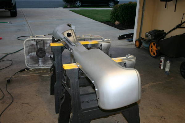

Its not too hard, you just have to play with the settings on the gun a little to get the right spray fan and amount of paint coming out. I usually just spray a wall or something to get it set right before I spray the piece i'm painting.
I just sprayed the first coat of clear, about 10-15 minutes flash and then the second coat goes on.
OBTW forgot to mention the steps I took for those insterested.
Take all the black trim off,
then I sanded with 400 grit on a DA sander changing paper fequently.
Then I wet sanded with 600 grit and a dawn dish soap and water mixture,
then washed it.
Then dried it off,
then wiped down with rubbing alcohol to clean any final residue.
Then I sprayed with the self etching primer, 3 light coats
Then 3 coats of base
Now spraying clear (I recommend wearing coveralls. clear gets sticky especially for hairy guys like me)
Follow all directions for proper dry/flash time.

1 more question, can that clear be sprayed without "reducing"? There are alot of chemicals and can be a bit confusing at times. It would suck to buy the paint/clear and screw up the mix before you even spray or worse, ruin your prep work and have to start all over again!

You dont have to reduce clear, you mix a catalyst in it which activates the clear and causes it to harden. Sometimes I will mix a tiny amount of reducer in the clear to let it lay flatter but the clear seems to be laying pretty flat today (perfect temp and low humidity today)

Ok I just finished the clear coat. Here are pics. I'm gonna let it dry overnight and put it back on tomorrow morning.
You can see my trusty harbor freight HVLP spray gun. I have painted many cars and many pieces of furniture with that thing. Cost me $65 about 4 years ago.
