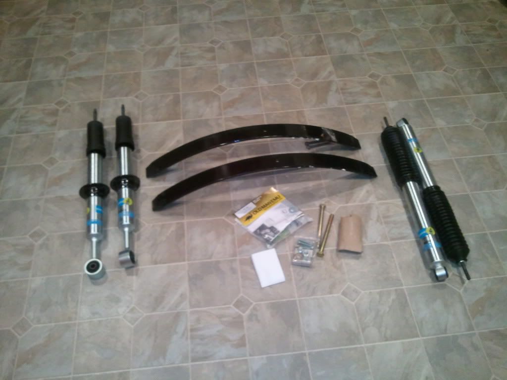

ups guy delivered some goodies
project lift tomorrow in my garage.
5100's, toytec aal, cb drop, and front diff drop.
I will post more pics tomorrow

The spring perches are upside down in the pic you posted.

Quote:
Yep I know. I threw them on there really quick to take the pic. They are right side up now and the snap ring has been moved.

Quote:
Cool, just didn't want you to install them that way by accident!
