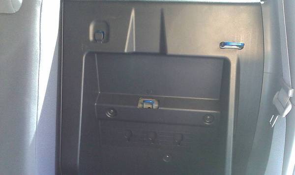

How do you remove the plastic storage compartment behind the drivers side back seat(double cab)? I took out the 3 bolts but its still in there pretty solid. There must be some sort of clips or something, I just don"t want to break it by just pulling on it. thx

I just pulled mine out a little bit ago for a sub box. IIRC it was alot easier to take out once the seat back was loose and out of the way. However I do remember I grew some balls and just jerked the damn thing out. The hardest clips were the ones on the inside edge towards the bottom. Taking out the seat back makes it easy. Two bolts and you can do it with a pair of pliers, they're not tight.
