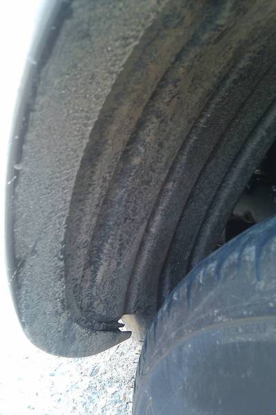

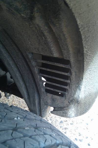

What's the deal with this?
Been enjoying my 2011 DCMT for about a month. Noticed these a couple weeks ago. Passenger front wheel well has little vents cut into engine compartment. Drivers wheel well is just normal smooth plastic. Anyone know if all 2nd gen have this and what its for?

Because the engine air intake pulls air from the passenger side wheel well

My friends and I speculate that, being as the intake draws air from that fender, its to keep a high pressure area in that fender, useing the spinning tire. I dont have the means to actually test this however.

Pretty sure it's just to be for "improved airflow" to the intake, since it's on that side right above the vent.

As Chris said, Due to the spinning of the tire, it creates a "high pressure" channel of air that goes through the vents and gives cooler, cleaner air for the air intake. Also the air come from underneath the bumper.. Only way to really tell how much its doing is to set up an air velocity meter to the fender and calculate how much air is being driven through the vents and actually leading up into the fender.

It is an additional vent for engine intake. The so-called CAI.
However the spinning tire does not create any noticable "high pressure area" in the fender well.
If you look at the the posted picture, you can actually see light through the vents. The inner fender well is open on the lower front for additional air flow. Most intakes draw air from an indirect stream. Yes, you want cool, high pressure air. No, you do not want a direct "ram" air stream. As this can carry a lot of dirt and debris with it. So by allowing the air to flow through and pulling the intake off that stream you get the cooler air without the heavier debris.
