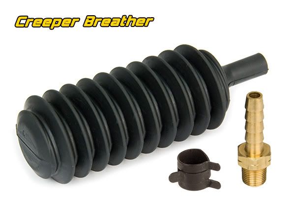

If you do the fuel line, remember to include a good length of service loop so that the suspension can travel without the line being taught.
Like maybe 10 inch coil or slack.
I'd add the clear in-line fuel filter, just to see if any dirt/dust gets trapped. They're like $2 and to me, seem to truly allow it to breath freely.

I made a thread up for the same thing for the FJ's, just make sure to do "ALL" your breathers, front and rear, tranny, transfer case and a E-Locker if you have one. Here is a link of the "How To" I made, it will give you an idea of how I did it using fuel line and a filter.
http://www.fjcruiserforums.com/forum...her-tubes.html
I hope this also helps
