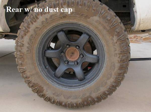

However the rear looked back because it doesn't match; and it's just a rusty cast iron center. So I figured I'd attempt to match

This is what the rear looked like. I know I could have painted it...but still not a perfect match.

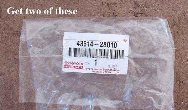

Get two of these...not cheap...but not a high dollar mod by any means.

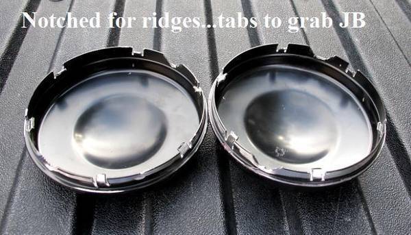

Modified the caps by grinding a gap for the raised portion of the center, and cut tabs to help the JB Weld have something more to hold.

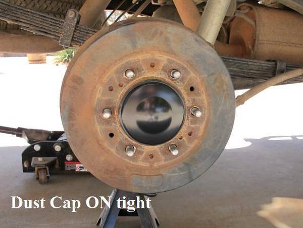

JB Welding the cap on. Might should have used JB Quik. Took forever to cure and I had to tape it on overnight.
Next day...JB Weld is hard. Will wait another day before driving.

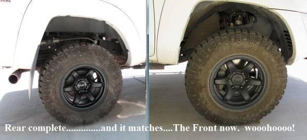

How it looks now. Rear left...front right.
The finished look.

just hope you never have to do rear brakes. I dont think that drum will slide over that cap.

https://www.oemparts123.com/partloca...layCatalogid=0
number 4 is whats needed for this.

Not gonna be a problem.
I checked that before I proceeded. The caps stay w/i the collar of the
center piece. So...while very much a valid concern, it doesn't turn out
to be an issue at all.
