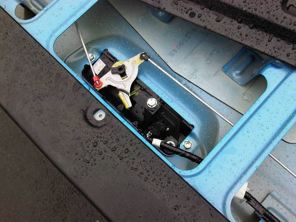

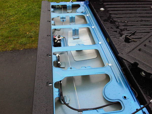

Heres my install that took me all of 10 mins to do, and then another 30 mins getting ready to smash my scanguage because it was a bag of hell trying to get it to adjust right. Heres some pics, and it was raining but I dialed her in anyways!
Got the camera and mirror from "rodrigogudino" and I will say its 100% mint condition and the guy is a pure champ to deal with. Thanks for the gear!
Truck was already wired for it so it was a joke, but heres it is:
PERFECT PACKAGING, KEPT IT MINT
THE BEAST ITSELF
TOP VIEW
CAMERA WITH PROTECTED LENS

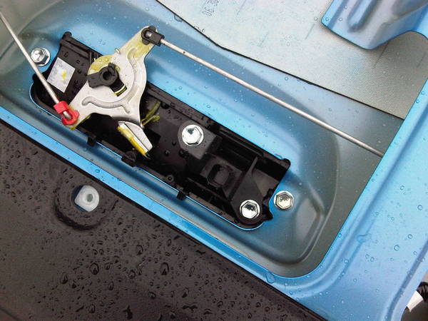

BACK TAKEN OFF AND STOCK PLASTIC COVER
MORE MESSY RAIN
CAMERA INSTALLED AND WIRE PLUGGED IN

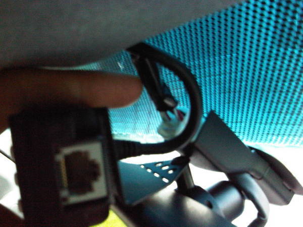

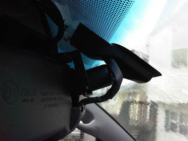

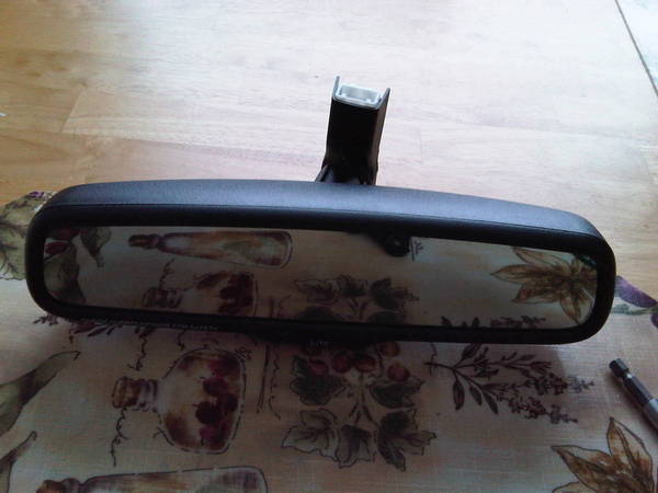

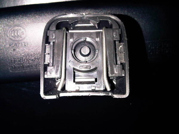

OLD MIRROR. YOU CAN SEE THE METAL CLIPS YOU NEED TO UNDO. A BIT HARD THE FIRST TIME BUT EASY ONCE YOU GET IT
PRE-WIRED CAMERA PLUG JUST PULLED DOWN AND PLUGGED IN

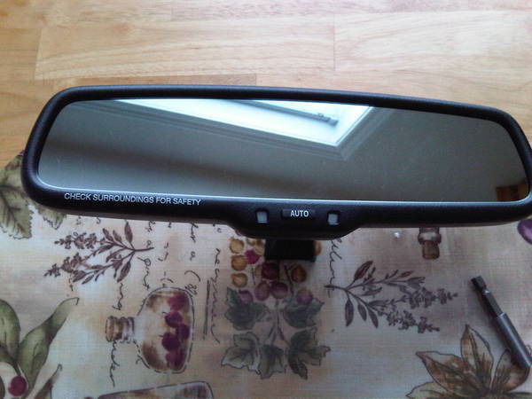

HAD TO TAKE THE PLASTIC COVER OFF TO FIT THE SCANGUAGE. NO BIGGIE THOUGH
FINISHED LOOK
