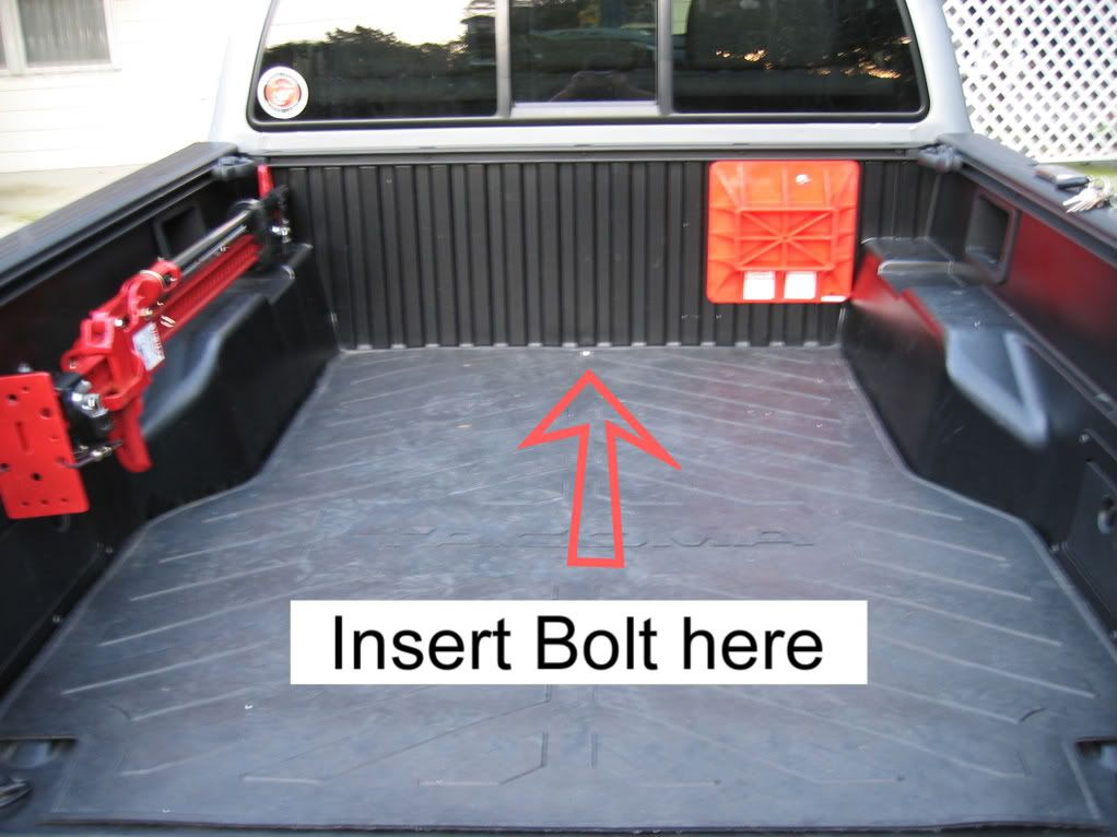

I am not sure if this has been covered before but here is a quick and easy bed mat mod. I was worried about someone possibly stealing my bed mat or it possibly flying out so I drilled a hole in the front of the mat where the factory center drain hole is. I then used stainless steel hardware to bolt it down. Sorry in advance for the poor pics.
What you need:
Wingnut under truck:
Finished top picture:
Ta Da, all done:

Thanks for sharing this good idea. I think I would use a nylock nut down below, as they don't require pressure to stay in place.

That might be a good idea too. I used the wingnut with a rubber washer. The rubber washer adds friction, reduces vibration, and keeps the wingnut in place. It can also be easily removed if you want to take the bed mat out.

You do not have to worry about the bed mats flying out, I have had them in my last three trucks and have never even had one even attempt to fly out.
As far as stealing them there is not much of a way to stop a thief. One good pull and the rubber will tear where the bolt is or someone can just cut out a V where the bolt is.
I don't mean to be negative, just truthful.

They could cut the mat, that's true.... But it's not going to just rip... It's like a tire with belts and threads strengthening it. Have you tried tearing or cutting one? I cut notches in mine for extra D-rings so I know how strong it is.
It would keep the casual thief from walking off with it. But someone serious would cut it, or take a gander underneath to see what the bolt was. Then see the wing nut, and off it would come.

Yeah, it is really hard to stop the determined theif, I don't argue that fact. But it would stop/deter the common theif looking for a quick grab and go. I think (hope) most people would see that it is bolted down and look else where.

Did you have to drill a hole in the bed? On my '09 the center drain hole looks quite small?
