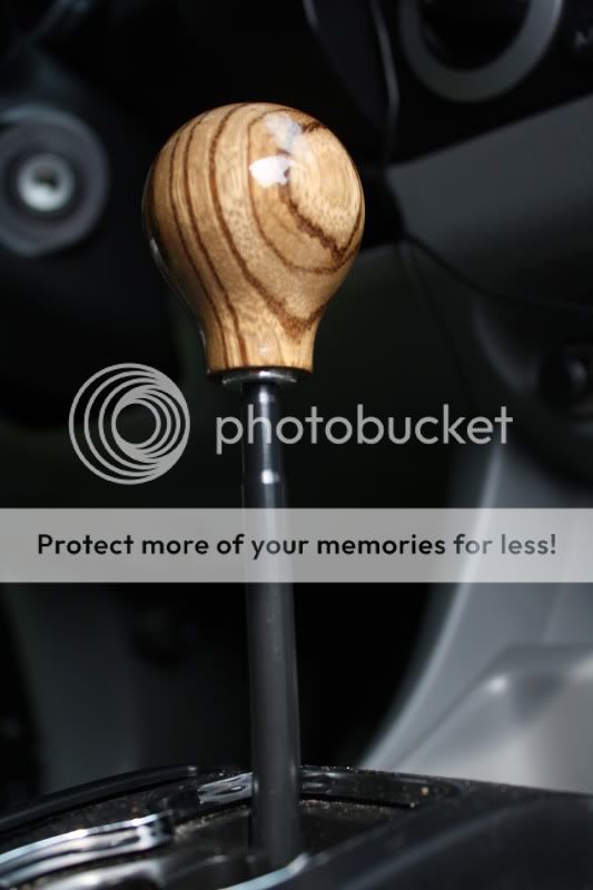

2nd Gen. Auto Shifter Mod
Get a new shifter knob you like. Make sure the knob is threaded 8mm x 1.25 internal threads. Need what I think was a sleeve of 7/16" electrical heatshrink. Remove old knob. Fit new knob and measure length of heat shrink needed. Remove knob. Cut heatshrink to length and install over shifter and install new knob.
Heat the heatshrink with heatgun or carefully with lighter. Done.
Can always cut-off later if needed.
The new knob sits alittle higher and makes for positive shifts and you can actually see what gear you are putting it in. Enjoy!

No it just covers up the chrome on the original shifter and mine had tooling marks and a sharp step down machined on it. If your remove your knob, you will see what I'm talking about. Some might like the blacked-out look. Just an idea and I liked it. Thought I would share.

Yes I was in a hurry. Guess I should have called it a chrome cover-up. Or fix my crappy machined and shitty chromed shifter. Having a ball type knob really seems to work good, positve shifting, no slapping around trying to get it in the right gear.
Maybe I'm just getting old and lazy.

Thanks Cortland. It's Tiger wood. Found it on eBay and thought it was kinda cool.
Something different and cheap enough.
