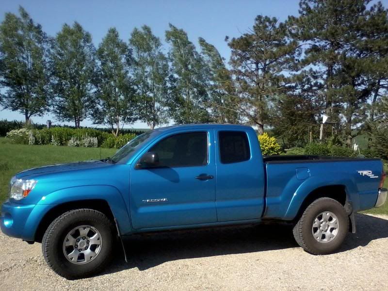

Hey guys. I have hardly ever used my truck to pull ANYthing, but I have been thinking about getting a travel trailer. My truck is a 2008 4X4 TRD with a 6-speed manual tranny and no optional tow package.
Here's the truck:
Here's the trailer: http://www.webstercityrv.com/index.c...spRV&RVID=5978
How would I do???
