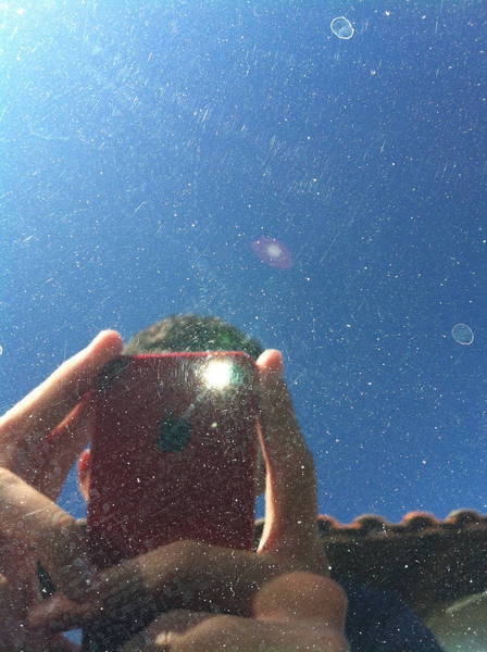

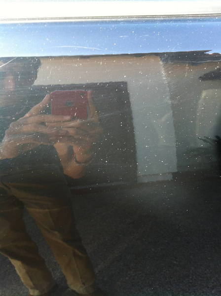

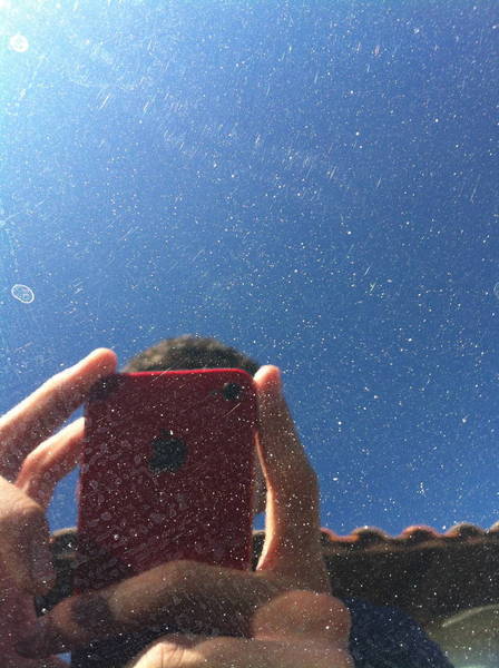

Okay so the other day I was washing my taco and as I was drying it off i realized their was a lot of white spots everywhere and i tried rubbing as hard as I could with a microfiber cloth and nothing happened. My mom came out and she was puzzled as to what I was doing as she came closer she told me I had drove into someone painting something and white paint was on my truck. She has no clue as to how to get it off and Im not going to tell my dad because he's going to flip shit. If anyone has any idea how to get these white paint dots off my truck I would be greatly appreciate!

Um would goo gone work? Just a suggestion, cause that stuff takes a lot off. But whatever you use to get it off make sure you put a nice coat of wax there after. Good luck

I would use a razor blade to scrape the glass and the very fine rubbing compound on the body. Let us know how it goes.

I'm thinking some detailing clay and a good polish, but check out the detailing area. I'm sure you aren't the first to get junk on your truck.

clay bar should take care of that.

^^^what they're saying. use a clay bar.
If that doesnt work (idk why, didn't work for me. Clay bars hate me) then VVV
I had tiny dots of paint on my truck from being parked too close to where we were painting (my house) with rollers.
I CAREFULLY used a boxcutter replacement razor to get it off. Similar to using a razor on glass, it should peel the dried paint off

clay bar. may take some time. i still have get to get the red paint off mine...

i have seen that on cars, if the clay bar dont work, go to a professional detailer, i bet you they will get it out no problem

Magic eraser, works wonders

Are you sure its not your clear coat? that happened to a dodge truck I had, clear coat bubbles.

just try the clay bar. if that doesnt work either polish it yourself or take it somewhere to get polished.
clearcoat looks like it could use some love anyway ahah

Something very similiar happened to me once. Some workers were painting the lines on the road and some oversprayed or wind blown all over my car. I was seriouslly pissed when it happened. I had yellow spots all over my black car. Surprisingly a few months later most of the paint came off on its own.

Lighter fluid. Pretty much melts tar off of paint. Works like a charm. Like grill/campfire lighter fluid. No lie, I have done it to my motorcycle and my truck.
