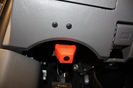

your going to need something program that key into your taco, right? We need to pick up a programmer that can add the new transponder key into the ECU. This will work with the Taco and many other Toyota models.
Visit ebay and search "toyota smart keymaker". you want to purchase "Toyota & LExus OBD2 Smart Key Maker Programmer" I purchased mine from edward-hz2001 and was able to submit an offer to bring the price down to 17.50! It took 10 business days to be delivered to my front door.

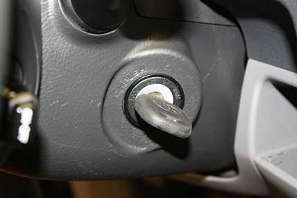

Programming Step 2: Insert Original Key (the one your currently using to get around) and turn to the on position
Programming Step 3: Insert SmarKeymaker into OBD Port
Programming Step 4: wait for first beep. (1-15 seconds)

Programming Step 7: Remove original key and reinsert, DO NOT TURN, wait 5 seconds and remove.
THEN insert the new key, DO NOT TURN, wait 5 seconds and remove.
Programming Step 8: Insert original key and turn to ignition ON Position and Lock position 5 times quickly. Remove Key.

Programming Step 10: Remove SmartKeymaker
