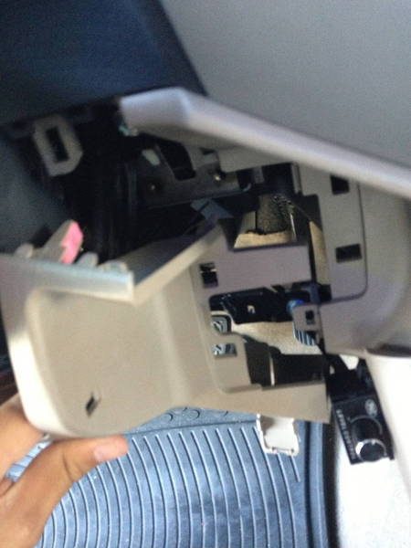

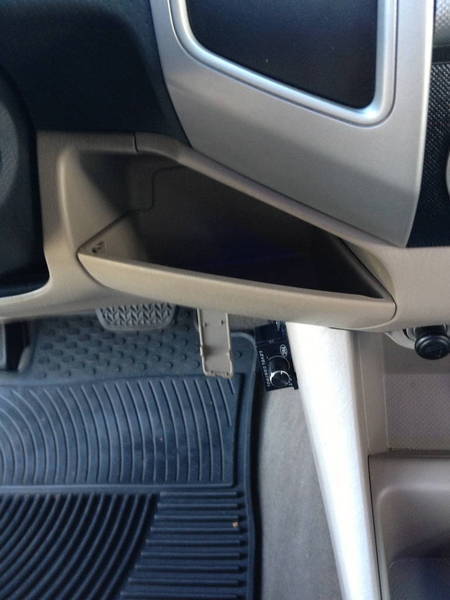

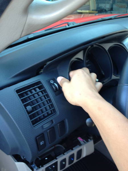

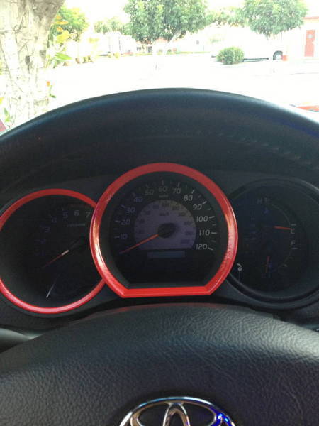

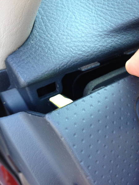

    Unscrew 10mm bolt by gas pedal
    Take out change container
    Take out lower plastic and stop once you hear its out.
    Remove 2 screws in upper plastic, I didn't take pics, but they are just above the steering wheel.
    Pop out rings with a flat head screw driver, don't snap the rings!
    Finished product

    I don't think you have to remove lower? You can just pull rings off. at least I can?

    I have 06, I didn't want to scuff things up, wanted to do a write up since nobody has done one about this yet! Thanks though!

    I like it too, especially in red. Good job.
    Got any wider angle pics of the whole thing re-assembled?
