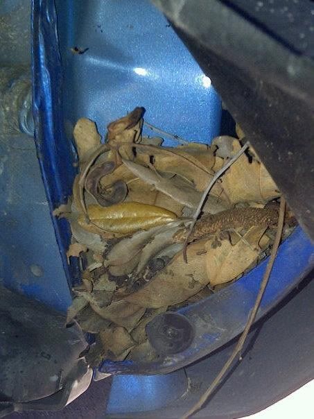

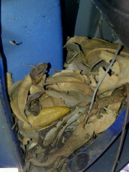

Was doing a build and noticed a bunch of leaves hidden behind the lower front fender liner..between the fender and body...potential rust trap. If you park near trees you should check this area out!!!!

Add a pic from farther out to better identify the spot ?

When you open the front doors on the second gens, its right by the door hinges on the body..its been discussed on here before.

Yup... been a few threads on it, but it always bears reposting.
In front of the doors, there's a black plastic flap.
Lift the flap and you'll find the crap that's fallen down there.
You can also access it from behind the mudflaps (or black boxes).
Adding some mesh under the cowling will help prevent this.

There really is no fix..just have to clean it out every so often..or like rich said, use some mesh..it will help.

If you trim flares and liner it opens this area, makes it much easier to clean.

Found this spot on my '13 yesterday because the door was hitting the rubber gasket/cover to this hidden area. Full o' leafage! Good spot to hide "stuff" from cops if that's what your into!

Keeping that area clean eliminates the mulchy smell inside the cab when the leaf debris warms up after it rains.

I had an ant infestation that I couldn't find the source of until I looked in these spots. Cleaned them out and sprayed some killer in there and good bye ants. They fill up rather fast.
