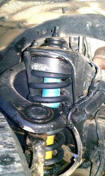

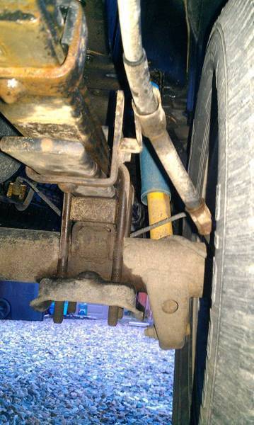

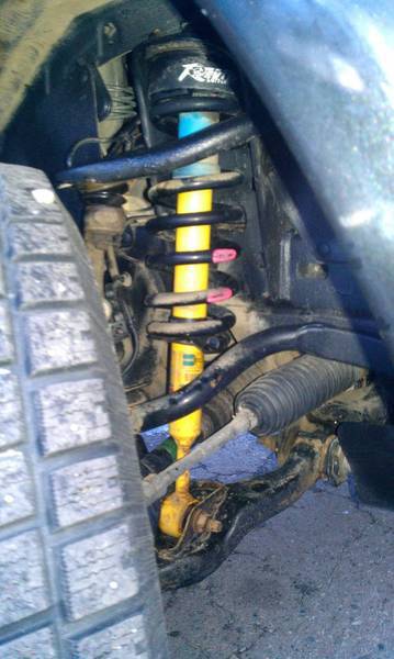

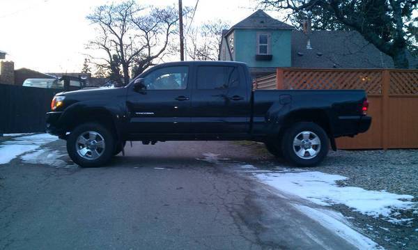

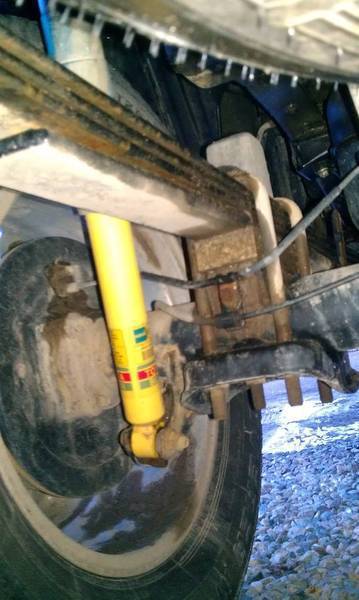

    so i recently bought my 'new to me" 07 sr5 taco a few months ago.. when installing my winter tires on stock rims i noticed it appears to sit a little higher than most other tacos. I have taken a few pics this evening to get a little more insight on this revtek lift or leveling kit with the hope of someone out there able to identify what it is

    You got a spacer kit. If you like it, don't do much off roading, and don't mind the rough ride, then keep it. Other than that, your truck looks good.

    It appears that you have a spacer lift and that is basicicaly the shittiest and cheapest way to lift the truck, all it does is compress the spring by putting the spacer on the top.
    Edit: as he said ^ not good for offroad and stiffens the front up a bit.

    If you aren't planning on hitting the trails and maxing out your suspension, be happy and enjoy the little extra lift. I had a spacer kit on my '04 and besides the rougher ride, I enjoyed the added clearance and good looks. Truck looks good.

    I have a 3inch spacer lift and mine does just fine off road. I tare it up and I haven't had the first problem.

    OP, if you push the vehicle hard offroad, you will snap the shock. This is because the spacer is forcing the shock to bottom out before the LCA hits the bumpstop. The shock will lose given a hard enough hit.

    The 3" spacer being the destroyer of stock shocks is correct.
