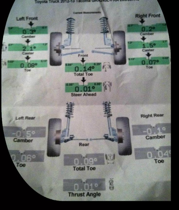

Are my numbers ideal? I have a 2.25 spacer up front and a 1" block in the rear. Truck drives smooth and straight, I just want to know what I can do to improve the numbers or if they are acceptable. Thanks in advance!!

I would think it has a small tendency to pull right. The right side caster should be able to lay back a little bit more, to make it closer to the left. Otherwise it looks pretty good for having spacers in there. If you want it perfect uca will be needed. If you can stand the way it drives though then you are good.
I agree

that was quick, thanks man! It drives straight as an arrow

good to know. I appreciate the feedback. Looking forward to learning a lot here.....I know, I know, spacer and block lift sucks. I plan on getting a full OME suspension as soon as I can
