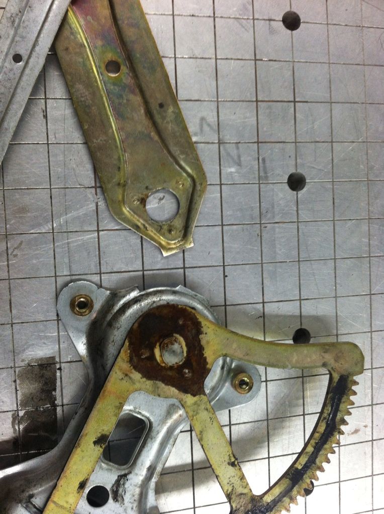

so i went to put the window up yesterday and heard a snap/crack noise followed by no window movement. Window motor still works and all that, the scissor arm just broke off where it connects to the motor. I cant find anything on the bottom of the door if a piece fell off. Seems like it would need some type of snap ring or even stronger to hold it where it has to be.
Heres what im working with:
End of scissor arm that should be connected to motor
Where the scissor arm should be connected to over that raised metal oval
I see on both ends of the problems those three little circles in a triangular shape around the oval, is that anything? Also the male end being an oval shape and the female end being a perfect circle. Any info would be great.

Looks like something that was spot welded? If you know someone with a spot welder just respot weld it. Most likely you don't so if you do know someone with a mig/tig welder drill a hole where the spots are on the side that had the metal ripped out or thinner side and then use those holes to reweld it. other than that get a new part?

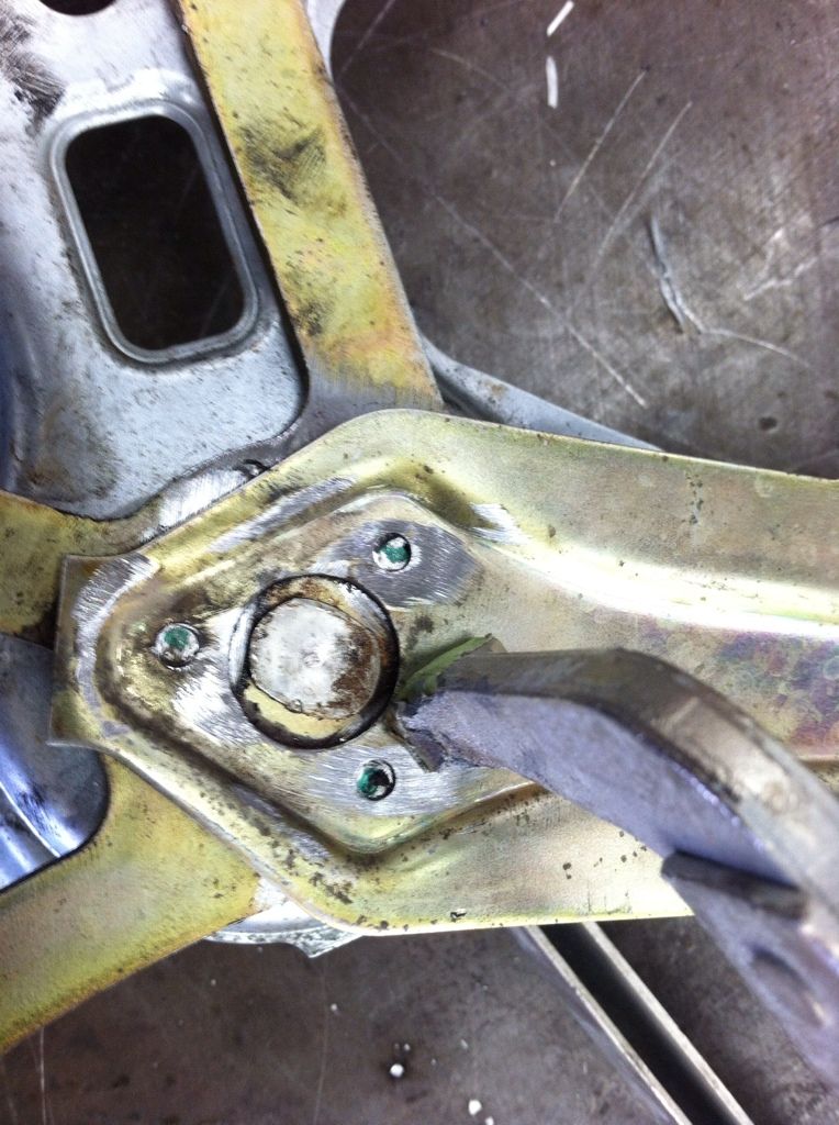

Thanks for all the info. Went to the dealer saturday and they wanted $113 for the entire track system because thats the only way to buy what I needed. So after work today, took apart and was able to fix it pretty easily within an hour and a half. Pretty surprised how small the factory welds were to hold it together.
So in case anyone else has this problem, here's what i did
cleaned up the steel and marked where the factory spots were
lined them up and clamped together
welded the holes, filling with mig or tig is the better way to go than a spot weld. I could of probably welded in the center around the oval, but i was a little hesitant just incase something went wrong it would of been a bitch to grind and seperate.
put it back in and worked like a charm. heres what the dealer wanted to sell me for that problem
