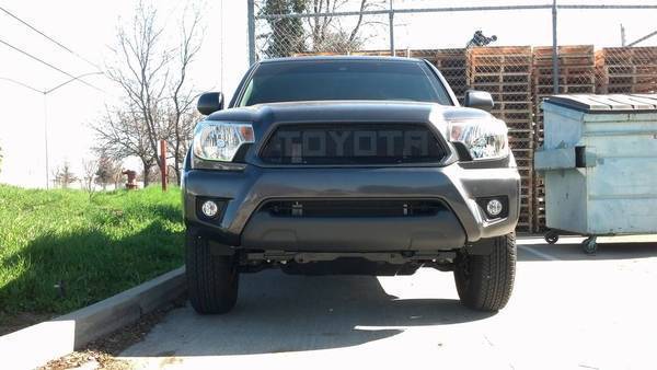

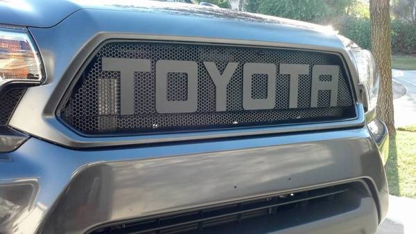

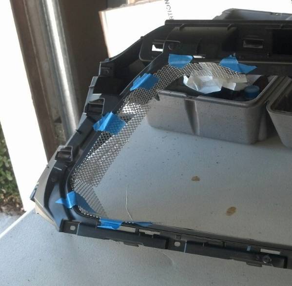

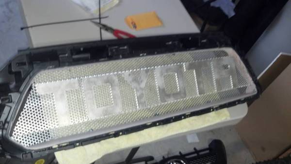

Just finished my Satoshi Raptor style grill, thot i would show you guys and if anyone is looking to build one and has a 2012 or 2013 you can ask me questions. took a lot of work but here it is! what do you guys think?

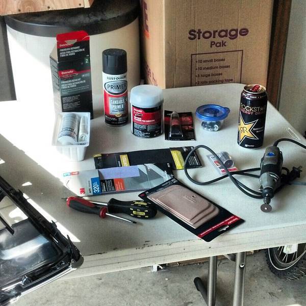

The set up

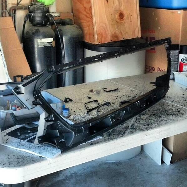

after cutting inside out with dremel
mesh to form the fiberglass to

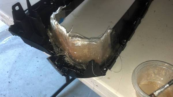

fiberglass

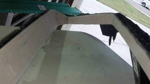

bondo done
all done before paint

Toyota signs huge!!!! Looks good.

Looks good

Looks Nice!!Can you share some details on the mesh....what vendor and any reccomendations you may have.Thanks.

Nice job almost looks like a hologram lol but I like it!

I work at a sheet metal place in Tracy Ca. so my shop is the vendor but it is aluminum .160 thick round mesh 70% open. I chose this one becuase i figured it would have the best air flow.. and easiest to bend etc.

yeah thats becuase it is large percent open Mesh so you can really see through it in pictures.. doesnt look like that in person lol

that looks good! I would love to do this to my 13 but scared to rip apart my grill just yet. Where did you get the lettering?
