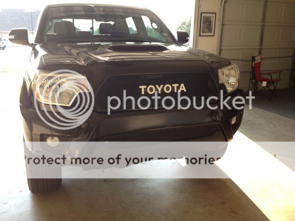

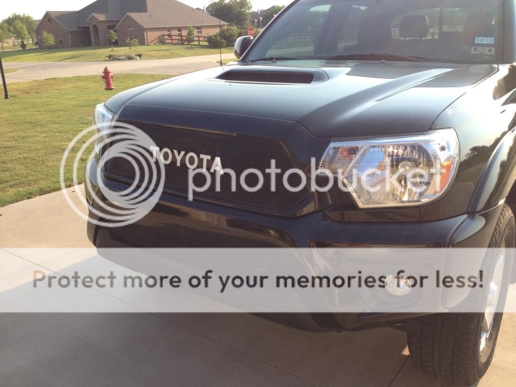

I completed my Grillecraft MX Series upper and lower grill kit install yesterday. Here's a couple pics.

Awesome job....it looks great!
One question: Did you have to do much bondo work or just cut and install?

You don't need any bondo work. Just cut out the middle part, drill 6 3/16th holes and you're done!

Yup.
I purchased a 2012 grille and grille surround from a TW member that was already cut in preparation for a Satoshi job that never got finished.
Made the job real easy and I still have my original grille to use for whatever.
I like it better than I thought I would. And as a bonus, there seems to be a definite lack of any modded grilles in my area, so it's pretty rare.
The only problem is every time I improve the exterior, the stock wheels look worse and worse.......

Great looking work! The TOYOTA symbol turned out great. Tried to color match mine to the truck and it was an epic fail. How did you secure it to the grille?
I cut off all the tabs on the back with a dremel and used 3M Plastic Emblem and Trim Adhesive.
I used blue masking tape to tape off exactly where the emblem should be positioned and then loaded the back side of the emblem up with adhesive and taped over it and let it set for a couple hours.
Seems to be on there pretty good.
