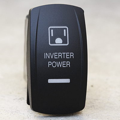

the switch panel i ordered has built in breakers so i wont be needing an inline fuse for the switch...going to install it on the overhead console. here's a pic of it, includes the switches in the pic. made in china so going out on a limb as far as quality goes...so we'll see
