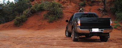

Here's the scoop with our "Bumper Swap." Edrin55 / 09 Tacoma Access Cab w/ no hitch. This truck is not a PreRunner. Before Picture ![]() Rpparkster / 09 Tacoma 4x4 Double Cab Before Picture Before you start, unplug the lights from both sides of the license plate. They should turn down and pull out. ![]() Tools needed. Plus a flat head screw driver. ![]() 3/4 Wrench to hold the nut from moving while using the 3/4 socket on the top. This is in the middle of the bumper above the hitch. ![]() Use the flathead screw driver to pop up those little squares on the cover and then use the screw driver to pop-up those little inserts. Lift the center round section of that pop-in thing to pop it out. In addition to that, there are two more small bolts under the cover (underneath). You'll need a 10mm socket to remove those two. ![]() 11/16 socket for the remaining 4 bolts (2 on each side). There are a lot of bolts under there. Remove the two closest to the bumper. If yours are the same as these, they will be black in color while the other ones are in silver. Remember, this is from the Double Cab with a hitch. ![]() Here is a picture of the access cab. The brackets holding the rear bumper are different. However, the pattern (the two bolts being removed on each side) is the same. Remove the two closest to the bumper. Notice these are not black like the others. ![]() Once the bolts are removed, it will take at least two people to remove the bumper away from the truck EVENLY. Once it's off, you'll need the support of your friends to push in the bumper back in place. It's a little tough. Use gloves and a rubber mallet if you have it handy. If not, it's ok. Just be careful to not hit the truck as you're putting it back in. Edrin55's new look! ![]() Rpparkster's new look! ![]() Another successful mod. Thanks for looking.
