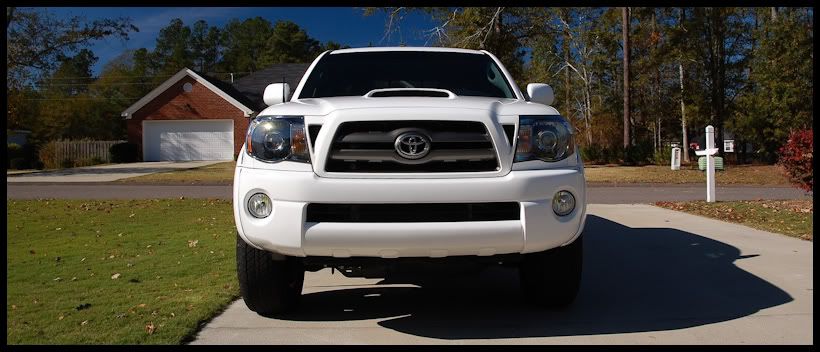

Here is my HID Retro in my 09 Taco Sport that I completed over the holiday week. Setup includes the following: FX-R Bi-Xenon projectors with clear lenses, Gatling shrouds, Matsushita Gen 3 Ballasts, 4300k D2S bulbs, and stock housings. To complete the retro without taking my truck completely out of service, I sourced two OEM headlamps on eBay and performed the modification to the spares. Once the hard work was done, I pulled the stock headlamp, opened them up, and swapped the reflectors.This was my first retro that required modifying the stock reflectors. It was a bit hair raising at first, but it wasn't all that bad. The biggest challenge came when trying to obtain the correct alignment. There was a lot of off and on with the projectors.
Let me know if you have any questions, I would be glad to help.
Stock headlamp out of the truck getting ready to bake.
Remove screws and plastic pieces
Stock reflectors cut/drilled and ready for mounting the projectors
Projector test fitting
Awesome clarity on these lenses
Projectors fitted, aimed, and ready for epoxy
Gatling Shrouds
Gatling Shrouds trimmed to fit the FX-Rs
Shrouds ready for epoxy (I didn't end up using the epoxy pictured, I used 3M Scotch Weld)
Headlights finished ready for mounting
Relay Mounted inside of fender
Headlamps fitted with Matsushita Gen 3 Ballasts and mounting brackets
Truck looking MEAN!!
Wall shot
Road Shot
Flicker
RETRO COMPLETE!

Nice work! I would love to have that light output.
Where did you get all the parts?
EDIT: Can you use high beams or is it low beam only?

I got the parts from The Retrofit Source. I probably could have searched around and bought the parts cheaper, but having once source for the parts is very nice.
And YES it is xenon high beams as well. I tried to get a picture, but there was a damn car coming down the road every two seconds. I'll try to get a high beam shot tonight.

B E A utiful job man!! proof that a retro can be done over a weekend w/ minimal tools!! to all you naysayers that say retros are expensive and you would rather do your egay aftermarket H7 projectors...this is proof that a retro can be done fast and easy!!

quick question, how exactly does the boot seal off here? did you cut it al all? did you just stretch the piece to fit over the ballast connector?
looking to complete my back like this and would appreciate a little help, thanks!
