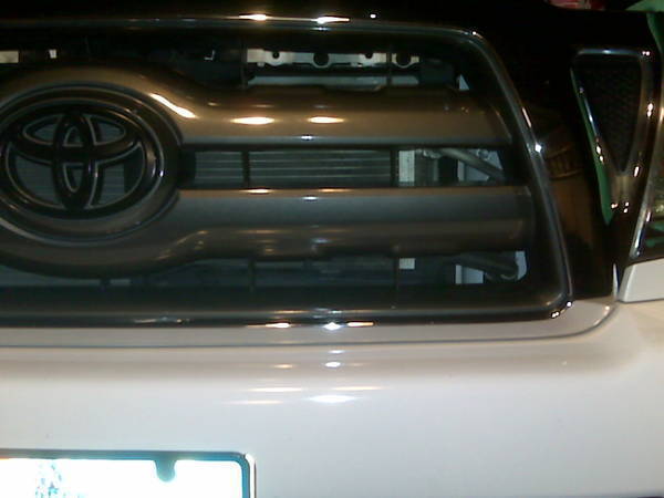

Ok so i was just relocating my horns and when i was done i stood back and took a look. hmmmm... the trans. cooler is conveniently located in the only place where it doesn't get fresh air. so i took the grill off again to see what i could do about it. the trans lines are to short to turn it in any other location, so i got to looking and think that if i get some bulk line i can relocate it on the aluminum bumper just inside the lower grill. im also gonna need to make new brackets.
the first thing that comes to mind when i saw this "mistake" was that Toyota intentionally did this to shorting the trans life. Has anyone relocated there trans cooler or have an opinion on why it is where it is.

I relocated mine for that same reason. Made some brackets and extended the lines. Sits right behind the lower grill to the left. Fresh air

It's its stock location, almost the entire cooler is hidden behind solid plastic.
There is virtually zero air flow over it. Now logic would suggest moving that so that air does flow over it would increase its efficiency.
I dont have stats to back that up, but then again I havent seen anyone here prove me wrong either.

^ hidden behind plastic...virtually zero airflow... really...how much room is between this plastic and the front of the cooler?! you forget that air doesnt always go straight...it travels around things...
i wish i had one of those handheld wind measuring devices to prove you wrong...anyone out there have one that they can mount to the front of the trans cooler?

Im with you. I mean ask youself. whats the number one killer of trans? HEAT. this is like a 30min mod that you may or may not need. but why not?
i had a 94 explorer and i was driving back from houston to dallas and the trans started to over heat and blow trans fluid out the vent hose. so i went to autozone bought a trans cooler for an RV, installed it and never had the prob again.
i think im gonna do the same for my taco.

This is correct ^^^^^
If the grill affected it that much, there would be a much smaller grill on the truck.

its also a larger coooler than OEM. And yes, With the front grill and such removed, it will get sligtly more air flow.
Look at it this way.....All the people that put a bank of lights in front of their radiator, If it was adversely affecting the flow that much, their trucks would be overheating. They are not, because it doesnt.
