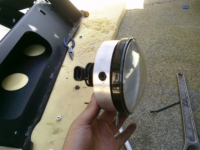

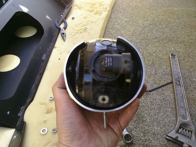

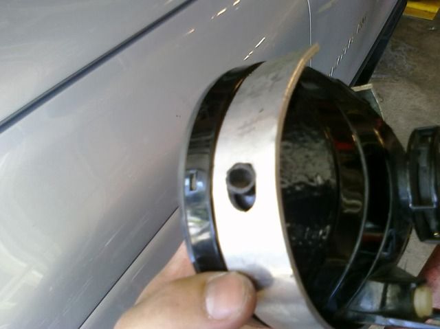

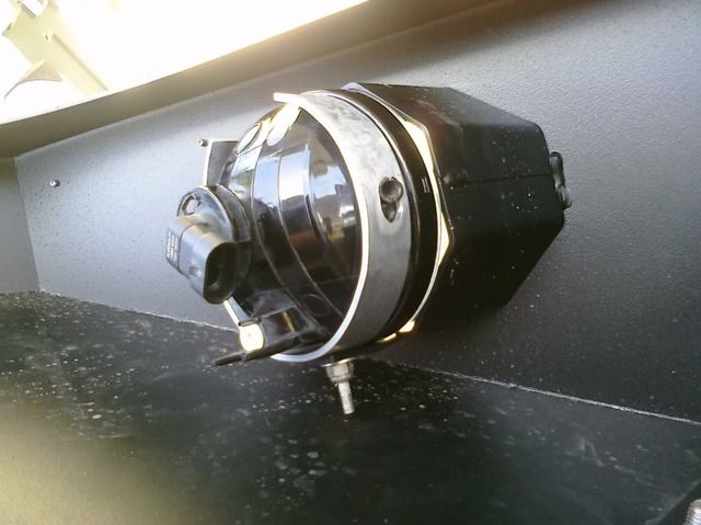

Got the idea from Krookz, but I figure I'd post my pics.
I spent $6 at the local steel shop and bent the steel to shape around the fog light. The stock fogs have tabs on the side, so I drilled holes on the sides (took a little trial and error). The another hole where it mounts to the bumper.

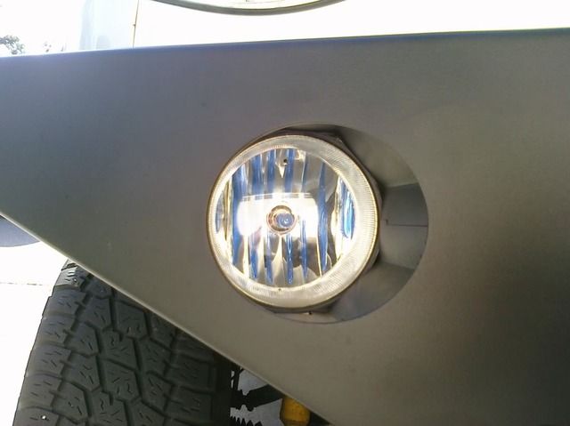

Thanks for posting up your mod mjonags32.
Question for you, how well do they spread light now that they are recessed so far into the bumper? Got any pics of them on at night?

fogs only
I don't really know how to compare them to my headlights because my fogs are just regular bulbs, whereas my headlights have been converted to HID.
They light up just ok, but if I need more light, I just use my Hella 700ff lights (HID converted also).
