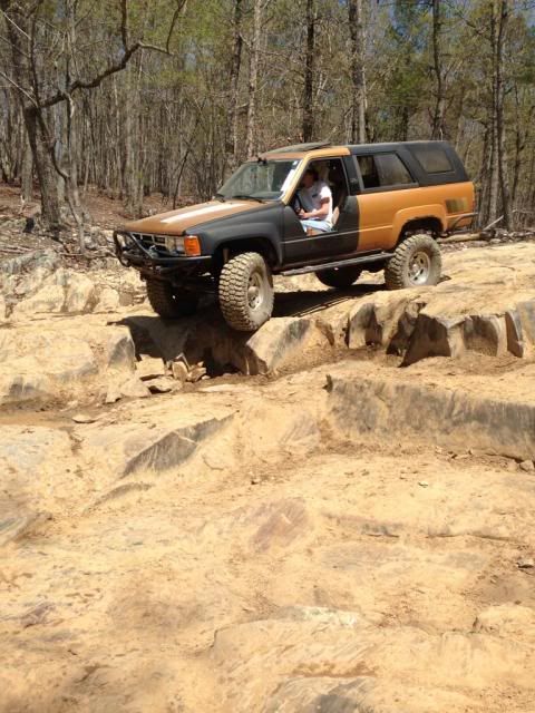

3/2/14
I went wheeling some some local guys in Whittier. It was fun and it got pretty off camber in a few spots as you can see in this picture.
