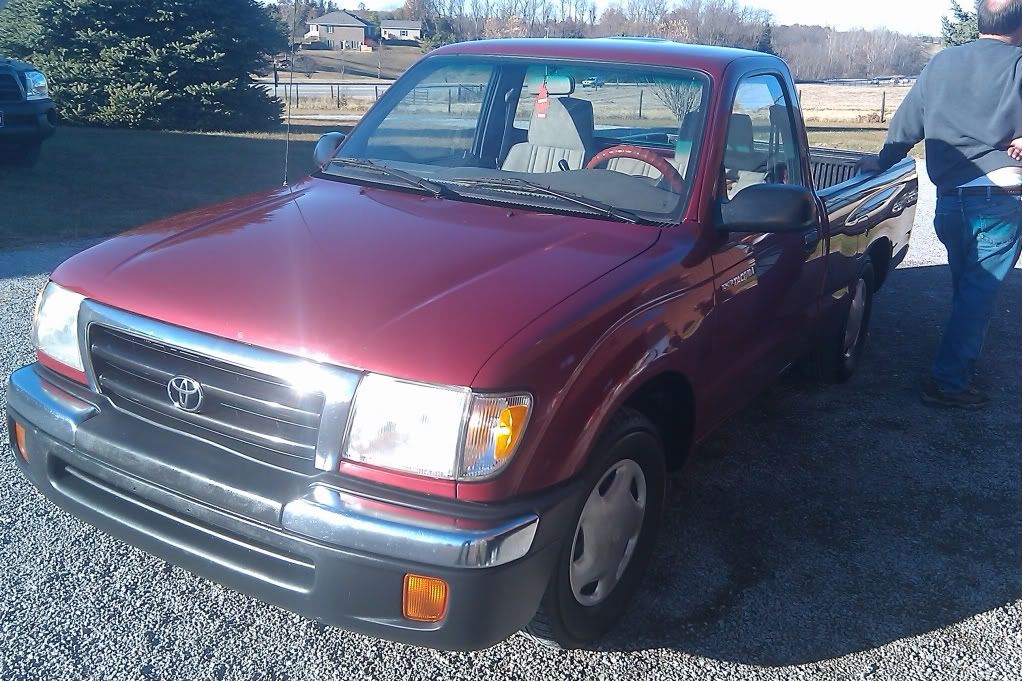

Here's my 5 lug, help please?
If I pop the hubcaps off what will be under them? I don't know what all I can do to it without killing the mpg as far as gas goes... I don't want to pour money into it, but 300 or so for a lift is doable...
EDIT: Things i already have covered:
seat covers
new HU
tinted windows
Thanks, Chris.

well...I would def do some rims, and some low profile tires. I would think about a lowering kit maybe. Tit the windows, and put a good system in. Keep checking craigslist or here for some rims.

It's a truck though... I want to be able to take this as offroad as it will go. I will look into it though..

Dont run spacers or heavier coils go with Spindles.
When you run spacers your changing the geometry on the arms and the 1st gen 5 lugs have a weak point officially known as "lower control arm 3", most know it as the Lower BJ Bracket. When you lift these trucks via coil they break. Even the larger tires will add strain to this weak part.
Your best option is spindles. They are fairly cheap and will keep the factory ride/ suspension geometry.
Ive been through 3 sets of suspension (broke them) on my 99 5-lug before finally just skipping all the BS and going Long Travel. Obviously this isnt the best option for most however it eliminates the most weak parts in our suspension.

Thanks guys. Right now, im leaving the wheels stock, im taking the hubcaps off and painting the wheels..
