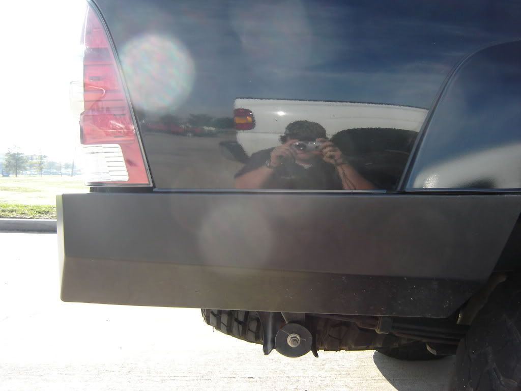

Armortech High Clearance on my 09
Looking through the threads, I saw a mag grey, speedway blue and super white examples of the Armortech High clearance rear bumpers on the 05+'s.
I thought I would throw Black Sand 09 into the mix. Never mind the bald rear tires. New ones are on the way.
If you want top notch quality and great customer service; get with Kevin and he will hook you up!

Are you going to move the spare to make the high clearance part work? haha jk looks good man

Its just under there for DD use
There is not much room in a DC with a short bed and a tool box.
I can only fit a 48qt icechest, my spare, and my toolbox in my bed at one time.
Thanks for noticing though.

That is an excellent looking trim job on the bed. How'd you do it?

Kevin fron Armortech sent some instructions and pics on the cut job.
Basically I removed the OEM bumper.
I taped off an 8 in area of the lower quarter panel.
I made a prelim cut about 2 in below the final cut area
Then I used some 2x4's as spacers to space the bumper down from the first cut.
I measured up the width of the 2x4 and made my final cut line and proceeded with the cut.
These are kinda generic but you should get the idea.
I used a pnuematic cut off tool for all the cuts. It took about 4 hrs to do. It should have taken about 2 hrs if I had a decent air compressor.
