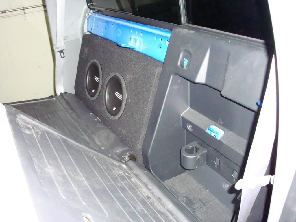

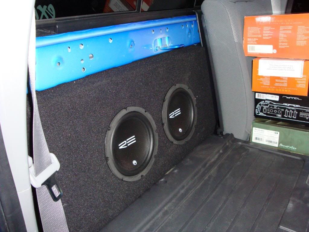

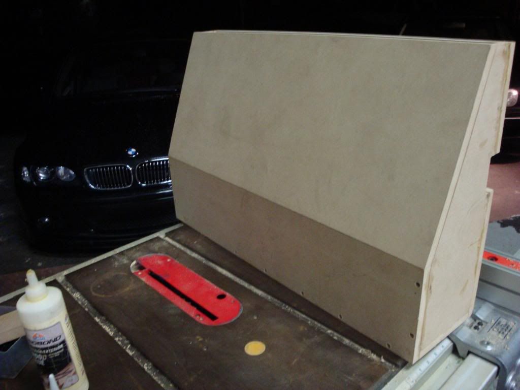

dual 8 inch ported double cab enclosure
Hey guys just wanted to share this enclosure that I've been bulding for customers here in Hawaii. This guys holds either 2 8 inch subs or one 10 ported with 1.25 cubic feet of air space. It fits perfect on the passenger side in place of the plastic storage compartment and you can still keep the drivers side plastic in place and it contours to match it. Don't mind the pics these are pics of the first one i did a few years back right after I finishes it and haven't taken any new ones since

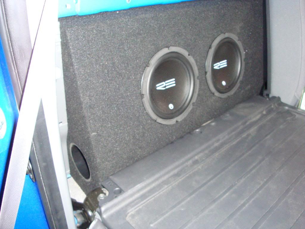

Nice with the side firing port. I bet it bangs. 4" port right? What's it tuned to?

Thats a nice box! Looks like it fits really well. What is the max mounting depth? I'm interested...

Yup 4 inch abs port. I was thinking abut using a 4 inch aero port flushing in the flange but I haven't tried one yet. As far as output it gets surprisingly loud for 2 8 inch woofers. So far the best combo I've used were JL 8W3's off a JL HD900/5. It was flexing the roof enough to make noise. The side fire port loads nice right there and it still gives enough clearance to let it breathe nicely. Tuning on that particular box was around 35 but I can go anywhere from 30 and up just depending on woofers. The other nice thing about it is the woofers load on the back of the seat which in turn gets a little more solid low end and better power handling.

The max depth I an get out of it would be 5 inches maybe even up to 6 but I haven't tried going that crazy yet. If you are interested let me know what woofers you are thinking about running and I can probably get ahold of it and see how it fits or build it to fit the woofers.

35 is kinda high but 30 is about right for most woofers. I like to tune a bit lower to get flatter response but that's just me.

I totally agree, the reason that particular enclosure was tuned at 35 was due to the customers request. I personally try to tune in the area of 32-30hz, my personal car has my sub tuned down to 27. I am a firm believer in having your midbass woofers produce most of your upper to lower midbass and have your woofer pick up the lower frequencies that your midbass woofers can't produce. That way you not only get a good blend between your midbass and subwoofers but you also get a very forward sub stage. Done right you can make your sub disappear from behind you and you won't even know its there
