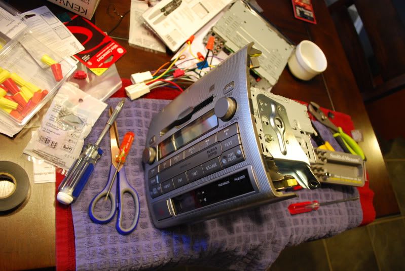

I recently picked up a Kenwood media receiver, stereo adapter, iPod cable and Sound Ordnance B8PT little 8Ē powered sub. I havenít installed a stereo in about 10 years, and Iíve never installed a sub before. I have to tell you, the whole project was really rewarding but much more involved than I first realized. Between taking my time, watching the Tigers game and recovering from the Cardinals World Series win the night before, it took me about 8 hours! I took a few pictures along the way.
I started with the harness. Crutchfield orders come with faceplates and convenient harnesses that let you pre-wire your connections. I couldnít imagine trying to make all these connections by cutting the truckís harness and working behind the stereo in the cab to make all these connections!
Pulling the old stereo out was simple. Hereís a tip: the little blank panel to the right of the stereo (opposite of the 4WD switch on the left) will pop out easily. Then you can reach a long finger in there and push out the AC controls from the back. After that, you just disconnect the factory harnesses and unbolt the four 10mm bolts. Then the stereo just pulls up and out, and the factory harnesses are easily disconnected.
The only hard part is getting the dang hazard/clock panel out. You really have to take the factory faceplate off to get to it.
The Axxess ASWC adapter was a punk to wire up. Power and ground were easy, but I had to search tacomaworld to figure out the right two other wires to hook up. Plus, with Kenwoods you canít just plug in the 3.5mmjack. I had to plug that into an adapter and then wire the adapter to the steering wheel control wire on the back of the receiver. Things are never as easy as they could be.

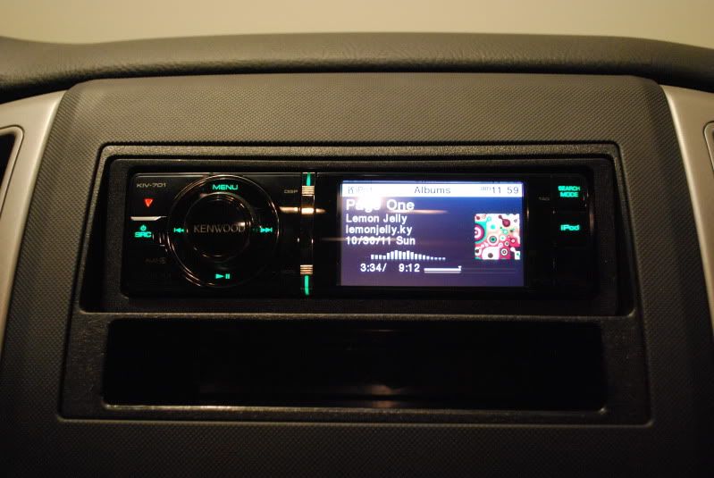

I went with the black faceplate kit, and I like it as well. Nice texture and the fit is good. Looks pretty factory, apart from the obvious single din cubbyhole.
Closeup of the receiver:
And at night:

Great job, very clean! Which Ipod do you have. One problem I have with your work is those wire nuts..

I definitely understand about the nuts. I bought a soldering iron but when I twisted the wires together with the nuts I couldn't really yank them apart, so I went with the nuts. I tried to crank them all down well and get a few "spins" of each wire together under the nut to make them extra secure. Hopefully they all hold.

Good choice on the black radio bezel vs the silver like the stock radio - much better look!

Thanks, I think so too.
